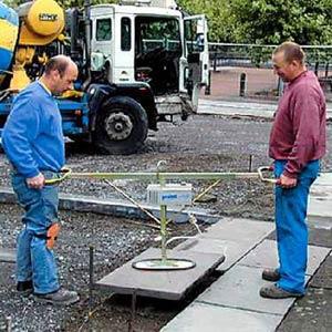

The only thing with the 3x2 slabs is the weight of them, it's about 65kgs each, so a bit of a pig of a job to do on your own.
That sounds a good price though, which is pretty rare for b&q!!
There would be 2 - 3 of us doing the work :) but I am still concerned about it tbh... I will have a think.
Yes I was surprised about the price too
You could always have a 2ft wide path but bring it out from the house wall slightly (to give more room for walking), and fill the gap with gravel. Depends what you like the look of really!
Yes mate. I mentioned in an earlier reply that I have planned in a 150mm gravel border between the house and slabs :)
Ohhhh they look good. Not being in the trade I don't know about these tips :) might try to borrow one!
Slab lifter with 150kg capacity for £40 all day..... Not bad?
