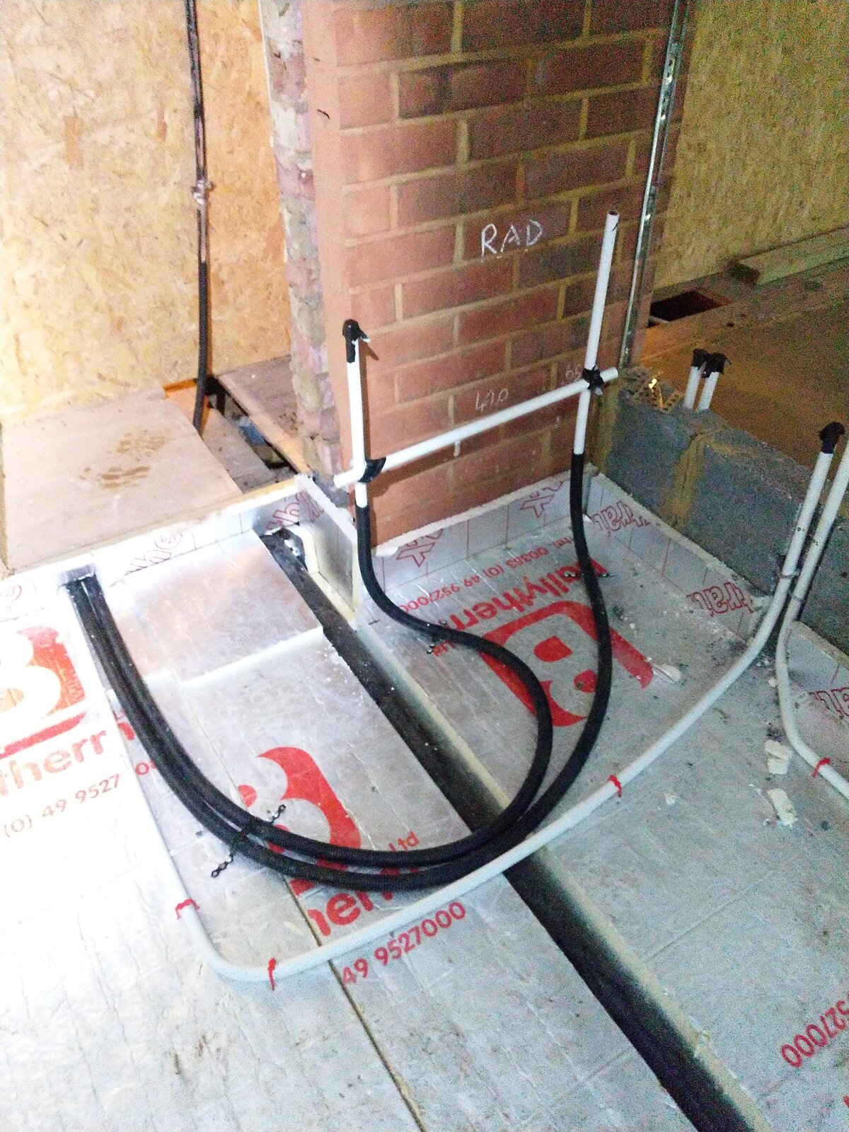

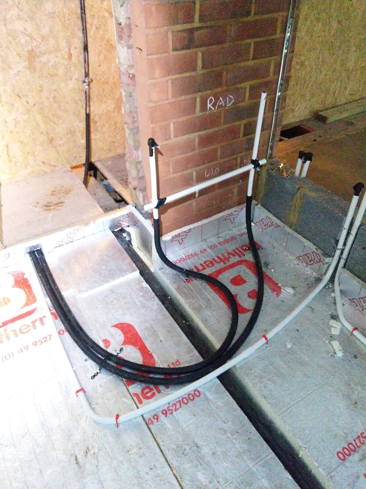

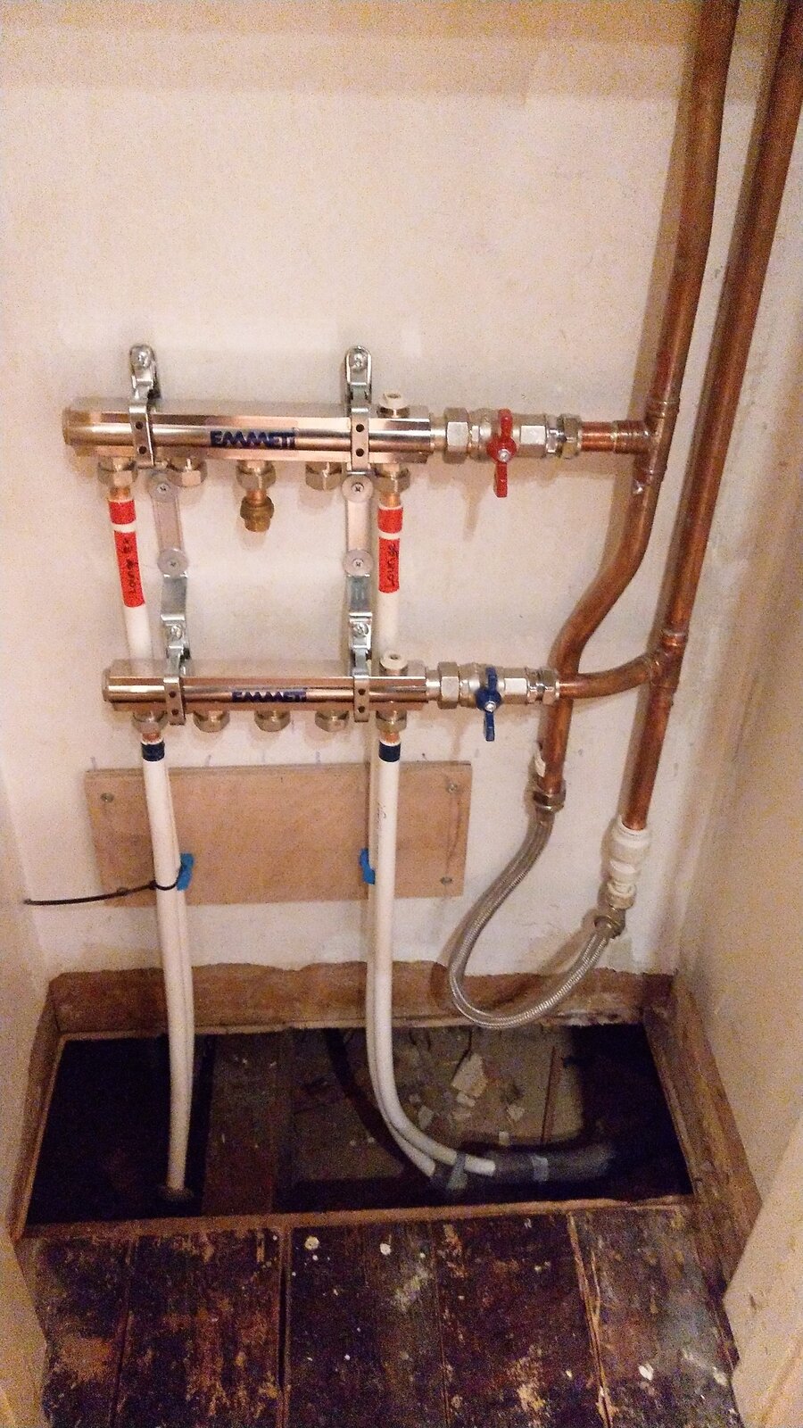

I've done a similar thing where I had to lay the radiator pipes under a suspended floor then into a new screed, I didn't want any joints to be buried as that's just asking for trouble in my book so I did this, I used Kuterlex PC covered copper pipe that you can get on a 25m coil, it's protected from corrosion by the covering and can be threaded through floors in one piece.
It's expensive but hopefully means I'll never get a leak and have to rip the floors up!
Radiator end.
Manifold end.
