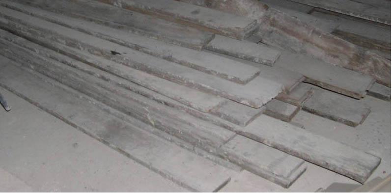

Hey guys I need some advice on floorboards. I've never done this before and have gone and bought some in a fit of optimism :)
The floorboards are reclaimed form a chapel. They are 50-50 4" and 5" wide. Length varies (going to sort this when I pick them up to make sure I get good lengths.
The floor is 12' by 14'. Currently there is carpet. Underneath is floorboards about 100 years old, as well as some areas of chipboard (two bits, about 20% of floor.) Underneath the boards is open joists going down to the original Victorian foundations (no basement.)

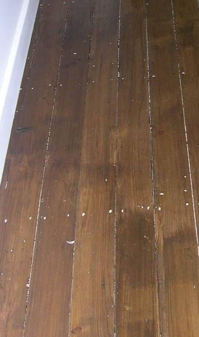

- lay new boards direct on top (at 90 degrees) of old floor.
- nail through existing holes (see pics) at 300mm intervals.
- leave a 10mm expansion gap.

I suppose keeping the original floorboards and sanding them isn't an option, as 20% of the floor is chipboard? Can you get matching boards for the chipboarded area?
Assuming you are going to use new floorboards throughout, I would give serious consideration to taking up the old floorboards, and insulating between the joists, before fixing your new boards directly to the joists. You'll thank yourself come the winter.

If I use Elastilon, what should I do about the empty old nail holes?
you are going to be lucky to get many nail holes lining up as its an old building and joist spacings would be diffirent with each room
keep in mind half the holes the nails will have been pulled through so the holes will be quite big
you also need to check the boards for size and thickness as high traffic areas will be thinner than other areas
Old nail holes in existing or reclaimed floor?
If in "new" floor, either fill them with a mix of sand-dust and special filler or leave them as a special feature?

Both, really. I guess you're right, the holes will give the floor character.

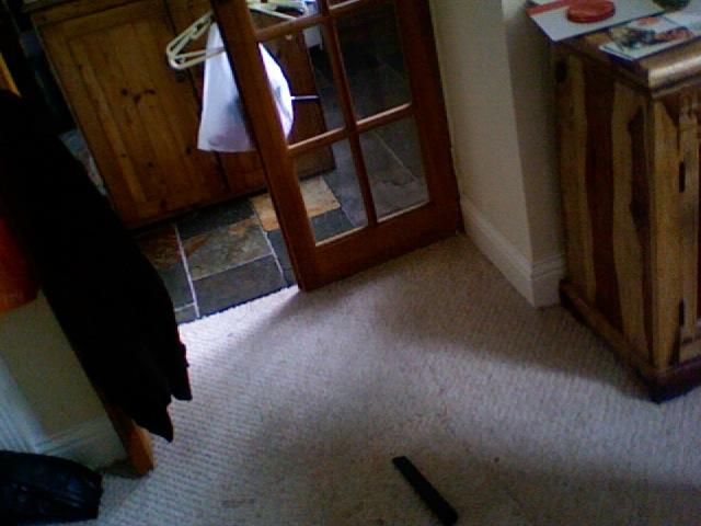

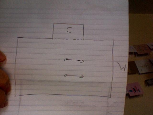

There's a concrete section in the floor (1m x 50cm)...glue that, nail the rest??
Use long enough boards that overspan the concrete area - then you could get away nailing those boards and use adhesive underneath the board where it runs over the concrete.

Right, except I can't do that.
We want the boards running away from the window. So, looking at the pic below, the boards need to be lengthways (the window's to my left)
Very fast replies, thanks!
Meaning the concrete part starts at the wall your board starts too, if I understand correctly?
Ah, low tech beats modern tech at the moment ;)
It's a non-walking area? You could get away with just glueing there (use proper flexible adhesive and put a weight on it if the boards are a bit bowed to make sure the whole lot is properly adhered).
Looking at the high tech image it doesn't look like a non-walking area. Never in favour to recommend screwing the boards down anywhere - but in this case it might be your solution
