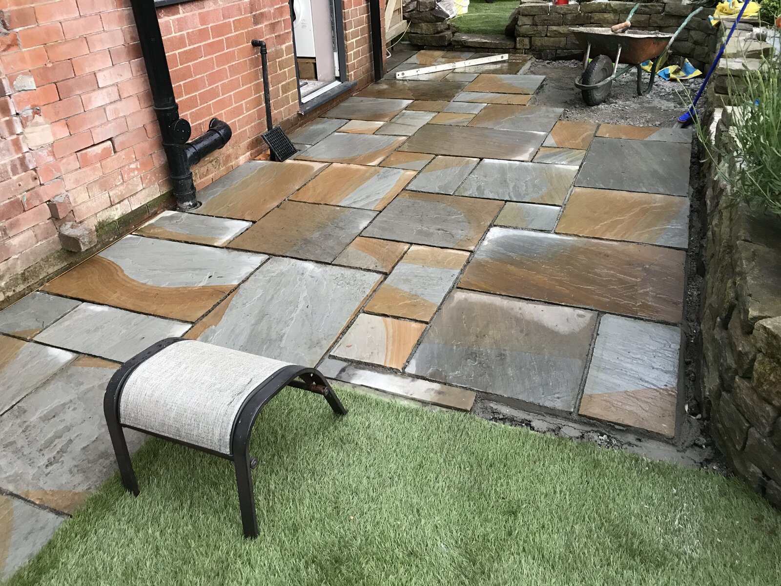

I’ve just put mine on 50mm of wet sand and sharp sand mix on a hard clay/soil base.
There’s a low bit that I brought up with MOT

I had my own done following @noseall method and it is splendid
https://www.diynot.com/diy/threads/top-tips.482618/#post-3908222
Would you recommend a 6:1 or 10:1 mix?

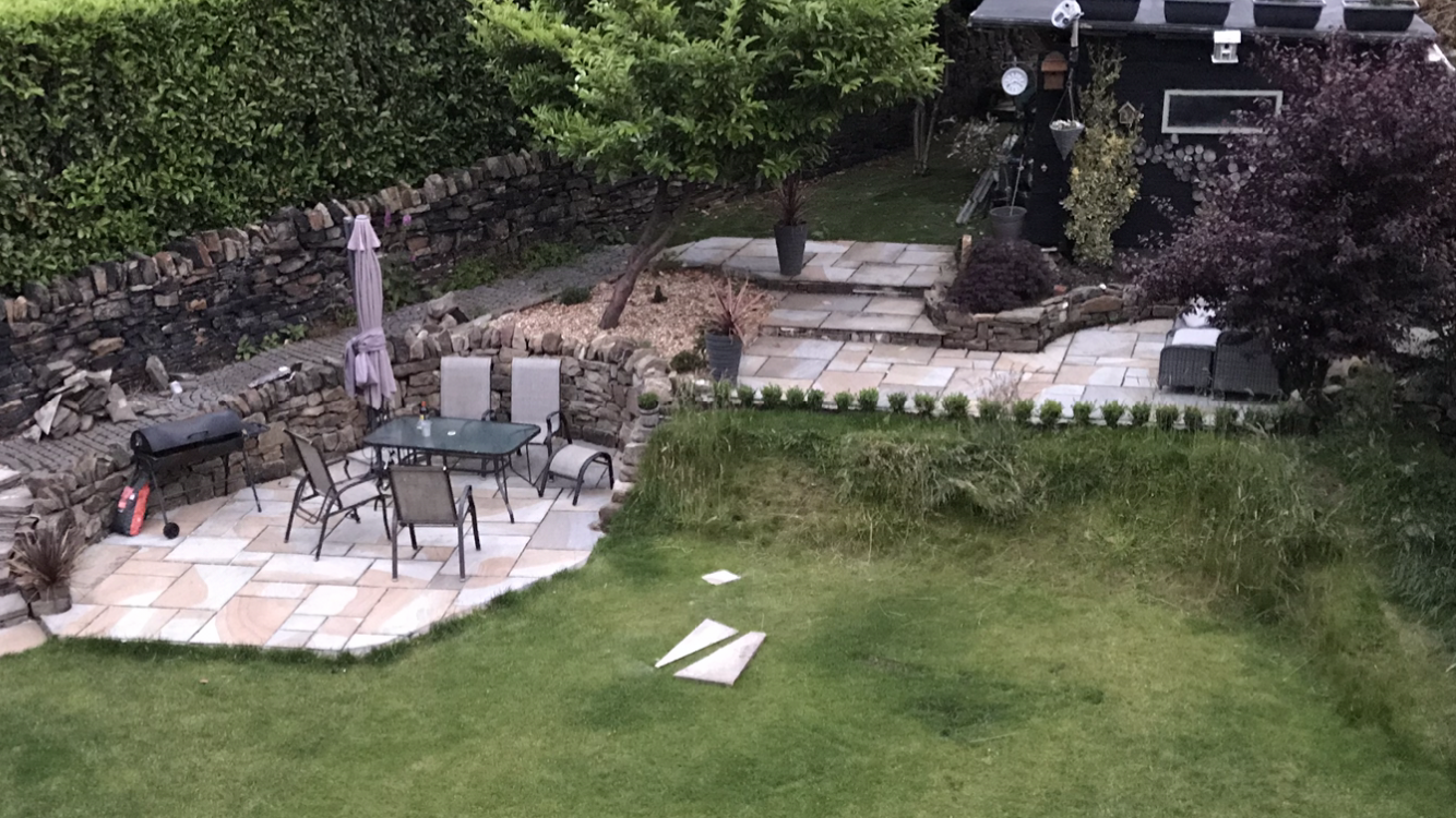

I did mine 5:1 wet. I’d done a couple of other areas in the last couple of years exactly the same:
