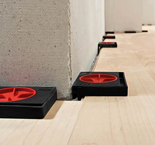

Cramping on floating engineered or laminate flooring is often achieved with sets available from flooring suppliers. What does your flooring supplier recommend?

That is a top of the line Bessey (trade) set, but TBH the expansion joints at the edges can be dealt with by using simple folding wedges or packers and there are far cheaper band cramps around for one off jobs. This video shows how they are used whilst a longer video showing a (speeded-up) installation can be found here. Note that in the second video the installer is using home-made spacers, but also that he is wearing substantial knee pads (very necessary, although for a one off one of those foam gardening kneeling pads would suffice) and that he is making use of a non-marring rubber mallet (this should be white to prevent marring)
