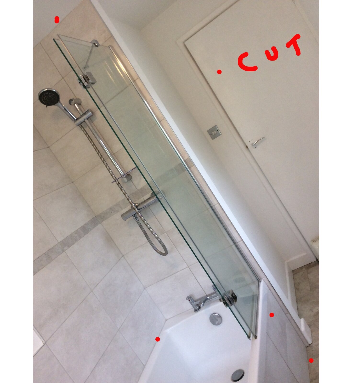

Trying to work out best layout for our bathroom tiles. 3 walls around bath, bath is 1600 x 700mm
Tiles we are going for are 600x300mm and plan is to stack horizontally. The long side of the bath do I start in the middle with a full tile and then cut both ends?
And do I start with full tile on the bath edge and cuts at the top or does it need evening out?
Regarding height, I space to get best overall picture which in my case was a cut at ceiling, above bath, below bath and down onto floor ,also tile off a level batten under the first full tile...I didnt want to puncture the tanking so built a frame on the bath to tile off.
