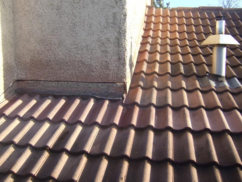

Hi all,
I am re flashing part of my roof, that was very badly done with flash band.
I am replacing it all with proper lead flashing
There garage that joins onto the gable end of the house, and is about half the height of the main building, then there is an extension that runs along the back of the house.
So I need to run my flashing down the garage roof, through 90 degrees and along the extension.
But I can no find out for the life of me how to do an outside corner in lead.
I am aware that you can buy pre fabricated corners and also lead can be welded, but I want to do this in the traditional manner.
Cant find anything useful on the net, and have spent hours with bits of cardboard trying to figure it out.
Can anyone tell me this deep dark secret
Thanks in advance, Nick.
cardboard won`t help ;) roll out some pastry - that`s the principle involved , moving the lead around by bossing it :idea: try googling bossing lead or look at the Lead Sheet association . And use plastic bossing tools - they don`t mark the lead like " traditional " wood ones

To be honest lead bossing is a very skilled art and although flashing are perhaps the easiest thing to do you will in all probability split the lead until you get the hang of it.
Remember that lead flashings need to be installed using maximum 1.8m lengths of lead. I keep seeing loads of examples where some-one tries to use longer lengths only for it to split in a few years due to no allowance for movement.
These days you can get clips to secure the lead in brick joints or you could use traditional lead wedges if you want some more work with it
Blagard is right although I think he made a typo. The longest length you can use for a peice of flashing is 1.5 metres. Use code 4 or code 5.

Morning gents,
The roll I have is code 5
I have attached a picture showing the corner
It is the right hand (outside corner)
Jist ignore the tannalised wood.
Originally the tiles stopped about 1 tiles width from the wall
The flashband was stretched across this gap, then covered over with motar in the wall.
This left a 1" deep 4" high channel in the wall
This would have been awkward to fill then chase because of the old brick behind.
So I have fastened a length of tannalised wood to the wall, and cut the chase above that.
I am happy with that, its just how to dress the lead around that corner.
Cheers,
Nick
Open the guide I linked to, scroll down to page numbered 22 and look at side flashing - ignore the cuts for steps otherwise it is what you want.
Glad you got code 5 - less risk of splitting more material to stretch!
Yes, you will need code 5 for that if you are going to boss it.
To be honest, I am a leadworker and I would always cut and weld this kind of detail as it would be quicker, stronger and last longer. I could boss it, but it is pointless.
If you still intend to boss it then I would advise you to use seperate pieces of lead for the internal and external corners. Concentrate on getting the standing corners done first berfore you turn it into the chase. It would be very difficult to explain here exactly what is involved, but good on you for having a go.
Good luck.
