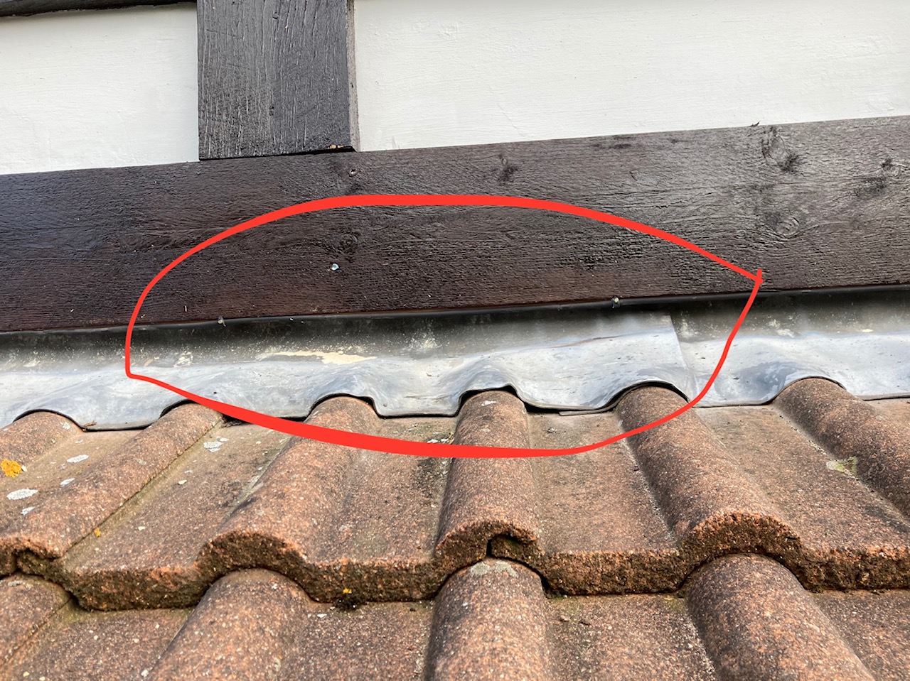

Hi
I just had my mock tudor board in front of my house replaced. After the contractor left, I found one small section of the flashing has popped up a bit. As shown in the photo. How do I adjust it to the original shape (round shape, close match to the tile)? using a hammer? Or can I just leave it ?
Thanks for any advice.

Don't use a hammer. Use a bit of wood, the back edge of a hand brush or a broom handle from the gutter.
@woody, Thanks for your reply. I tried your method, but the flashing is very hard and not moving at all.
I see there is quite a bit length of tile beneath the flashing, so I suppose wind-driven rain (through the gap between the flashing and tile) would unlikely result in a leak?
Lead is extremely malleable, and will bend when hit with a stout piece of wood. Is it your technique?
Thanks again for your replies. I used the wooden handle of a small garden tool and didn't dare to use much force, in fear of breaking the tile. Maybe I should try a bigger piece of wood (e.g. a wood block) and user more force?

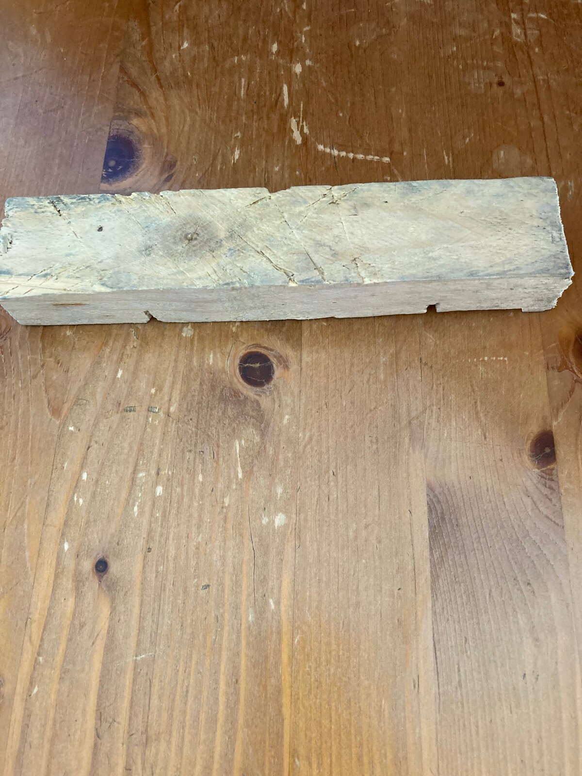

I will try this piece of wood.

You don't really need to whack it, just tap it, and something like a 3x2 or 4x2 a foot long or so would be enough
I tried it again (keep hitting it with a piece of wood), but it still didn't bend. If I leave it for now, how likely there will be a leak in the future?
To properly adjust/repair the flashing, I guess the mock tudor board has to be removed first since the flashing is fixed to the bricks behind the board?

At a guess if you can not tap the flashing down it could have dirt or similar under it try raking under the flashing with a long handle scewdiver, decorators putty knife/ scraper
The two kinks will make it a bit more rigid. However it will dress down , even a piece of 2x1 will do. Try again square on. the tiles are quite strong
