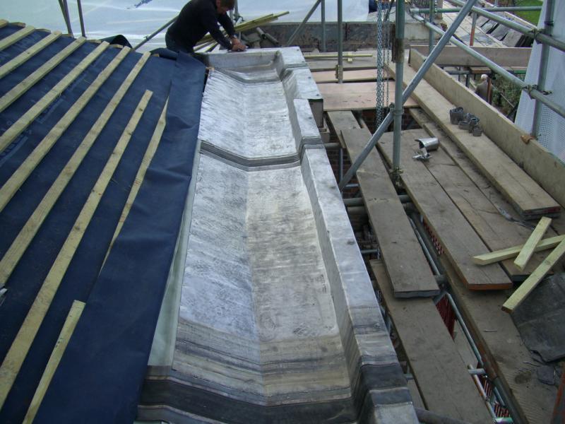

this is what juslead is trying to explain about expansion joints. this is a job i done last year the flowband joints are lead welded every 2m.. .
your gutter has been done wrong.
the lead has been rolled out in one length and will split in time
sooner if it's less than code 5 which i bet will be the case..
