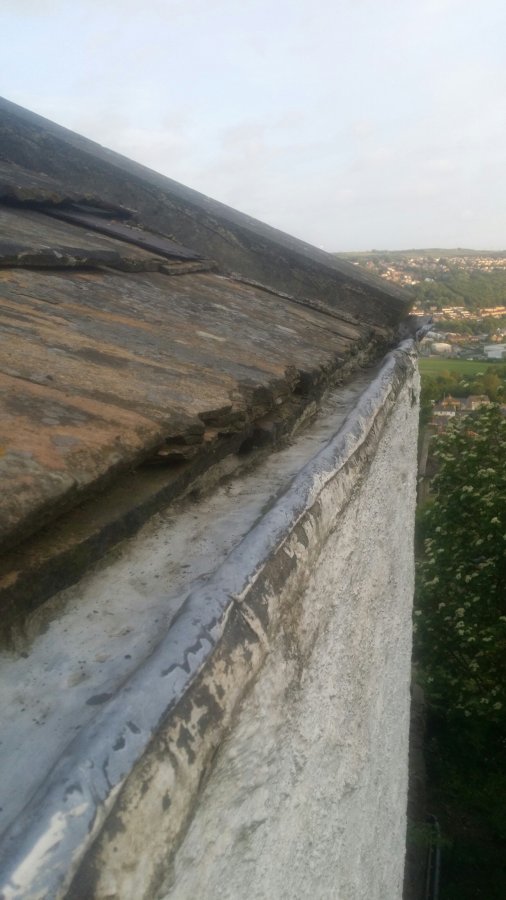

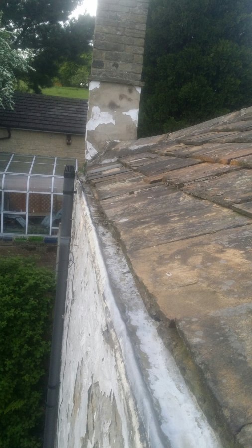

Hi, Guttering question. My house is about 150 years old and the guttering is a trough built into the top of the wall. Stone tiles on the roof and the gutter doesn't protrude over the edge. I don't know what you call this system but it's lead lined and I don't think it's sound.
The lead doesn't fit the whole half moon shape of the trough for a start and I suspect it ought to lap over on both sides. It's well short on either side which is surely no good when we get those biblical downpours. I'm on high ground too and the winds can be very strong particularly on one end of this particular stretch of wall. I think heavy rain and driving wind is pushing rain over the inside and under the stone tiles. Black mold on the top front corner in the bedroom and patches of damp plaster is my evidence. Not loads of mold or running walls but enough to concern me.
I have a notion (oh dear) that I may be able to run wider pieces of lead over the top of the original and push it under the tiles and fold over the outer edge of the wall. I've never done leadwork tbh, just watched videos on the web. I get the basics about cutting into lengths to reduce thermal movement and different codes of material. I think you use tubes of lead sealant to seal the joints. How it's held in place, weight of the lead?
Length of wall is probably about 20 feet and then there's round the corner another 12 feet. What sort of money do you think is about right for Northern prices to get it done professionally.
What's involved to do it DIY? I do not want to consider removing tiles and I don 't think it's going to be easy to get into the loft area either.
I've a new tin of Thompson's 10 year roof seal which is tempting to throw at it, brush on actually, two or three good coats. I just don't want to botch the job and find it doesn't work.
