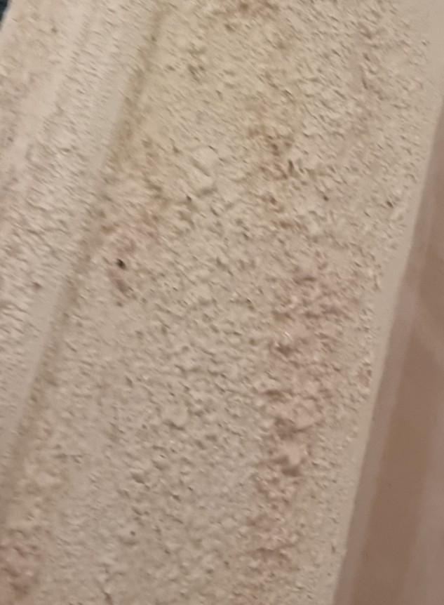

I'm stripping the stairs case/spindles in a 1920s house.
There's 5 or so layers of different paint. The oldest 2 are lead based, according to the lead test kit.
I'm using a dichloromethane / methylene chloride paint stripper (what Nitromors used to be until dichloromethane /methylene chloride was removed from the recipe).
Anyhow, the stripper demolishes the non lead based paint.
It's kind of effective on the lead based, it sort of softens it and most of it comes off with scraping (instead of just blistering and peeling off).
Effort is 10% on the first 3 layers, 90% on the last 2.
Is there a more effective stripper for these ancient lead paints? Or is elbow grease the only way forward?
Appreciate your help
First layers off like a dream
Last layers stubborn
Why not use a heat gun? Set it at about 450 degrees to reduce the risk of burning the lead paint and releasing fumes. If you opt for a higher temperature keep the gun moving faster.
You could always remove the spindles and send then off to be dipped.
Not happy with the idea of a heat gun. I guess some wet sanding may help (to prevent gas)
No chance of removing the spindles, logistically impossible
The advice to stick to 450 degrees is from the Health and Safety executive. Personally, I set my gun to the max- 650 degrees and full speed.

I am using stripper on my stair treads because I suspect lead (50's house) but the banisters are recent.
using wire wool and stripper (obviously with big gloves) and a sort of up and down with a bit of a twist action will work.
