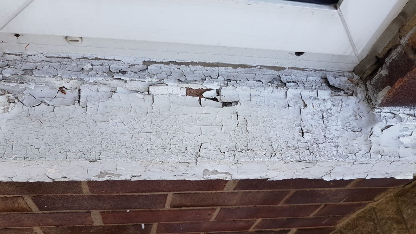

Thank you. The internal wall paints have chips as do the doorframes and doors, there's paint coming off the radiator badly but I've no idea if that had lead. The kitchen looks as if it has never been redecorated - the wallpaper was painted over but I don't know how long ago. The back porch is just a paint disaster. The landlord repainted before I moved it but lots of the fresh paint flaked off and is still over the floors. Attached is a picture of the outdoor window sills which are the worst for flaking. I am so worried about this because of the age of my son (and I'm renting and a single parent so I am trying to work out how I can deal with this asap).
I've read about encapsulation paint but can't see any for sale in the UK. Does anyone know where I can buy some?

Encapsulating just means covering up the existing paint so that it can't be disturbed. Another layer of paint would count as encapsulation as long as the existing paint is not coming off.
The picture of the windowsill doesn't show any obvious sign of lead paint.
In fact, it looks like masonry paint flaking off.
Thank you.
I tested the paint inside - I didn't have enough swabs to test many areas but I tested chipped paints on the doorways and sideboards and they did come back positive for lead.
