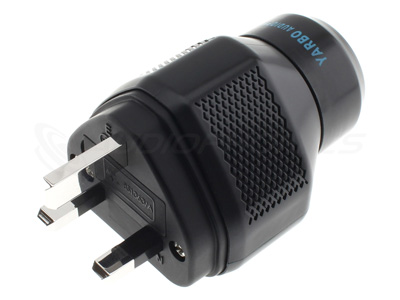

Any wallmart should still comply with the BS1363 regs, but many don't, the type which fold flat for example. Often plugs have a bit to the side to make them wide enough to comply 1694948188858.png but this is often missed out with wallmart power supplies. I think a plug like this
is good as if cable pulled the plug comes out without damaging the plug or socket, but it seems not allowed. Yet we do see it with wallmart power supplies.
So when looking for plugs, not wallmarts I have only found a couple where the cable does not come out of the bottom 1694948828962.pngclearly there are some, but other than the earth wire, not seen any where the cable comes out of the top.

, missed out with wallmart power supplies. I think a plug like this View attachment 314212 is good as if cable pulled the plug comes out without damaging the plug or socket, but it seems not allowed.
Indeed, BS1363 does not allow such plugs.
The plug you picture, was sold not as a "plug" per-se but as part of a "cable coupler".
Clipsal also sell a plastic screw-lock waterproof 13A plug and socket which had the cable come straight out the back, I think these were also sold under the crabtree brand at one point but perhaps my memory is faulty. IIRC they were marked as complying with "relavent clauses" of BS1336. Lewden also have metal waterproof plugs using various BS pin configurations (though they made an incompatible design change not so long ago for some reason), again with the wires coming straight out the back.
