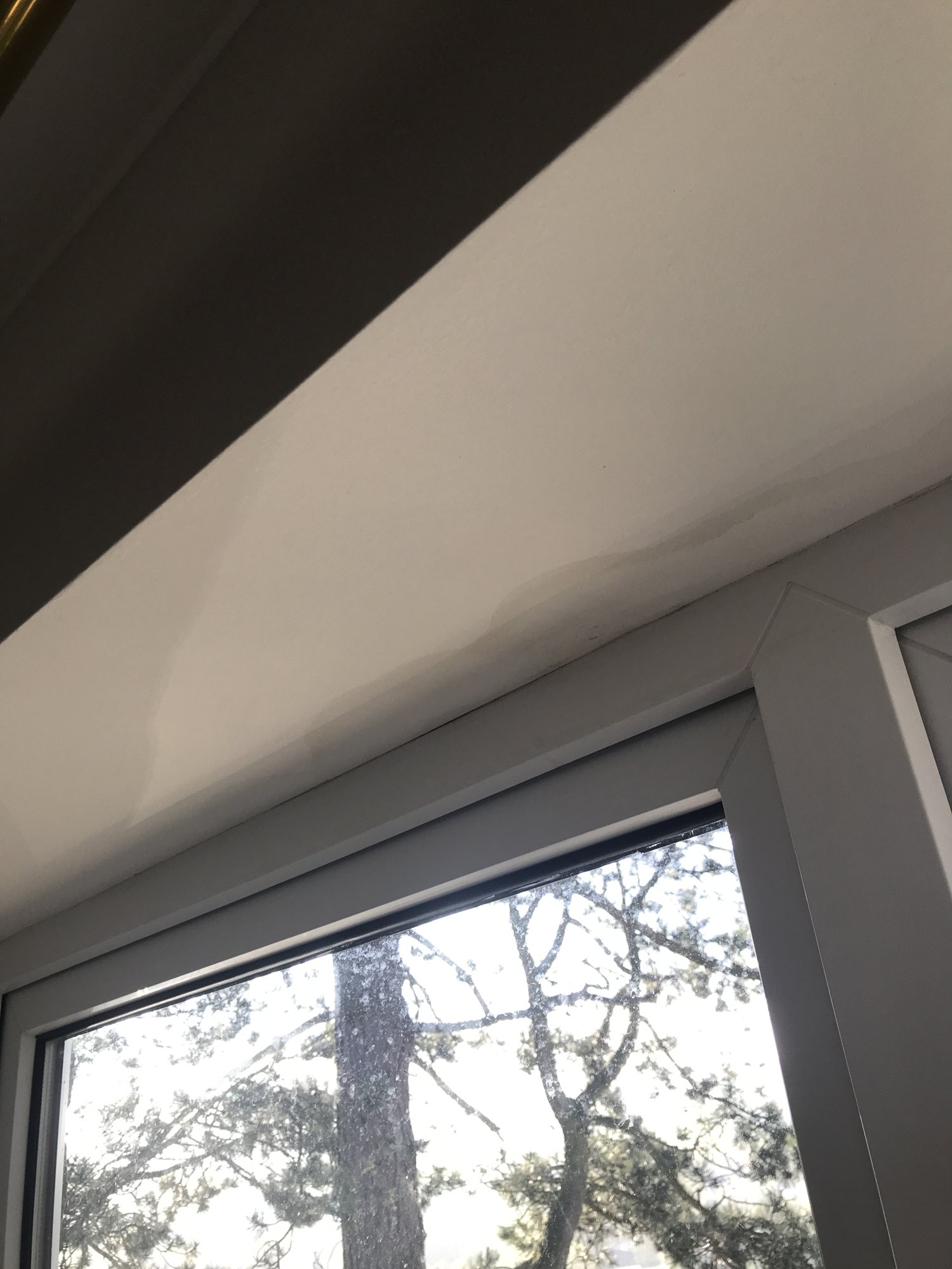

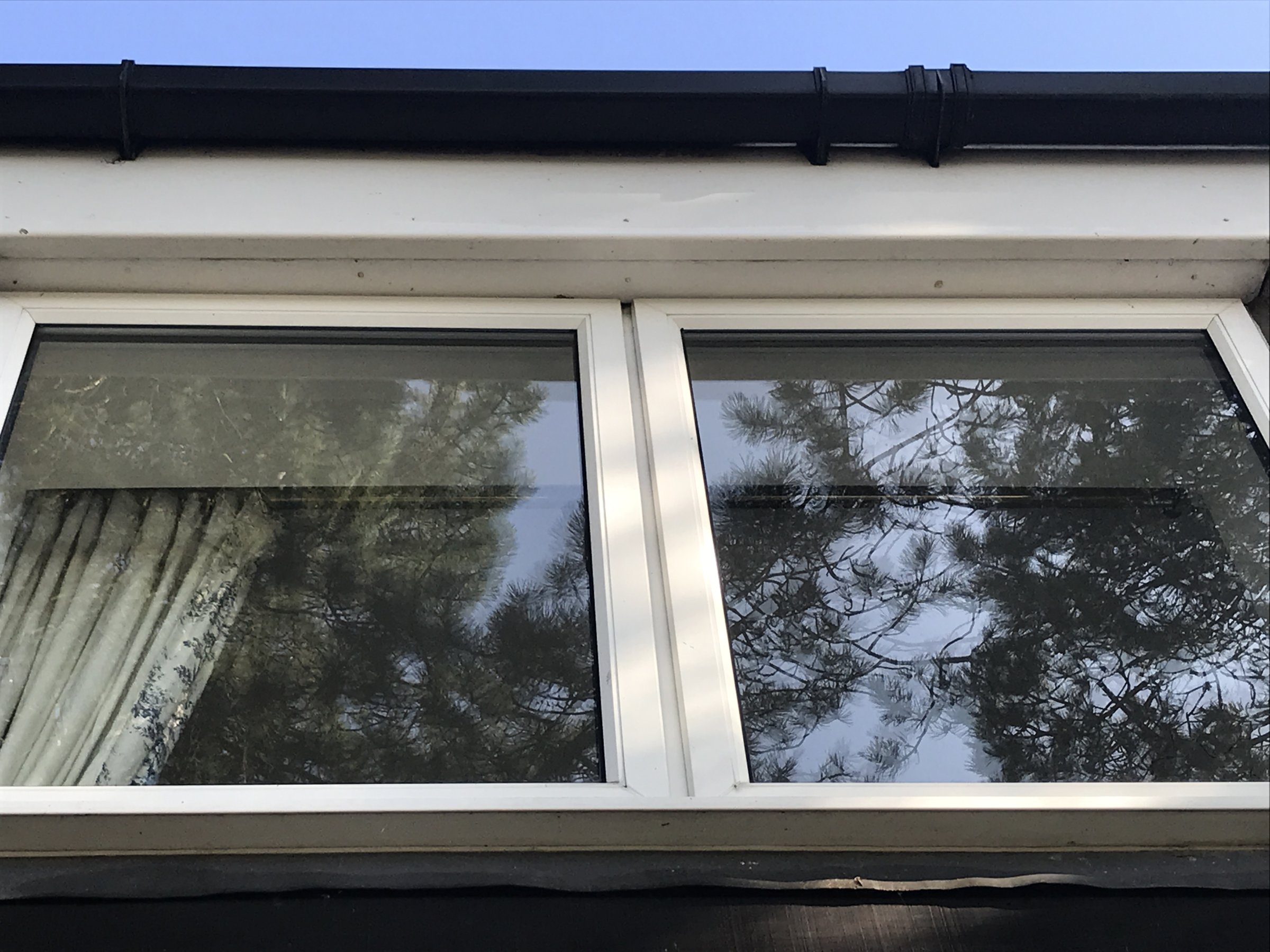

Leak above window
Faulty/blocked gutter joint that is leaking or overflowing and running back onto the facia/wall.
Also check silicone around window (externally)
Andy
New capping board fitted recently? tiles not got enough oversail into gutters...can see daylight between fascia and gutter=eave trays.
