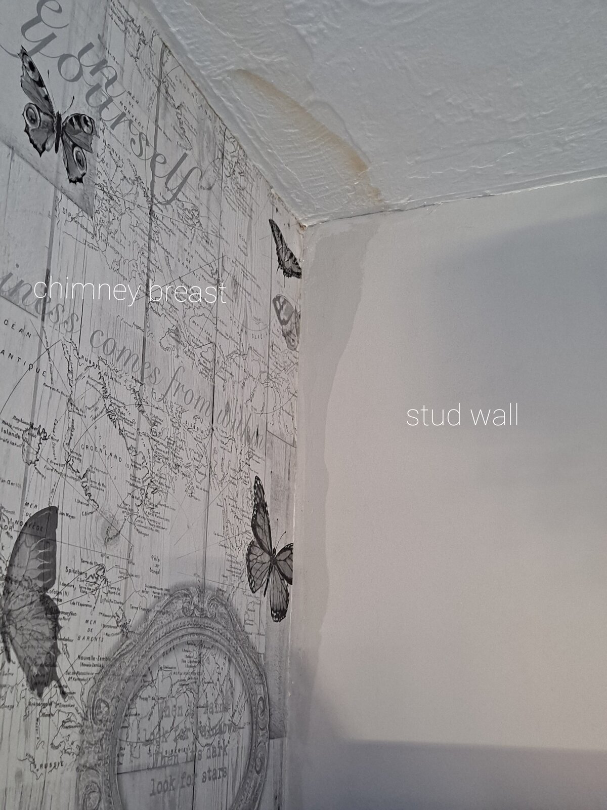

I am after a bit of advice please, we have recently decorated a back bedroom but have just discovered a water mark on the stud wall next to a chimney breast.
We used to get mould in this corner which we put it down to the large amount of condensation we got in this room (now fixed after fitting a PIV unit).

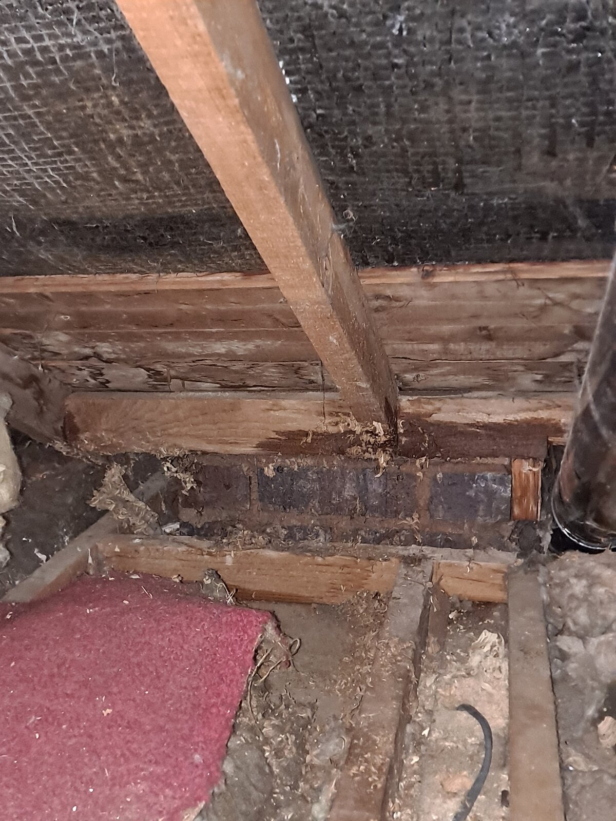

I have been in the loft and the batton next to the breast looks wet but only on at the bottom of it.
I know i need to get a roofer out but wanted to see if you guys could give me some ideas of what the possible issues could be beforehand?

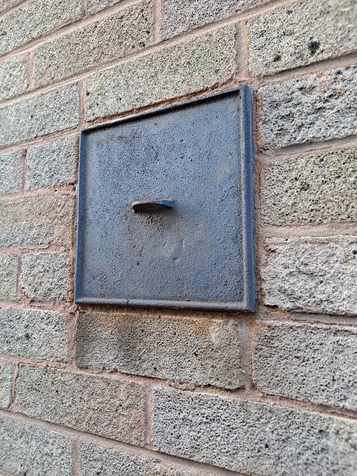

Also should there be an air vent in a chimney breast?
There is a black cover on the outside wall down stairs which has been siliconed shut but no other vents visible inside or out.

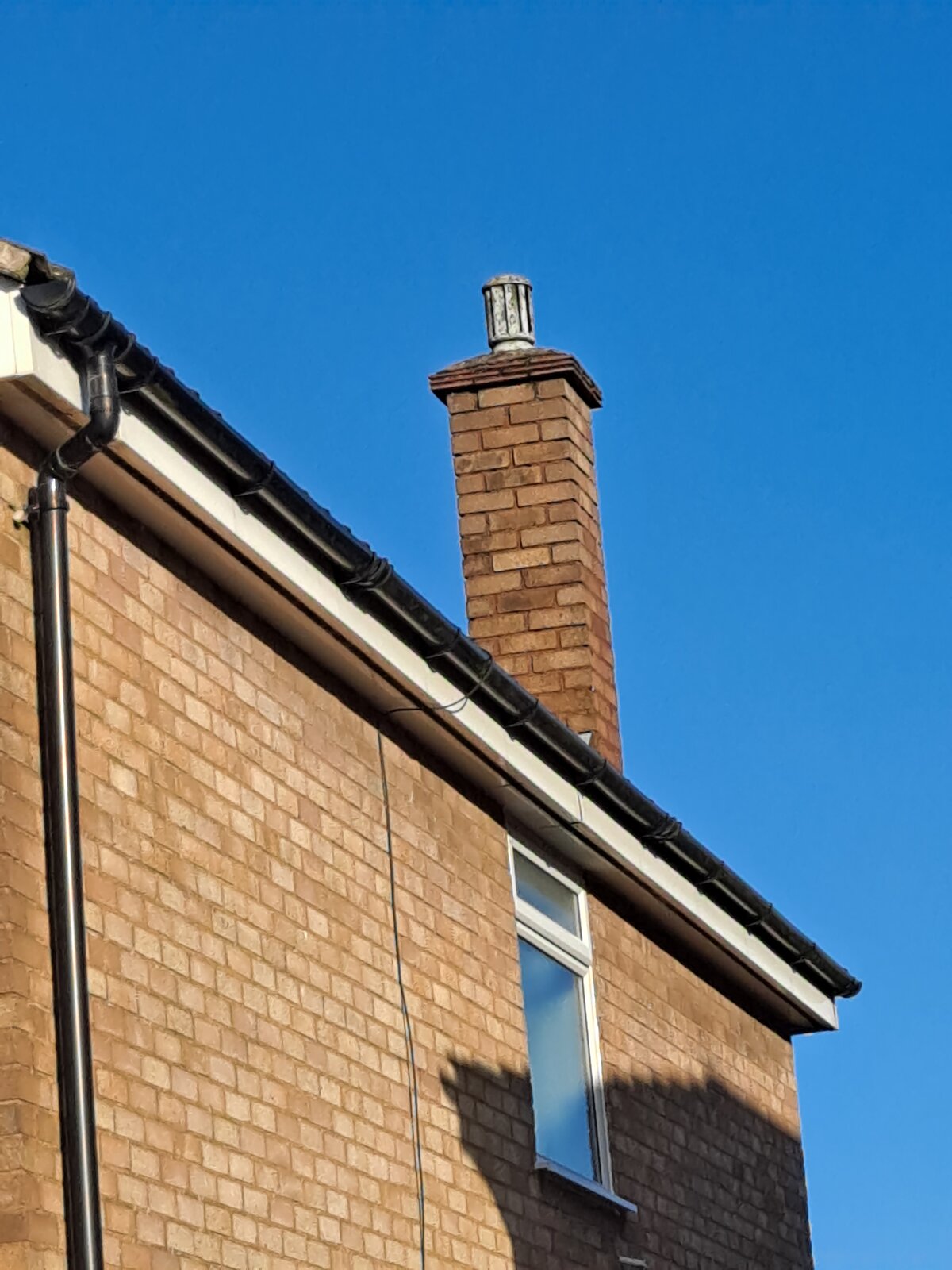

You have a leaking lead back gutter behind the chimney - that plate was a cleaning hatch for when the chimney had a solid fuel boiler in the kitchen . On the top of the stack is an old gas flue terminal - if you don't have an old gas boiler @ the bottom of the flue. In the kitchen . Then the best solution would be to drop the top of the chimney and roof over the void . Scaffold over the carport, access from your side and the chimney can be taken down a brick at a time .If you still have an old flued gas boiler in the kitchen - time for a new one ;) P.S no need for a roofer - a good jobbing builder will do.

Thank you for the reply, really like the idea of removing the stack and tiling over.

Any ideas on a temporary fix from the inside?
Just incase they can't do the work quickly
I have got a quote of £850 to remove the stack to below the tiles and tile over.
They are also going to cap our main chimney and repoint some of our ridge tiles which have mortar missing, does this sounds like a reasonable price?
