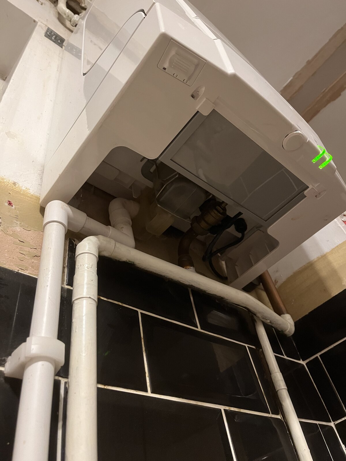

I’m seeking some advice on a leaking boiler pipe please. I’ve just taken back my kitchen to the four walls ready for a refurb and have noticed a slight leak from one of the pipes connecting to the boiler

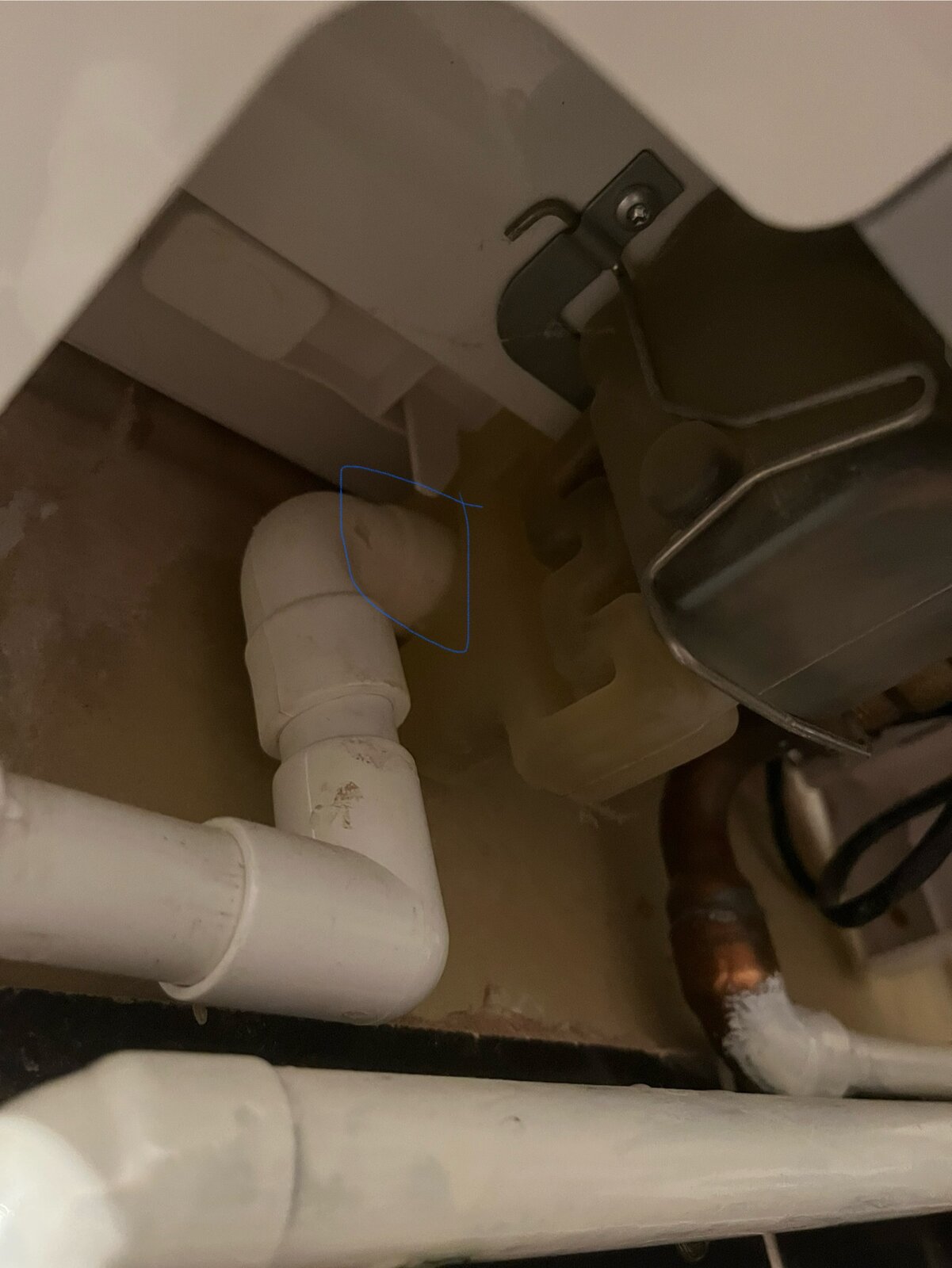

It is leaking from the rubber section of the white pipe, circled in blue
Is this simply a case of pushing it back in? I thought I’d come on here to ask for some sound advoce before cracking on with it!
Many thanks
It's a condensate pipe. If it will firmly reattach then do so. Can't make out if either part is damaged to enable it to make a watertight seal.... Try it and see.
Looks like it’s short or has been knocked.
