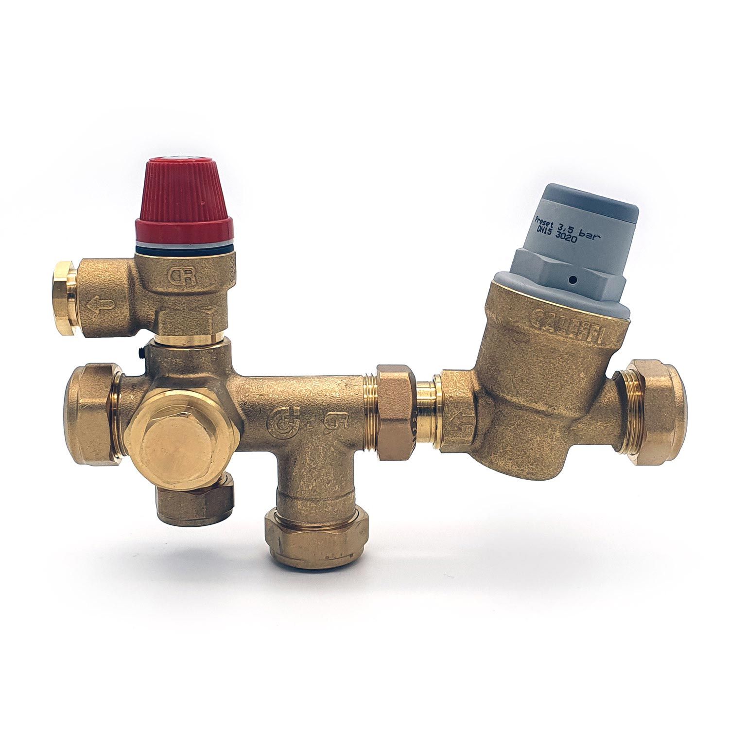

Hi,
When I turn on the hot water function of my gas combi boiler (Glowworm Ultracom2 35Store), I get a leak from the 6 Bar PRV attached to the cold water pipes beneath the boiler. I've had this situation for several months now, and it eventually appeared to progress to also leaking when the hot water was off (could the PRV have been damaged from the contant opening?). However, I replaced the PRV approximately two or three weeks ago, and since then it again only leaks when the hot water is on.
The PRV is downstream from a pressure reducing valve that should limit the pressure to 3.5 Bar, and upstream of a TMV, the boiler's input for heating water and the CH refill line. There's a pressure gauge on the boiler refill line, but unfortunately it's been broken for years.
Does anyone know what the cause of the leak might be?

Thanks for the responses so far. Here's a photo of the external multibloc I have that includes the 6 Bar PRV (Altecnic–Caleffi 22mm 3.5/6 Bar Multibloc Inlet Control Valve). To clarify, all the components I mentioned are external to the boiler (sorry if I wasn't clear enough). There's an external expansion vessel as well.
Those combi valves would usually be used for unvented cylinders.
This is getting more confusing though. The Ultracom 2 35 store - G.C. No. 47-019-15- has an internal EV for the store, so there should be no need for an external vessel. The boiler also has an internal check valve on the cold feed prior to the HW pump and HEX , so a combination valve wouldn't be protecting anything as far as expansion is concerned never mind the internal store. There is also no reference at all from Glow Worm that boiler requires a combination valve, only a pressure reducing valve, if the mains pressure is high.
