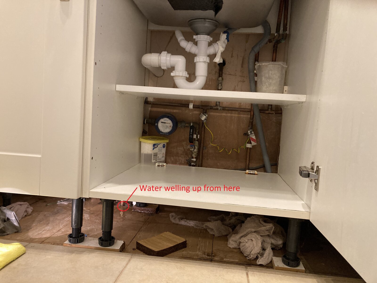

Hi,
I've got water slowly welling up around the mains pipe coming up from the kitchen floor, I'm having to have the water turned off in the street at the stop cock most of the time, only turning it on for a brief periods to do washing and fill some buckets and bottles.
The emergency plumber who came and looked at it said copper pipes were no good buried, especially through concrete, and it might best to replace the whole 5 metres of pipe under my front drive out to the street. He said he could drill round the pipe on the kitchen floor with and sds drill and see if the leak is near the surface and fixable, but that if it's copper all the way then other leaks could occur. The water board confirmed that the pipe going from street stop cock to my house was copper (they had to come and fix the street stop cock which wasn't working)
Any suggestions on best options here? What's the typical cost for replacing 5-6 metres of buried pipe?

A good plumber should be able to remove a kitchen unit or 2. Worktop might not be necessary. Can you post a photo?

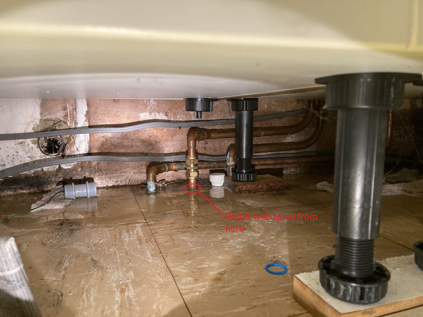

Here are some photos, as can be seen, the entry pipe is under the vertical kitchen unit partition, so just removing the bottom horizontal board won't provide a 'straight down' angle to work on it. If I was getting the full pipe replaced, would it cost any extra to just get the new pipe entering via a new hole, positioned in an easier location (rather than reusing the hole from the original pipe which could just be capped off)?

There are water droplets on the pipework above floor level ,which could be condensation, are you certain water is coming up through the floor ? Could it be pipes above floor level are leaking and water is just collecting where you indicate ?
I wonder about those drips as well, that looks a lot to be condensation, though I'm no expert. However, the water is definitely welling up from the floor around that pipe, you can literally see it pushing up and spreading from there when the outside mains is turned on.

Did they actually find the leak or just the pipe that was leaking?
Do you have a water meter to see how much water is leaking?
FWIW - if the water is coming up there, then it seems likely to be nearer to the house than the street.
On another note, I see you have older 'original' tiles under the units - they look like they could be possibly thermoplastic tiles from that picture. In which case, you (and the plumber) need to know that they can contain asbestos (as can the bitumen adhesive they are stuck down with) so don't go digging up or disturbing them unless you have them tested professionally first.
