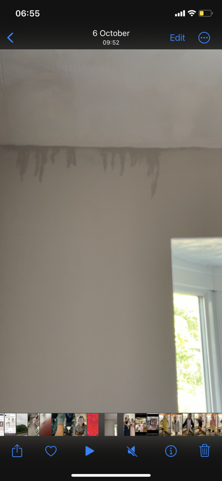

Hi
Can anyone help or has anyone seen this before?
We have had our guttering cleaned and check for leaks in our loft and it’s still happening.
We don’t know who to contact as we asked a roofer and they said it’ll be the guttering but it’s still happening. The leak runs all the way across the bedroom wall ceiling

An image of what is going on outside would be a boon.
Does roof have vents in the fascia/ soffit area and is your lagging in the loft pushed to far forward into soffit area hence making it sweat enough to run inside ? Like datarebel has said check for wetness
During this last few days of freezing weather and warm houses theres often condensation on the underside of exposed roofing felt. Lots of it.
If the roof underside is insulated & plaster boarded then you cant feel for moisture.
But if you look into the loft and shine a light at the roof underside & if the underside of the felt is exposed you will see droplets or what look like tiny sparklers - condensation.
The photo shows dampness near to what looks like a bay roof?
OP, is the bay roof flat or pitched?
Is there a chimney stack higher up the main roof?
Why not post photos of the outside of the main roof, and photos of the bay roof, especially of any valleys?
