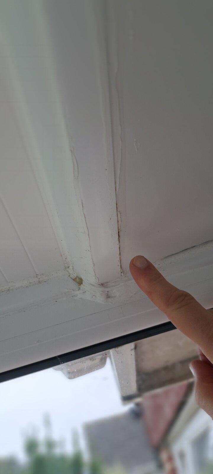

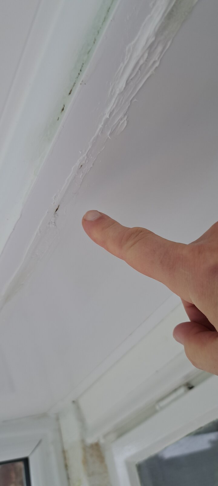

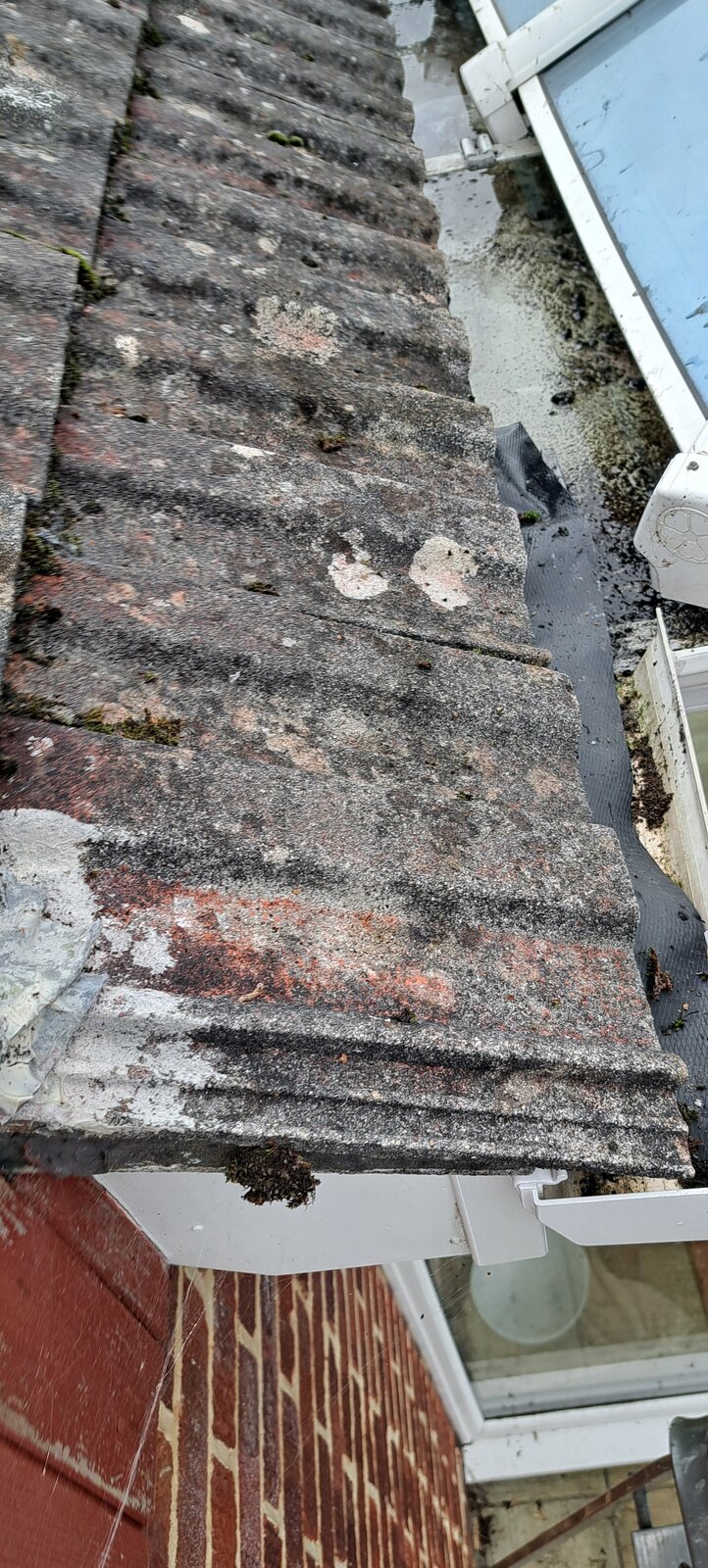

The Conservatory is leaking inside and nothing I have tried to fix it has worked. I bought some Evercryl and tried painting around anywhere I thought water might get in but made no difference.
Conservatory was here when we moved in.

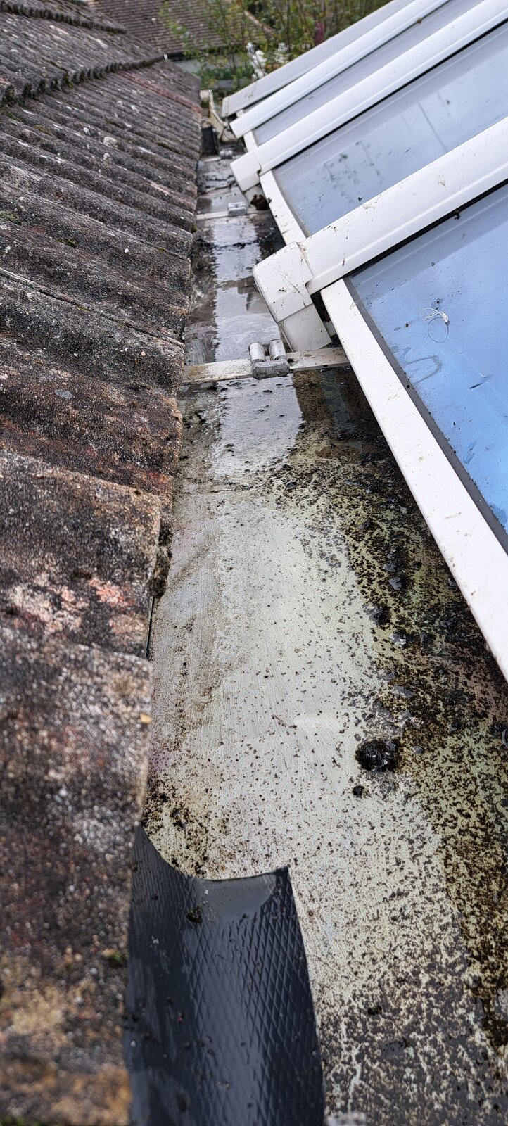

The shelf below seems to store water so I dont know if that means issue with soakaway? Although I have read it's normal for conservatorys to retain some water?

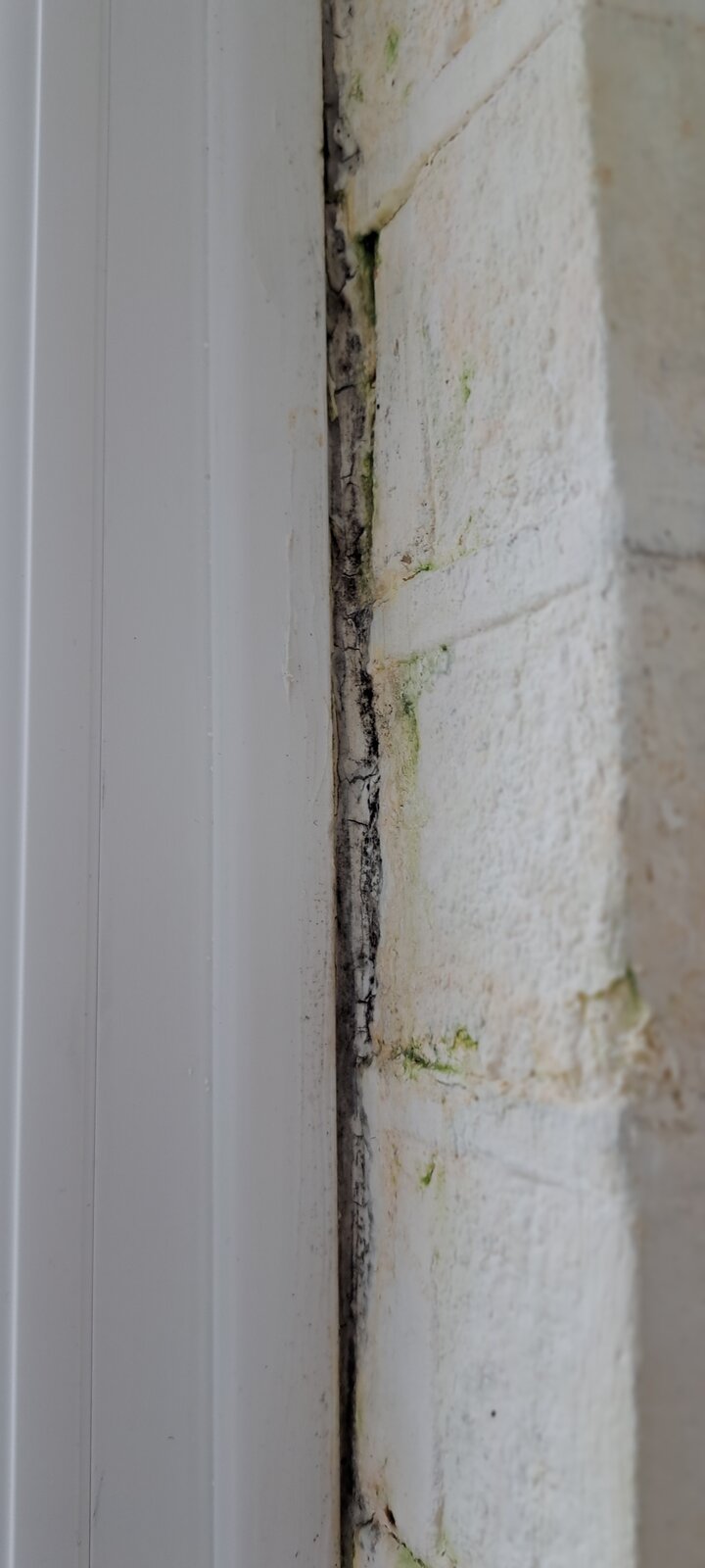

The leak is coming through inside here which is located below above shelf. Also as you can see water penetration at the side.

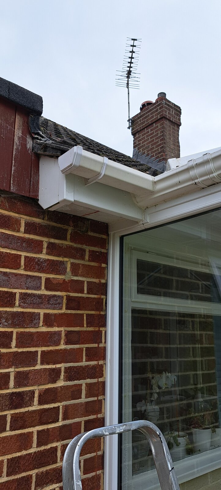

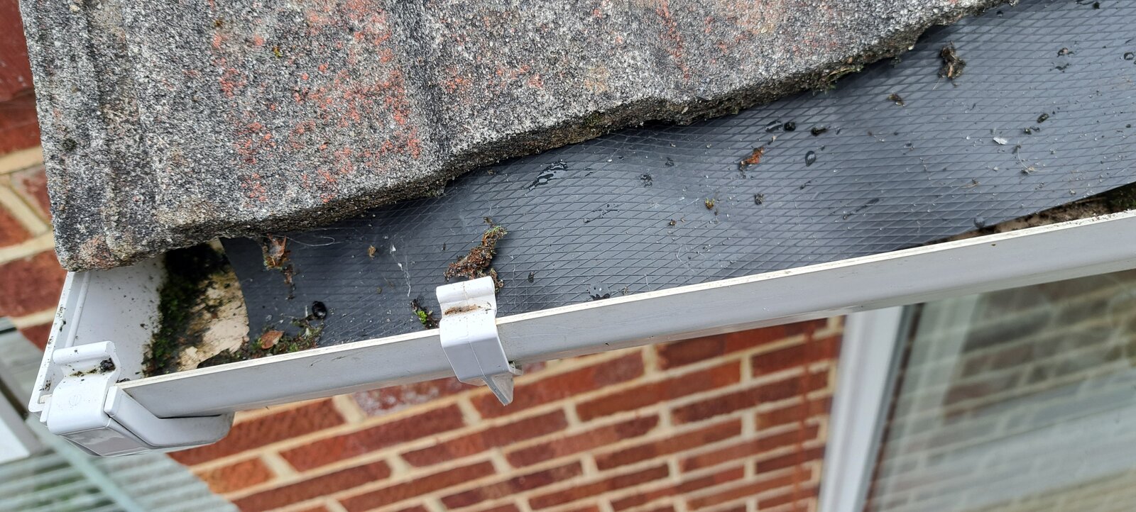

I can't see any obvious place where water is getting in. More photos below of roof/cons
Any advice greatly appreciated!
Thank you.
Jet wash that gutter out and show us some pictures of it very near where the leak is observed?
Hi thank you will do although I painted over all the shelf with Evercryl previously.
