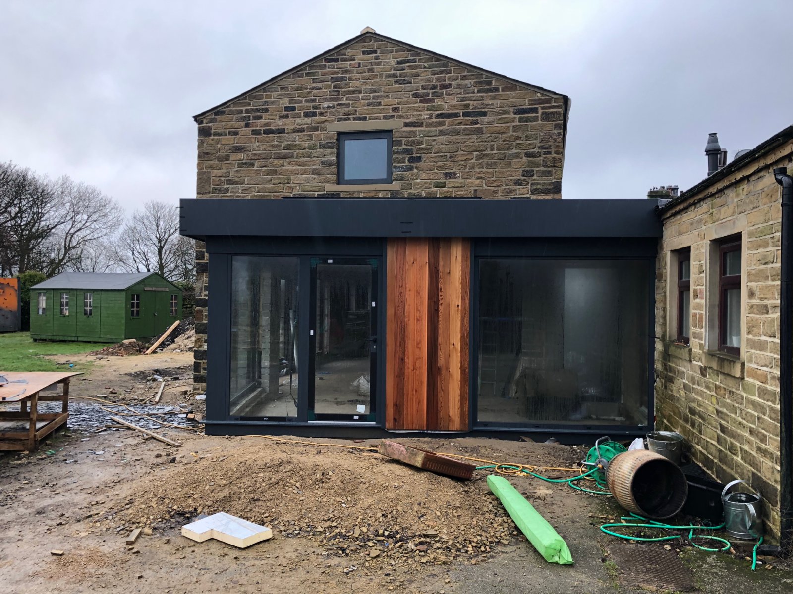

Hi All, I have a single story extension on the side of my house. The extension is constructed using a flat roof covered in that new rubber stuff. The existing house is constructed from block work and Yorkshire stone.
The extension is on the gable end of the house and is subject to a lot of driving rain.

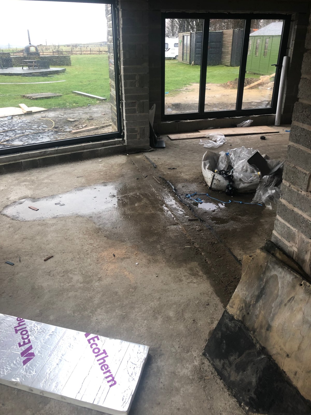

When it rains, and we've had some heavy rain in the past month all is fine. When the wind is blowing rain onto the gable I have an issue where water is dripping down the cavity and into the building.
Ive used an endoscope camera to look up the cavity and can see a DPC membrane with water drips collecting on it where it drips down. It looks like its running onto it from the external side of the wall.

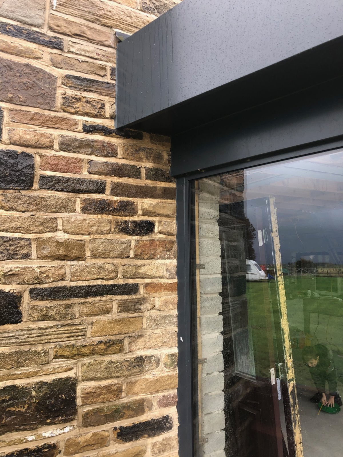

He has told me the flashing for the flat roof is in the same course as the DPC membrane. Its my thoughts that this and the DPC shouldn't be in the same course as there wouldn't be much cement or that the water is able to track in very easily through this course then drip down.

It's ok for water to bead/drip down the cavity on the inside of the outer leaf. Cavity wall ties should have have a kink in them to stop water tracking across to the inner leaf. At openings (windows, doors etc..) and where extension joins, there should be a cavity tray fitted across the opening so any water that falls onto it, will leak out of weep vents or fall into the cavity away from the opening. The cavity tray is fitted into the inner leaf higher to the outer leaf.
The stuff the builder mentions is really just Thompsons Water Seal, ok for cavity walls but not solid walls. As long as the DPC (cavity tray) is lapped onto the flashing, that should be fine.
In conclusion, there's no such thing as a waterproof outer leaf wall. As long as it's in good state of repair with mortar between the bricks/stone, cavity trays and ties should be installed correctly. The cavity tray should run the full length of the extension and up to 300mm past at both sides, ideally with some weep vents approx 800mm centres. Thompsons Water Seal (or equivalent) may help, but it won't a cavity tray that's incorrectly fitted or compromised.

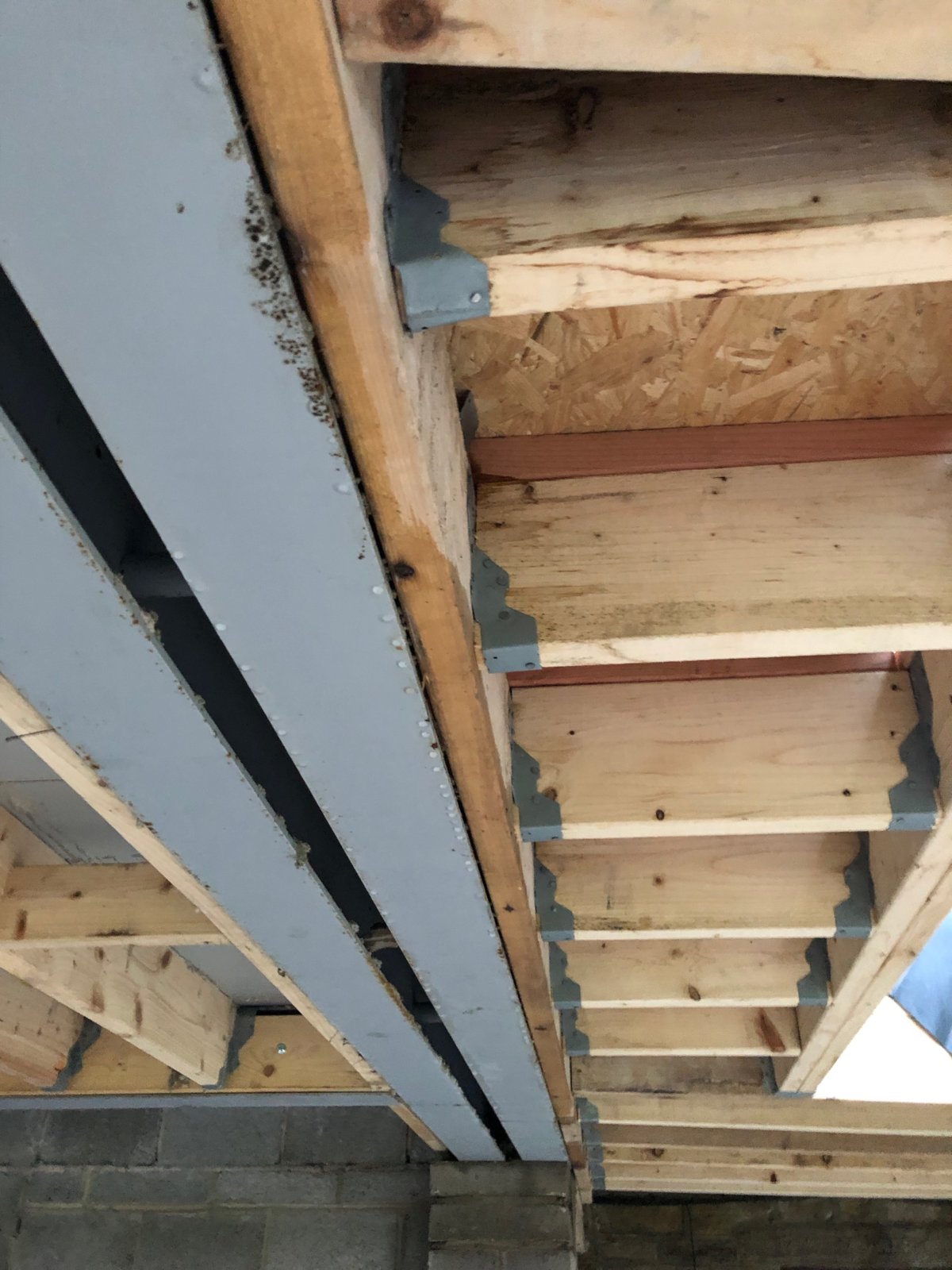

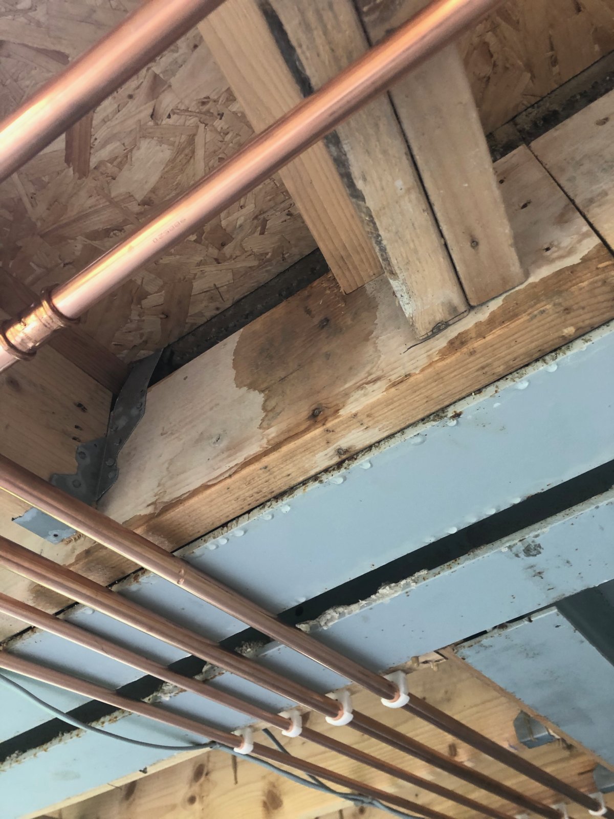

So you can see where the water appears. I can look up between the steels and see the DPC material. I will have to take a better picture of the flashing but you can see the edge of it in IMG_2846.jpeg.

Your steel is not on correct padstones!!
It's a combination of -
1) There's no cavity tray
2) The cavity tray is not fitted correctly
3) The tray doesn't go full length
4) The cavity tray is compromised with holes
5) The inner side of the tray is not higher than the front where it's to weep out of
Unfortunately, a new tray needs fitted. And what a job that's gonna be.
Whats wrong with the pad stones?
There aren't any :!:

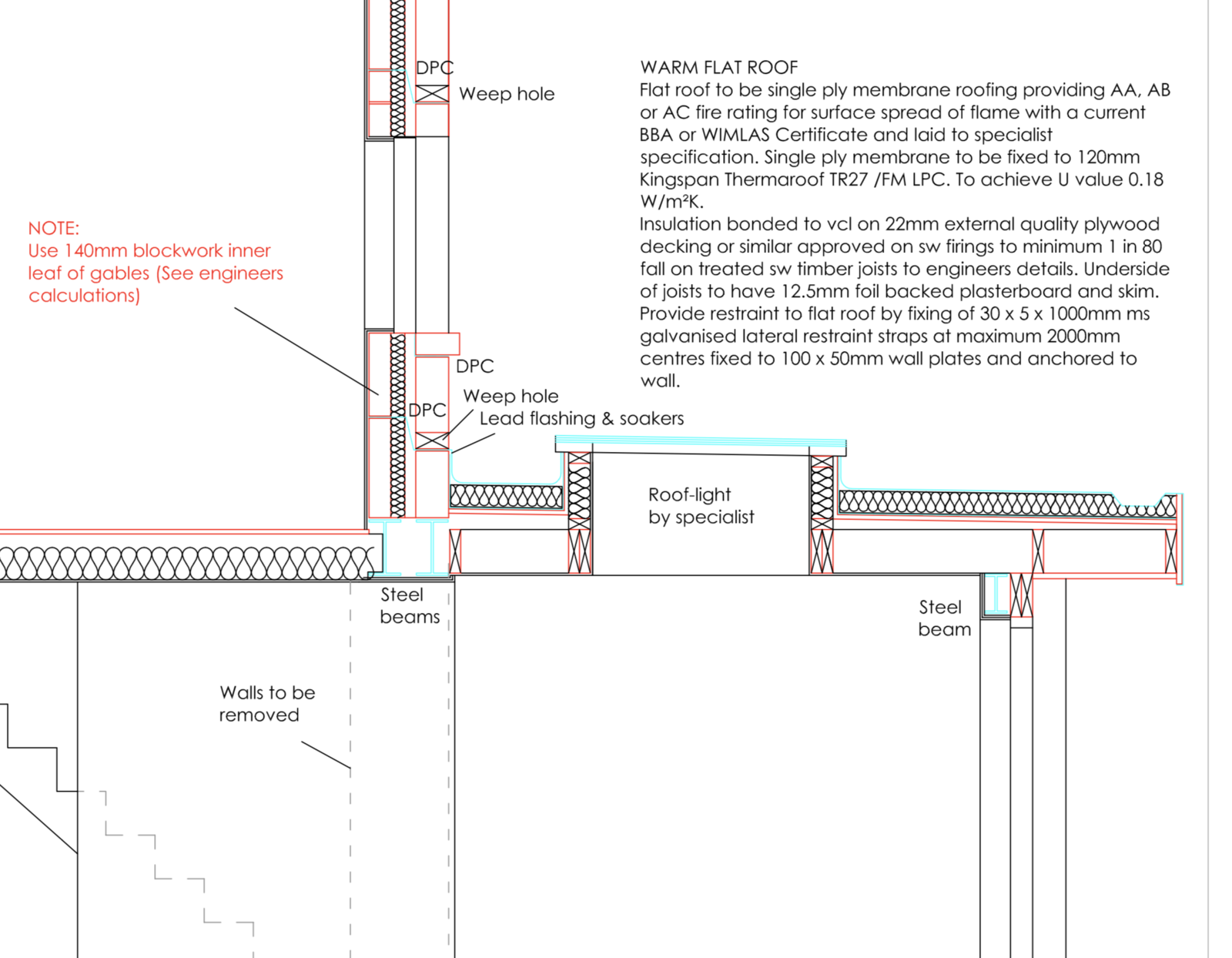

Are there any approved architect's details for this roof to wall abutment situation and if so has it been built in accordance with the approved details :?:
Yes drawings have been done see attached. Building inspector has been. beams are sat on conc stones onto of the block work columns
