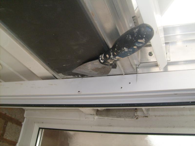

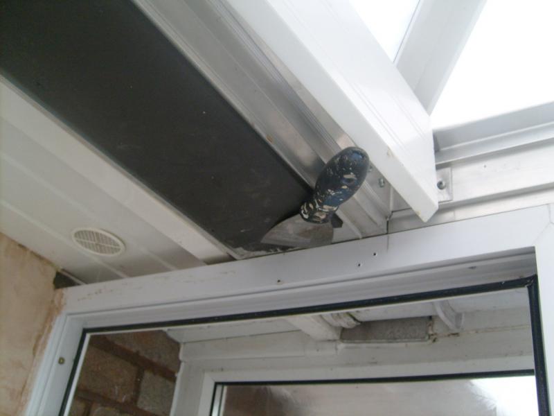

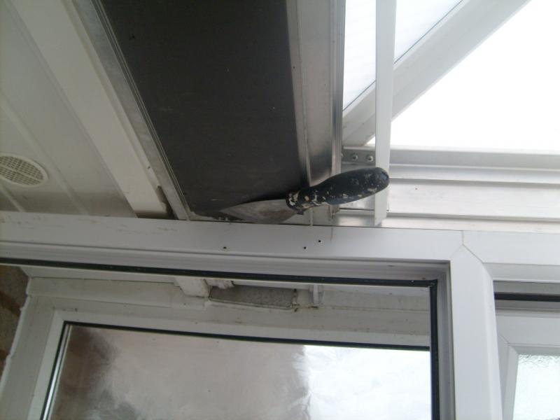

3 yrs on and 5 visits back from installer and my conservatory is still leaking! :cry:
I have took pics of where it is leaking from and it seems to me that the water is collecting under the box gutter (cappillary action?) and coming in where the plastic body meets it.
I have left the scraper under the box gutter to show where the water is collecting.
Anyone got any experience of this as it is driving me mad?
thanks
Are you positive that there aren't any leaks to the main roof as this will track down the felt and onto the soffit and possibly drip where you have the scraper? This is only if the felt has broken down of course.
Hi noseall
I really can't work out where the water can be coming from and nor could 3 other guys from the conservatory place who tried their best. They sealed the guttering and everywhere else too!

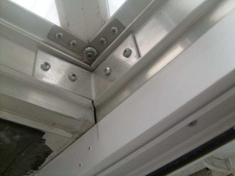

Its getting under where the box gutter meets the top of the window frame but I can't see the source
the mitred corner of the horizontal roof frames with the hipped angle meeting it. Psychic Nige says too many angles converging :idea:

And is that finished where the frame goes under the soffit?
Anyway, there is no magic cure here. If any entrance points are not obvious then its either a poor design - which will need completely altering, or a case of gobbing everything up and hoping for the best.
