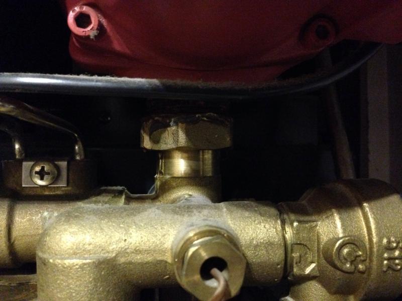

Hi everyone looking for a bit help
Very small drip started today and just wondered if some leak sealer in the heating system would hopefully stop it, obviously pointless puting it in if it wont come into contact with the leak
the nuts are in very arkward places to try and tighten, would be pretty much impossible to get in at the
Boiler is around 13 years old and been a brilliant one so far
The leak is occurring in either two places not quite sure which but very close together, both where the nuts attach to heating return and cold water inlet manifold
This is one of the nuts
And the othet

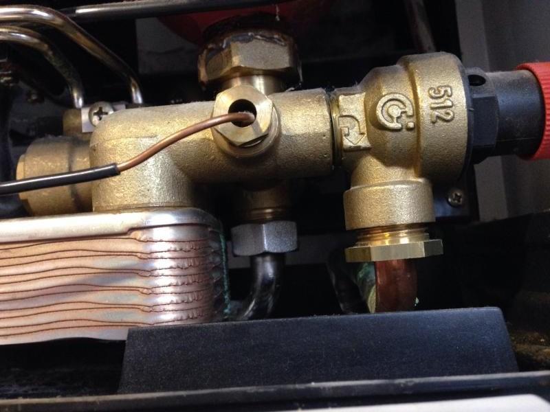

If your system pressure remains constant, then it's probably on the mains side, and adding leak sealer will do nothing. Isolate the cold supply, open a hot tap and then see if the drip stops after a while.
Looks like it's stopped, I turned down the cold water inlet so now the hot doesn't flow as fast and it's seems to have stopped
The hot water inlet is very hard to turn and won't turn off as seems to have seized on with none use for many years
Is it easy to replace this tap, it looks straight forward two compression nuts ???
Kev
you just need four seals for the plate to plate heat exchanger and maybe a few fibre washers

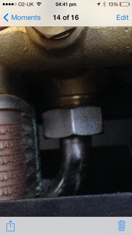

Right I've found out where it's leaking
The nut that fastens onto the pump the water is seeping out of there
When I loosen the nut will there be much water in the system that could come out
I'll isolate the cold inlet and heating flow and return but what else might come out approx how many litres
Also is it a washer that's possibly corroded inside this nut
