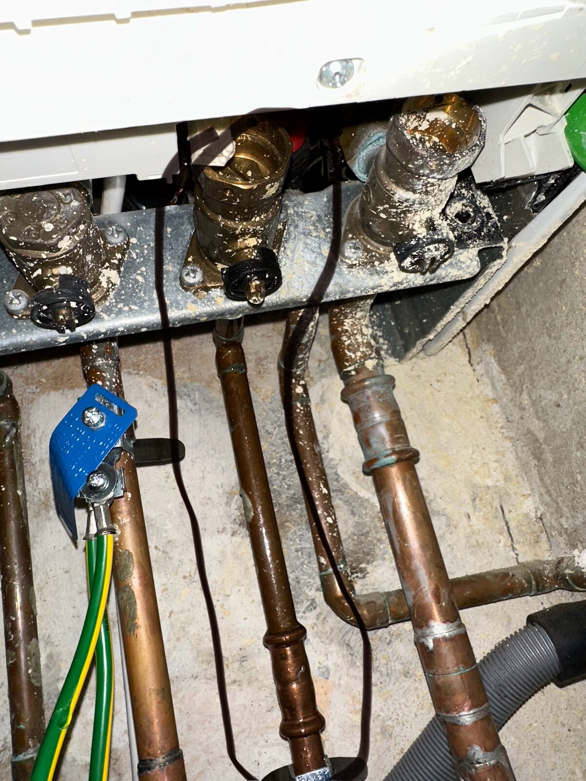

Got the electrician to come back and check everything, he checked and showed me the issue wasn’t with the thermostat. Now here is the issue as to why I am writing this post. Had another look at the boiler and I had seen a lot of condensation coming from the dcw mains in pipe and the dwc in connection to isolating valve.
I was able to identify the pipe names by viewing the manual for my boiler here.
The pipe in question is shown on page number 8 as item 44.

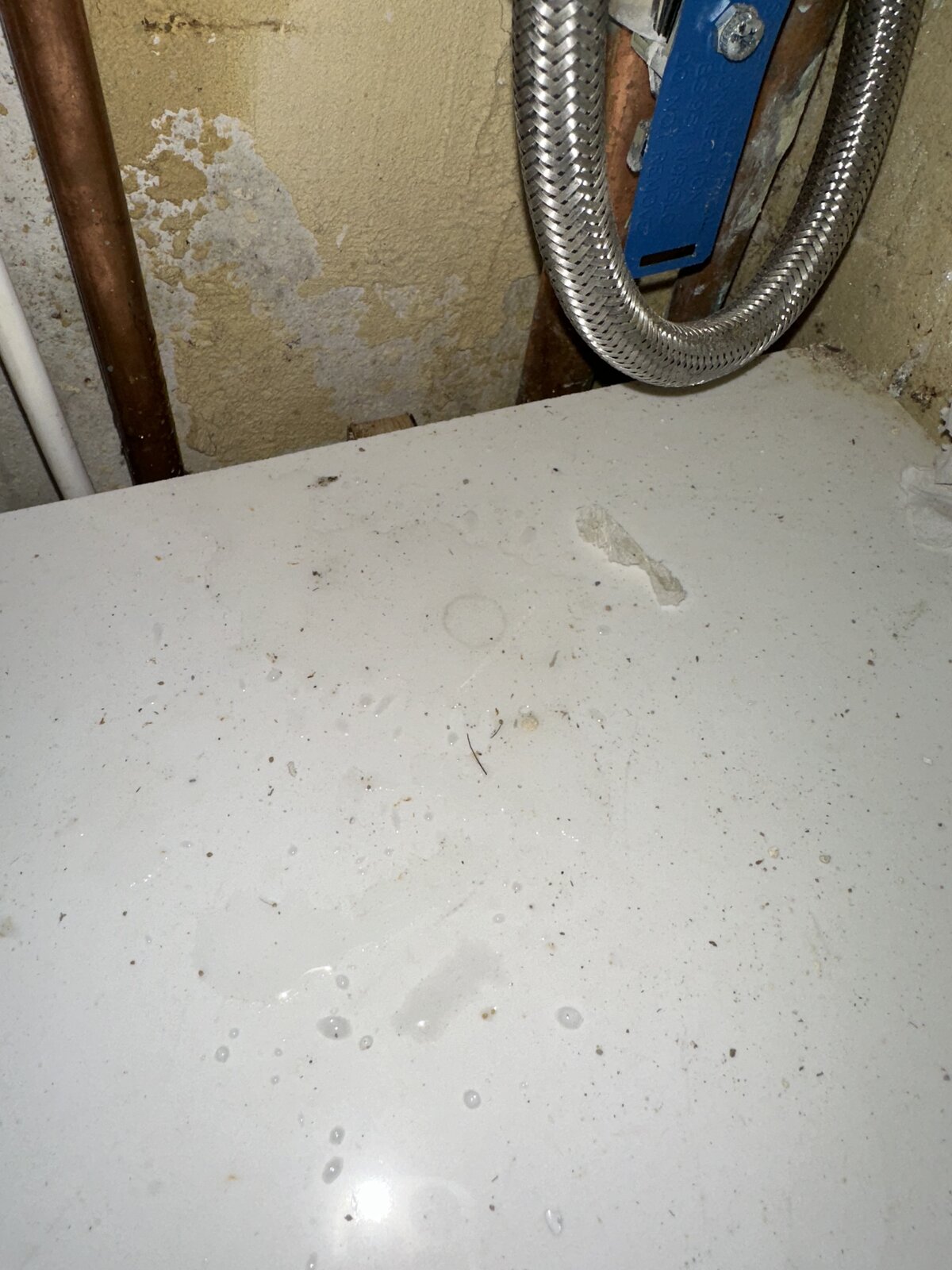

There is so much condensation that it’s dripping causes a small puddle below the boiler and onto the worktop. I have attached a picture to this post. It doesn’t showcase the issue in great detail but hopefully helps paint a picture.
As a result called the plumber back again, he reassured me that it’s just condensation and is normal, given him messing up the gas hob connection I’m now skeptical of what he says. He states that the condensation is normal and nothing to worry about. Looking outside I can also see water marks on the floor as a result of water leaking from the condensate pipe.

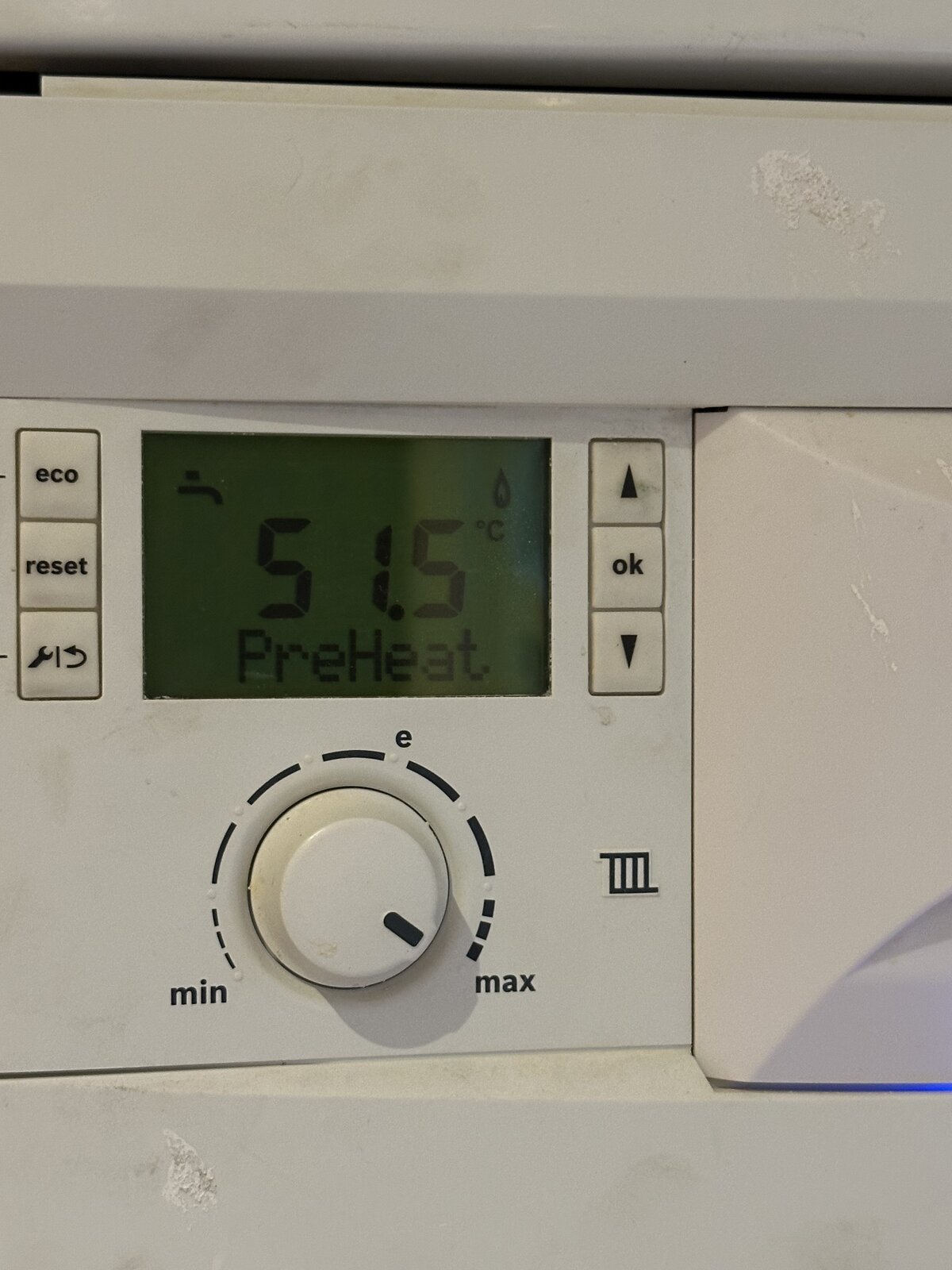

I ask him how comes the central heating is not turning on. He has a look at the boiler and states that the boiler is calling for hot water even though the taps are off (pic attached) and as a combi boiler prioritises hot water it never turns on the central heating as it thinks there is a continual demand for hot water. The hot water sign on the boiler is continually on. As the boiler thinks the hot water is required the boiler is on and makes an idle noise, it does however only get louder and steam come out the flute in large quantities when the hot water is actually turned on. He goes onto say that there’s either a problem with the boiler or a leak. He apparently proves this by turning off the dcw mains isolating valve which stops the boiler from thinking hot water is being called and subsequently the central heating turns on. I’m now stressing as we’ve just had flooring put down, bathroom tiled and kitchen units installed which if a leak is present ( which we don’t know where) would have to come up and be very expensive. I had assumed that the system being live before would have shown any potentially leaks. There was a few leaks actually identified at this point and rectified, is it possible that a leak could not show when a system is live but only cold water flowing through but then leak when hot water is flowing through the same pipe?
Also if this had been an existing issue he would have identified this when he came and serviced the boiler as the radiator would have not turned on at all back then as the boiler would have still assumed hot water was running.

When you say the hot water sign is continually on, do you mean the preheat as shown in your photo? If yes, then boiler stuck in preheat and likely heating the radiators up.
Turn the preheat off and then report back if the heating no water works as it should and the hot water symbol has gone off.

@Jagjourdan - the 3rd photo, is this showing “condensation”?

When you say the hot water sign isn’t continually on, do you mean the preheat as shown in your photo? If yes, then boiler stuck in preheat and likely heating the radiators up.
Hi there, the issue is the hot water sign is on continually.
Yes, 3rd photo shows condensation
Did you read my post? I edited as for some reason autocorrect on iPad changes the word is, to isn’t.
Anyway, Turn the preheat off and update please
That’s not condensation, that’s a small leak.
If preheat (DHW) is Off but the tap symbol still remains on the display then the boiler is detecting a "demand" for hot water and is trying to fire up to serve this.
The demand call could be due to a leak from the flow turbine or adaptor within the boiler. It is very common for these to fail and leak and is why Worcester retro-designed a bright green, rubber umbrella to protect the diverter motor.
If the leak is after the turbine (downstream) then this is likely causing the demand. It would seem the likely cause of the leak you are seeing below the boiler but it needs a repair engineer to confirm and remedy.

Get the boiler sorted first. Clean and dry it all up underneath (with power off) and see if it immediately starts to drip.
Condensation blossoms everywhere at the same time. If you look closely with a torch you can see the water droplets forming on several surfaces at once.
I'm not there but not convinced about the condensation theory!
Hi guys, thought I would close with an update. It was ufortunately as you all had assumed but I didn’t want to believe… a leak.
Luckily I had a rough idea of where it could be if it was leaking and I was right. Dodgy elbow used by the plumber. Leak resolved and boiler now operates as intended.
