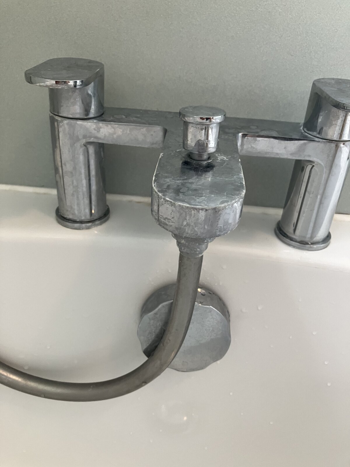

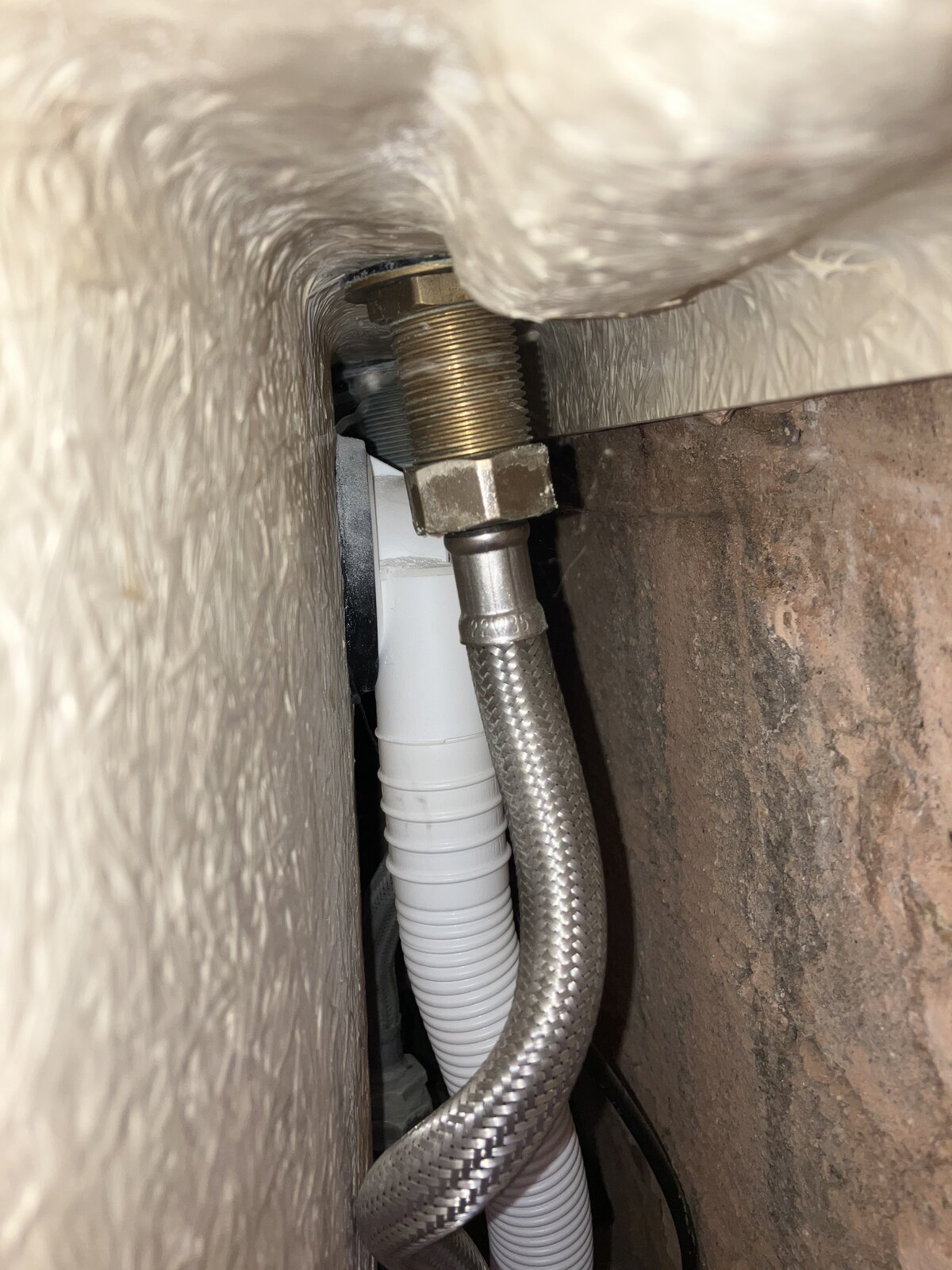

I have a mixer tap on my bath shower. Whenever we use the shower the water manages to leak through down through the hot tap. No leaks when the tap is on for the bath. Access is quite tight, I can see that the water has been dripping down it, but I can’t see what is causing the water to leak through

Can't tell for sure, but likely that:
1. Using the bath, water does not splash by the base of the taps.
2. Using the shower, water does splash by the base of the taps, and is running under the base of the hot.
If the above, try slackening the back nut securing the tap, lifting the tap and adding silicone sealant under the tap, push the tap down, apply silicone between the underside of the bath and the back nut, then tightening the back nut.
Thank you. I’ll give your suggestion a try. It looks like the ring around the bottom of the tap is a bit loose and water might be getting through there
In which case, first try just tightening the back nut. Turn the water off, remove the top of the flexible hose and use a box spanner to tighten the back nut. Spanner = Screwfix item 844RH or similar.
