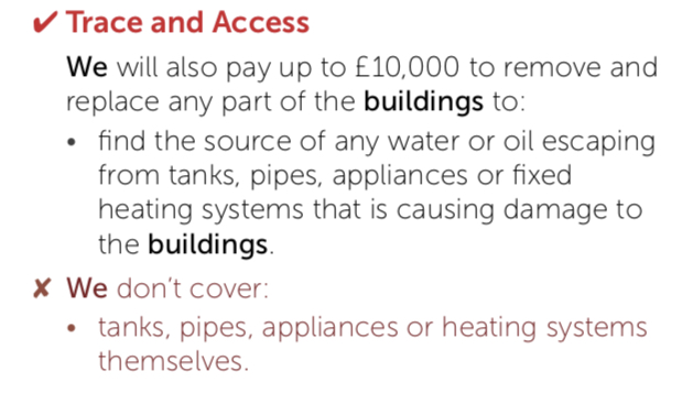

I'm with Direct Line, will have to see what cover is, phoning and asking though you are then commited and told them about it so would be logged expect if you go ahead or not with the claim?

Because it is insurance not a home maintenance scheme. So if, say, a pump leaks, that is in itself not covered. But the damaged ceiling would be. Presumably, if the water dropped into an electrical component then that would be covered.

OK I work as an Insurance Surveyor.
As posted there are several differences as to what is covered by various Insurers, same "basic Rules" but a difference of interpretation of the rules??
1/. Trace and access, if your policy has that as an "add on" The Insurer will pick up the cost of exactly that, at times the insurer will allow up to £ 5,000 other insurers will not go that far, it means that yes there is a leak [somewhere] in a wall behind the shower, T/Access will allow for the cost of ripping out the shower [whatever] to access the source of the leak. Then under the same clause it will allow for the replacement of the areas damaged during the T/Access.
If the T/Access £££ is not enough, the "normal" insurance cover should kick in. what the Insurer needs to know is what was the actual causation of the damage, where was the leak emanating from?
2/. OK say the plasterboard ceiling is totally shot with water damage, and at the same time the solid wood floor in the Kitchen has been damaged, all Insurers will replace both elements, because they have both been damaged by the same "Event" this can and at times does extend to the kick plates on the Kitchen base units.
3/. Now the "thorny one" the damage repair costs will be covered by the Insurer, but the actual £ 2.50 elbow in the pipework is not [notionally] covered, in practice unless the component is extortionately expensive to replace this tends to be ignored?? I have seen top down escapes of water from a cold water tank in a loft, the 2/3 floors of the property badly damaged to the extent of several dozens of thousands of £££ but the component that failed costs as above less than £ 5.00
OK Why is it thus?? The insurer can take the stance that the [failed] component elbow or what ever has failed because of old age, and / or wear and tear, both of the latter are very specific exclusions in All Policies.
