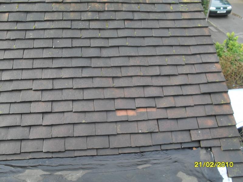

The extension has a flat roof and so the garage roof drops below the flat roof - hopefully this shows what it looks like :
There is a leak where the flat roof meets the garage roof.

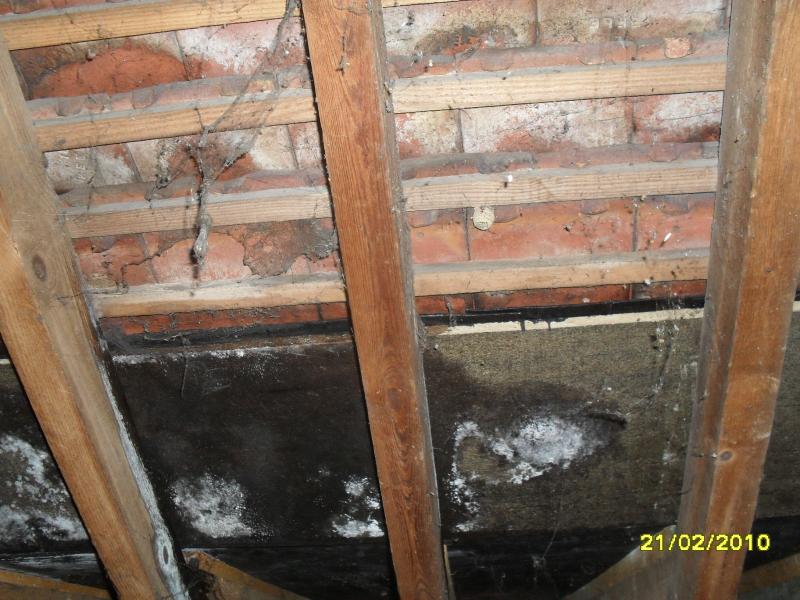

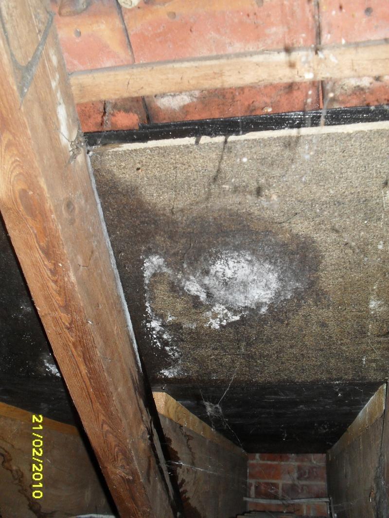

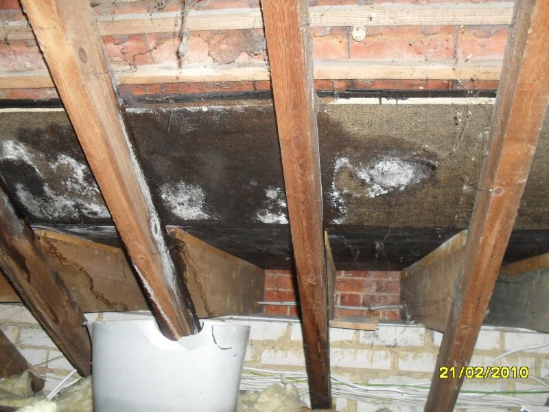

These pictures show this from the inside.
The garage roof has a wooden board under the tiles and as the pictures show a it is wet along some of the board (it is not wet across it's whole length) so there is clearly a leak.

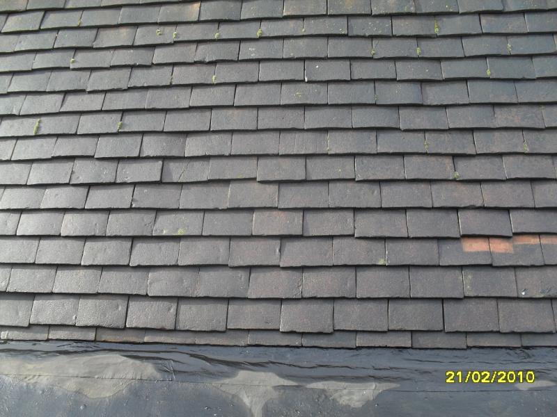

These pictures show the outside of the roof :
I'm not really quite sure where to start in looking at where the leak might be - any thoughts ?

Does the leak happen to coincide where those two tiles were recently put back into position?
Is that chipboard i can see? :evil:
I don't know when those tiles were moved - I didn't do it and as far as I know no one else has been up on the roof.
It certainly looks like chipboard to me.
It looks to me as if the covering has failed and something like flashband has been put in in an effort to resolve the problem i.e. photo 6 because looking at the first 3 photos it seems water is getting in where the flat meets the slope.
I'm afraid the only option is to remove and replace boards and refelt :(
Yes - the flashband was my (clearly poor) attempt at sorting this.

To be honest if the roof is chipboard then yes I would replace it all as a matter of course. The rafters don't seem to be that bad, they would only need replacing if they are badly decayed. Treating them would give piece of mind but once the source of wetness has been removed that will effectively cure any wet rot that is there. Replace the chipboard with either exterior ply or softwood boards.
Also I would replace all the felt too. It's all the same age so it's likely to fail again and you wont get a good result trying to bond new to old.
There also appears to be a cracked tile seven courses up and about seven tiles across to the left of the left hand shifted tile.
Looks split down the middle.

That's really well spotted ! I'll go up and have another more careful look to see if there are any more.
Could a split like that cause a lot of leakage ?
If I look from the inside would I be able to see evidence if there was a leak there ?

Hard to say, but i would replace any split or slipped tiles then eliminate them from your enquiries so to speak.
Not knowing exactly how long the damage has had time to act does not help. In some instances, problems like yours occur the second a builder carries out alterations that are subsequently bodged, thus having plenty of time to manifest themselves.

If a tile is nailed to a batten, use a slate ripper to cut through the nails.
I doubt any of those are nailed there doesn't seem to be enough evidence of the laths splitting.
I also like the eaves course, the roofers have simply pushed the bottom tile up and is not sitting on a lathe/batten!
The roof is a bodge through and through.
The more i look at it though the more i am convinced it is the flattie that is at fault though judging by the workmanship i can not be sure.
