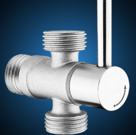

Hi all,
As a newb to plumbing I thought i'd start small by installing a bidet gun sprayer to the toilet cistern feed! It has been problematic. The only leak I have left (after several leaks) is between the T-valve and the entry to the cistern. Both are male 15mm. The cistern is your usual plastic job and the T-valve is metal. I thought I could use a 15mm female collar and just link the two together, but it hasn't worked. I think one of the problems is that there is no compression in the link anywhere; the two elements are touching inside the collar and I have used plenty (probably too much) teflon tape, but it is still peeing out either the top or the bottom of the collar, and I can't physically tighten anything any more without risking threading the plastic.
Any suggestions? Would a washer between the two inside the collar do the trick? Or do I just need to keep going with the TPFE tape!?
I've taken it apart and put it back together about 20 times now, so I'm coming to you guys in the hope of some solid ideas!
Any thoughts appreciated.
Can you post a pic of your T-valve, or a link to a pic?

Disconnect it, put the pipework back to the way it was and don't try to fit one. They aren't allowed to be fitted to the mains water in the UK.
That being said, if it's a plastic push fit fitting then the pipe probably isn't pushed into the fitting properly.
Thanks for the warnings - although a newb to the nuts and bolts I am aware of the legislation (or at least I thought I was) and I was under the impression that it is not a blanket NO, just that you have to have sufficient provisions for non-return. Both the T-valve and the flexi hose have non-return valves in them. I'll contact the PP and see what they say. At the moment it is all put back together as it was so we'll see what happens.

In terms of the original question, it is just a brass collar coming off a stainless steel male to plastic male. T-junction photo attached.

Non-return valves are still non compliant...nothing short of a break tank will suffice.
No further advice from me as you're willing to flout legislation and put you neighbours at risk from contamination (and I talk from
experience...seeing very ill people that have suffered from contaminated water).
Yes, you're absolutely correct but it's not about provision for non return, there has to be a physical air break on the flow to the outlet.
For what you are installing there needs to be Category 5 Backflow protection and NRV's don't provide that.
