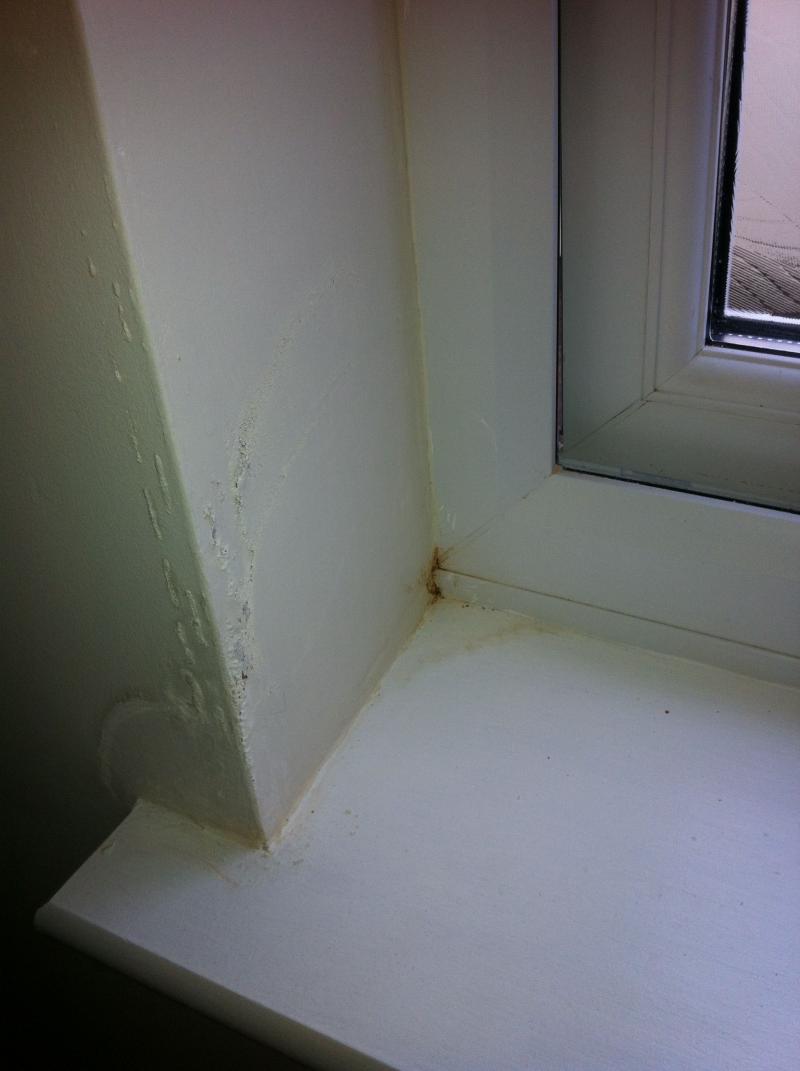

My parents have had a small double glazed window put in, and is now showing signs of efflorescence on the plaster in the left hand reveal (from inside).
It looks like it's working its way in in the bottom left hand corner, and the MDF window board is now starting to show signs of swelling, so it needs sorting quick.

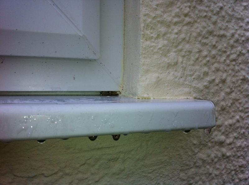

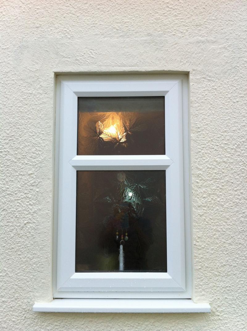

The render on the oustide looks basically sound with maybe a slight hairline crack about 2' above the top of the window frame. It's not hollow sounding either. There are no signs of any damp inside at the lintol or the top of the reveals, which I was perhaps expecting if it was leaking above the window.
The window cill looks like it is angled correctly so water will flow away. There seems to be a little cement in the bottom corner on the outside, and wondered if this could disrupt the drainage off the cill.

Hey newbee, it is obvious that the water is getting in around the window. I would get a tube of polysulphide, as opposed to silicon (as you can paint over it) The best brand is Geocel (it is made by Dow Corning) which also make silicon prducts,(Yes even the implants that women get fitted!!! ;) I digress, Put it all around the window and feather it in with your finger. Do you know if the window and cill were fitted as one item or seperately,as I think that the water may be coming thru the joint between the two. So chip that bit of muck out and fill the gap in between cill and window with white Dow Corning silicon. Also check under the cill and fill in any gaps..Let us know how you get on.. ;)
First step is to do as Roy says and see if that solves it.
If not, it could be that you have some bridging , it may be that the external render is coming in behind the frame to touch the internal plastering.
so the damp is tracking in.
The days of using a bit of damp course, and integral weather proofing everywhere are near enough gone with sealant being used in all kinds of places.

Ok, will pick some up and try it.
Is it better to use white or clear when between the frame/cill and wall?
I don't, but I'll ask the folks and see if they happened to be around when he was fitting it.
I would use white in both cases as you can paint over the polysulphide..
