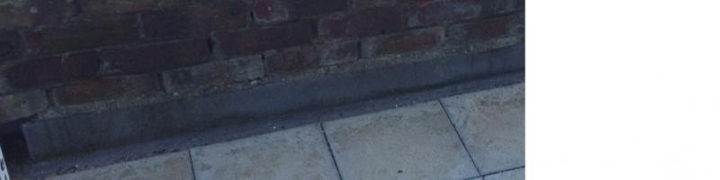

The flashing is just a raised tarmac or something similar.
Zoom this pic...

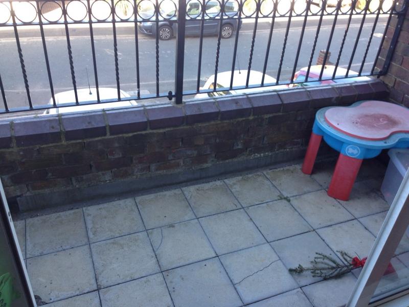

The drain is a typical roof drain (raised protruding metal mesh) at the outer edge (under the railing)

They look like paving slabs? If they are and they came up alright without falling apart (some are cracked already by the looks) they cane be laid on paving support pads. if there was enough height to do that.
You can also get 'promenade tiles' which can be adhered to asphalt or felt roof coverings.
