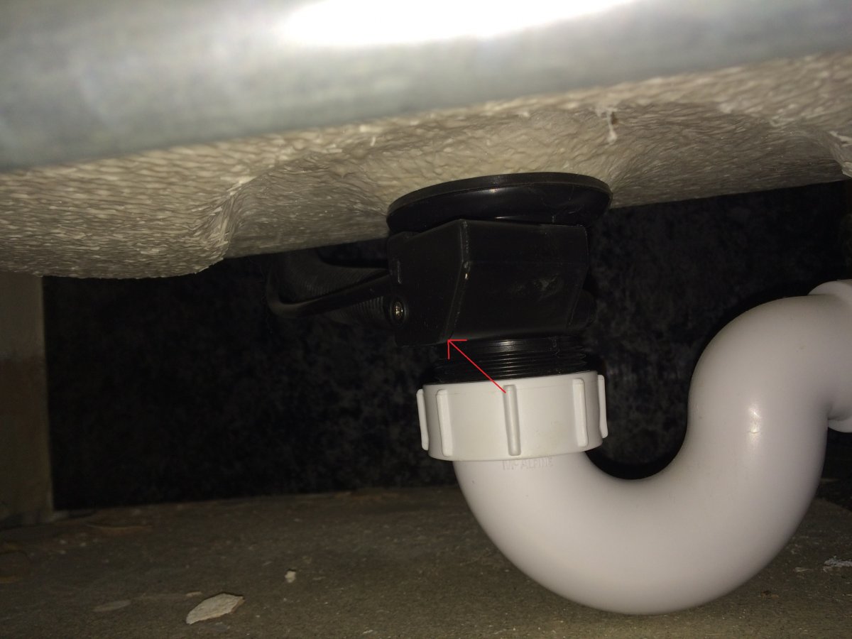

Came down the other morning to find water coming through the ceiling which is coming from the bath. I have the click clack type waste and it's dripping/flowing out of there.
I've uploaded a couple of images. In IMG_6171 I have highlight where the water is coming from. When I remove that small plate you can see that water is coming from that area. It looks to me as if there is a fault with the waste as I wouldn't have thought water should be escaping into that area?

You don't have a click/clack waste, going by that image you have a pop-up waste, which is controlled by an overflow twist button?
If so then replacing with the same should be ok.

You are correct, it is an overflow twist button.
I'm presuming that the seal round the plug hole and waste is just with a rubber washer and not sealed with silicone?
It does use a rubber washer to seal yes, I usually use the smallest smear of clear silicone on both sides of the waste just to take up any imperfections in the seal/bath - just a belt and braces approach.

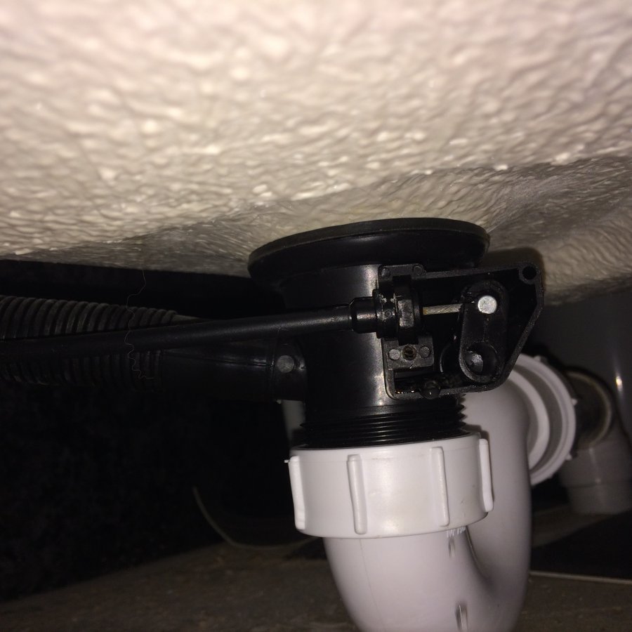

I can see the issue with it now. There are 2 small rubber washers on the arm that moves up and down to raise and lower the plug. These have worn down over time and are no longer water tight. I think it's a bit of a design flaw with this system as the bath is only 2 years old, or maybe I've just had a poorly made one (vitra). I think I will replace it with a normal waste/overflow and get rid of the twist system.

You posted the above whilst I was typing and beat me to publication lol! Vitra is a fairly decent brand. You could probably fix this with a couple of new washers and some "additional" proprietary product - silicone would be a good start (y)
It'll be the o-rings on the arm that'll have worn out, could have been a dry seal and that's caused premature wear. Sure they could be replaced but I'd still change to a traditional type chromed plug or a captive flip plug waste, those would be my choice. You will need to change the overflow too but it should all come together as pack.
