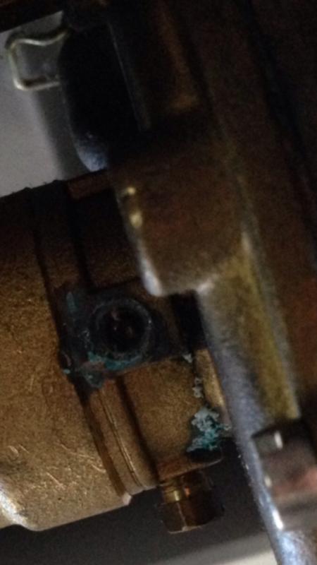

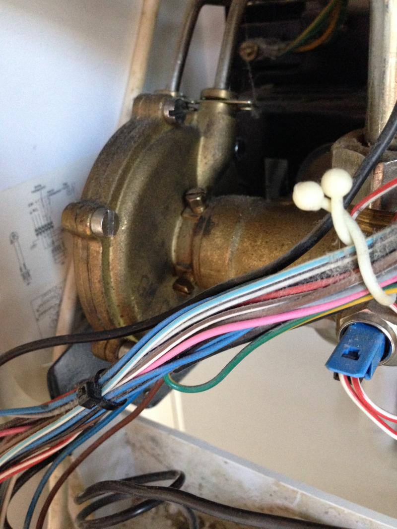

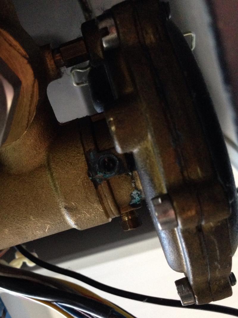

Hi evryone
Small problem regards to a drip at the bottom of the diaphragm housing when the hot water is stopped, if i dont run the water it doesnt drip
Combi is a vokera maxin 24e
Just wondering what i need to fix either new complete housing or just a new diaphragm
Kev
Top view of housing
Bottom of housing
Close up, its dripping from what looks like a hole / screw/bolt hole???

i already have that service kit at hand, is it easy to replace them
Do i need to drain any part of the system
