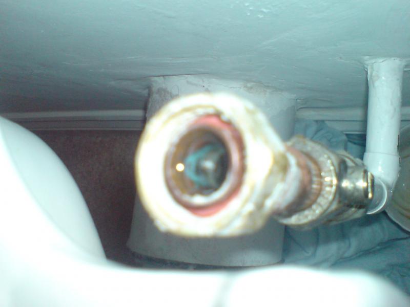

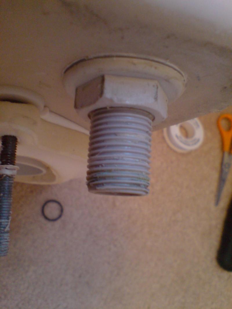

Plastic thread at bottom of cistern
Copper water pipe

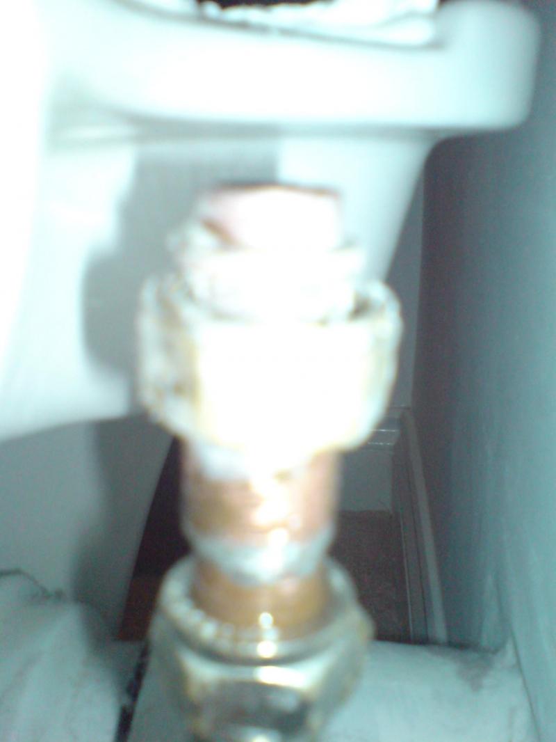

Copper water pipe with fiber washer replaced

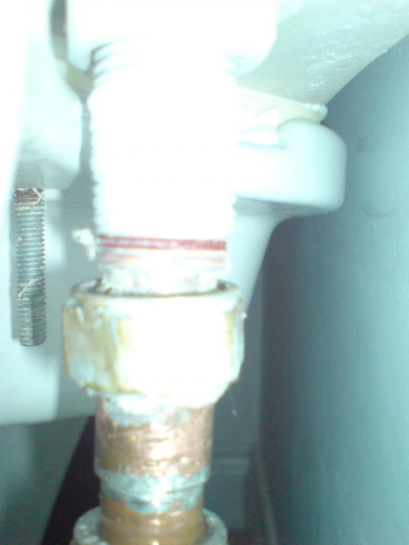

Pipe and thread connected (with nut not done up)

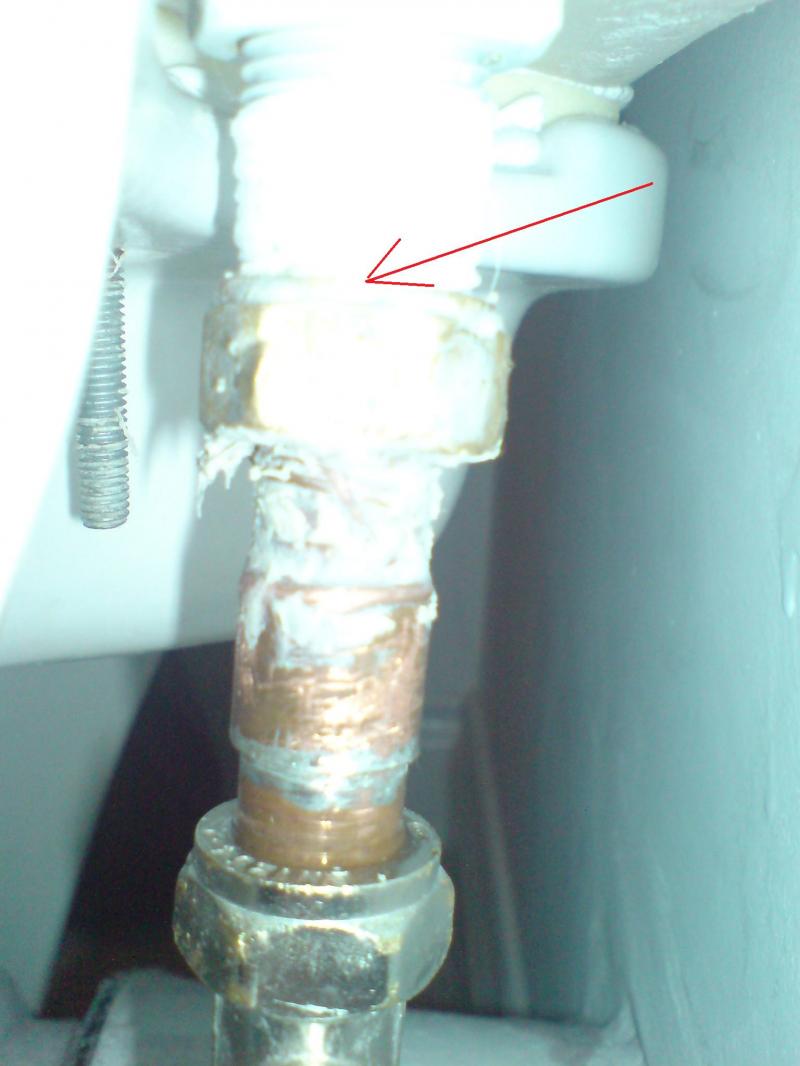

Pipe and plastic thread connected, nut done up. Red arrow indicates leak point
its quite poss the leak is coming from the plastic thread.
people over tighten the nut on the thread and stretch them and they split between the threads.
if it is the case then a new float valve.
