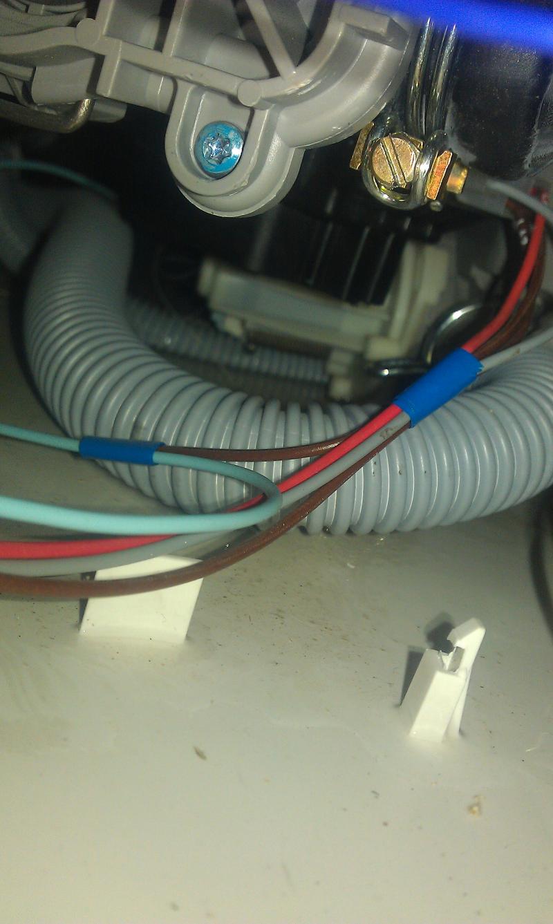

Hi, This is a picture i took after removing the left hand side panel. If you zoom in you can see a whiteish looking pump which seems to sit right under the centre of the dishwasher.If you look one the left side of it you will see a drip.Is it the pump leaking or a pipe attached to it and would it be difficult to remove??
Any ideas please?
many thanks
Not a particularly informative picture.
The main place a wash pump leaks from is the shaft seal on the pump. It is normally evidenced by water leaking out and or a build up of scale etc between the end of the motor and the pump (running down the back of the pump itself). Also more scale in a place directly underneath the pump in the base.
