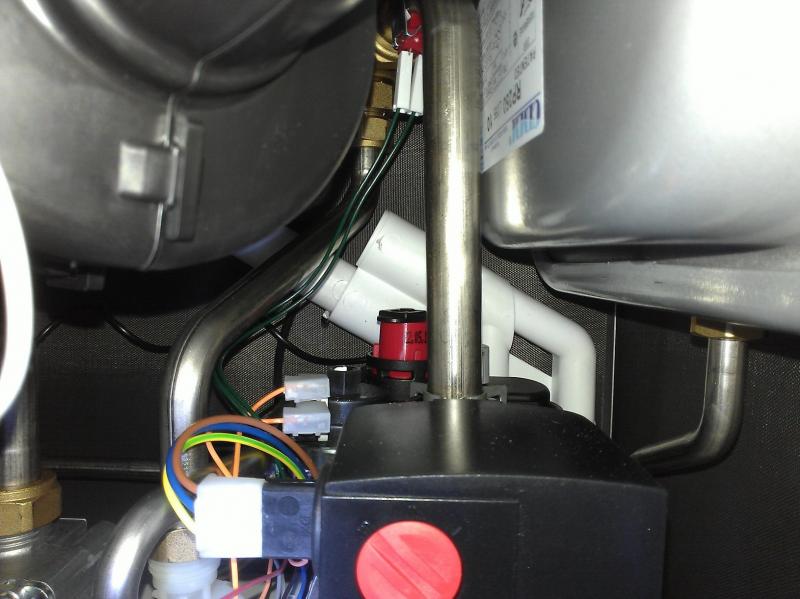

Has anyone experienced "leaking" on the new Ferroli Modena condensing boilers? We installed one this afternoon and liquid began seeping out from the bottom of the case via the gas tube. On opening the boiler we found that the tube which (probably) collects flu condensate is just stuffed into a plastic trap and the overflow level (seems) to be above the joint hight. In the attached photos you can see the trap and a drip near the joint.
The condensate tube is not blocked, if you blow into the tube the condensates seep out of the joint.. no condensate ever makes it out of the tube..

if condensate is dripping out of there i would be more worried about poc's leaking out of there, crap boiler so really what do you expect

We always put in carbon monoxide / gas detectors regardless of the boiler unless the client refuses (non to date). We have never had a problem with POC with Ferroli, at least with the old boilers..
'Old' and 'Ferroli', now there's two words you rarely hear in the same sentence; they don't normally last long enough to get old...
Your CO detector isn't going to help even a tiny bit in this instance as the leak is inside the sealed bit of the boiler, so it'll never pick it up. You may well get flue gas recirculation causing the boiler to burn incorrectly, however
