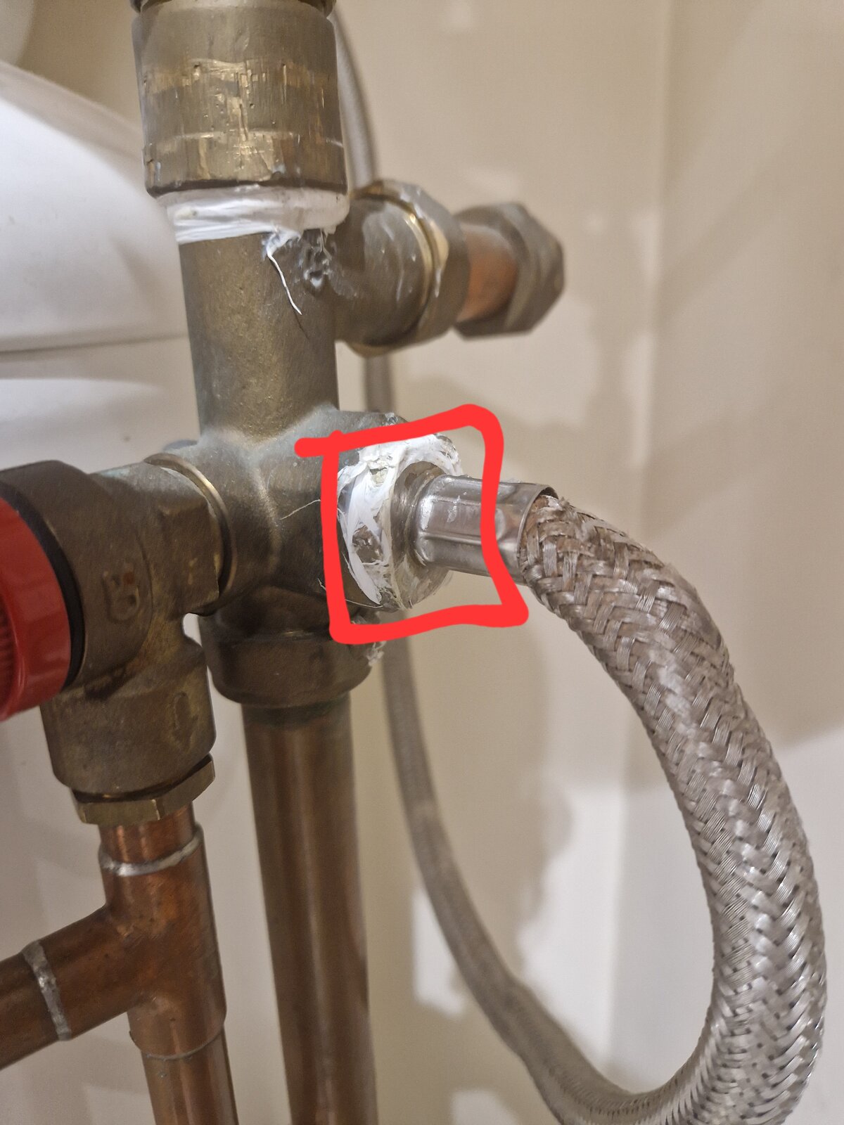

Hi,
I have a small leak on one of the fittings attached to the central heating pipework.
Before I pay for a plumber to come and have a look is there anything I can do myself to try and repair.
It's literally only a few drops of water a day nothing major.
The tank that's rested on the hot water cylinder is a Zilmet 110 ultra pro expansion vessel. Its the connector for this that is leaking where it goes in to the pipework.
Been at the property for a few months and this was how we found it when bought. Looks like it was previously mounted on the wall but for some reason it's been left like this.

I am not a plumber... but I suspect that the washer in the flexi pipe has failed. Possibly over tightened.
I think you need a new flexi pipe, they, the washers, are not designed to be replaceable. The PTFE visible in the photo will not cut the mustard.

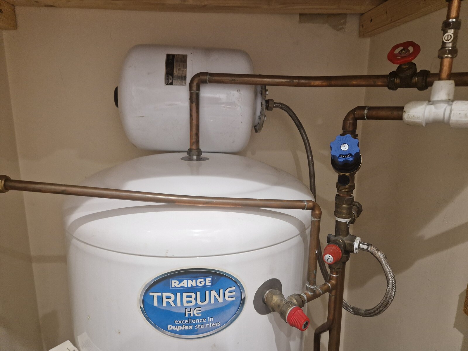

1. Its not central heating pipework, it for your unvented hot water cylinder.
2. That white expansion vessel should be properly supported. It will be (roughly) half full of water and half full of air, the air being used to compress and take up the expansion of the hot water when it heats. If it fails, and they all do in time, it will become full of water. If it then falls off the cylinder it is likely to rip that flexible hose out of what is your combination valve, leading to a flood.
3. Only those with a current G3 accreditation are allowed to work on those cylinders, by law.
4. I'd suggest you get a G3 qualified engineer to give the whole thing a service, replace the flexible filling hose, and remount the expansion vessel to the wall.

Honestly, I wouldn't be saying this if I didn't think there was any risk that the flexi was ok. It's kinked, bent and doesn't exit the crimped end of the fitting properly so I wouldn't trust it. It is the case though that it could be fine for years or go anytime soon but I've learned that flexi's aren't worth taking a risk on until it's checked by a qualified bod.

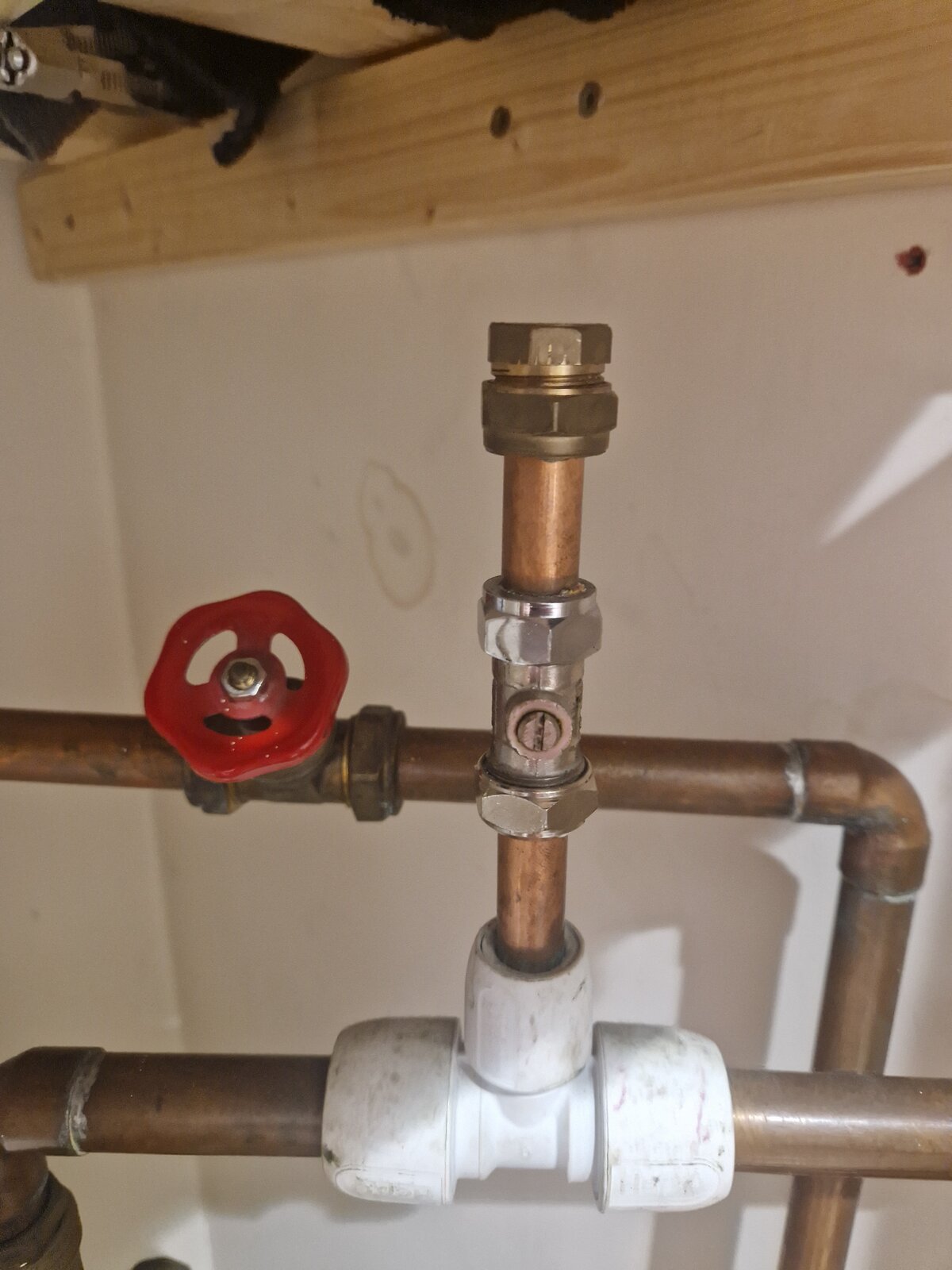

There is nothing coming in to the tee fitting.
It does look like the white cylinder sat on top of this tee fitting before but that's only a guess.
Who knows what the previous owner done to be honest.

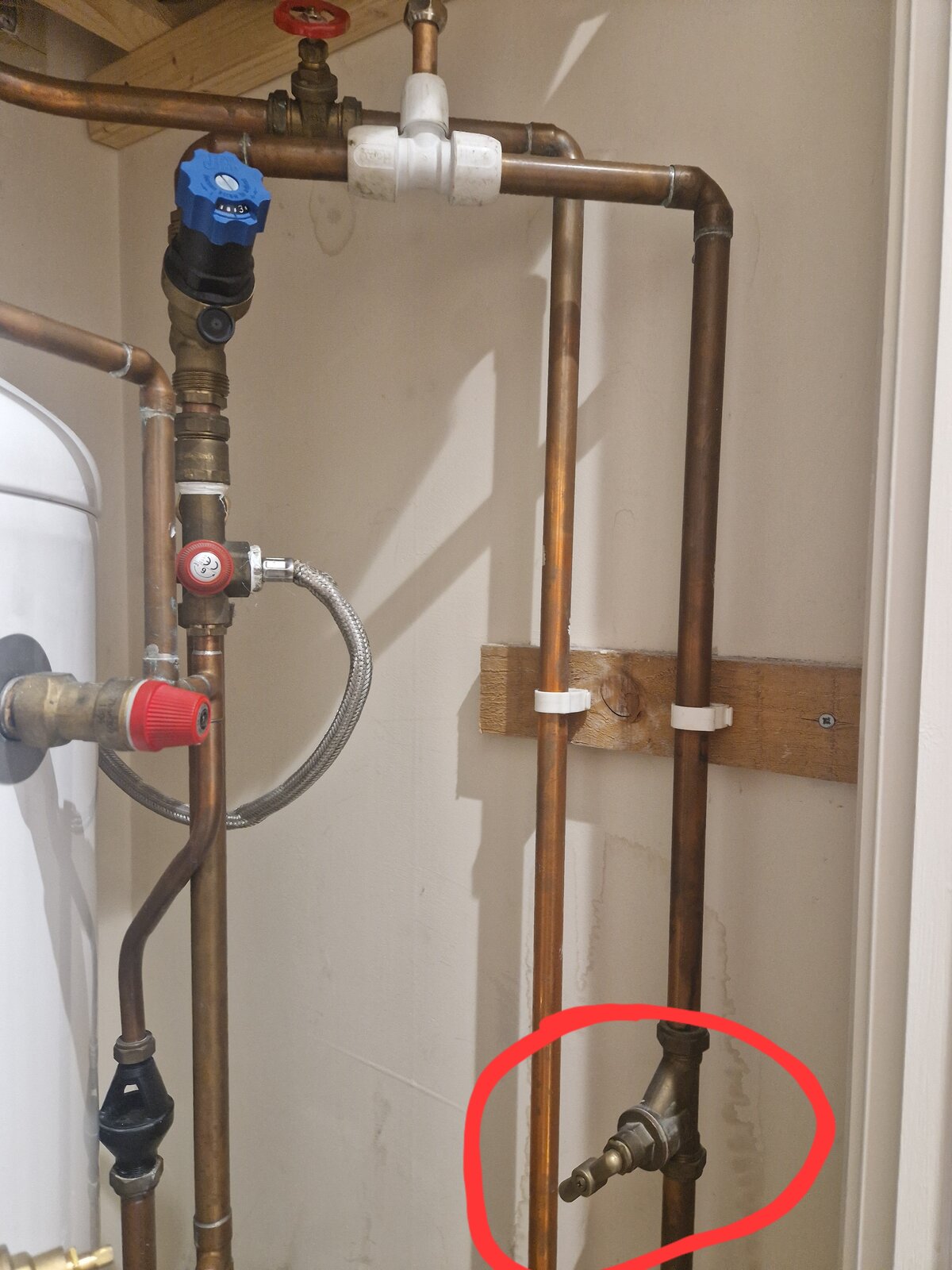

Different plumber come today. Said the white cylinder is full of water and it should be half water and half air.
He going to order a new one and fit it correctly.
Hopefully be sorted soon.
