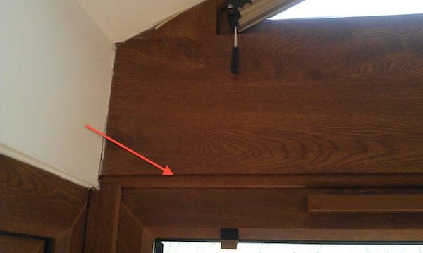

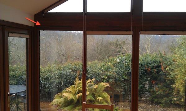

Our back room is leaking again from the horizontal cladding between lower rectangular glazing and upper glazing at the gable end.
Externally it appears built using all uPVC with a tiled roof. Docs suggest a steel frame was used (there is one glazed end, one part glazed and one solid wall):

The leak is from the point marked by the arrow. If I can get the cladding above off, then I should be able to see the path of the incoming water much more easily.
I cannot see how this piece is fixed - both ends are in plaster, but does appear to be attached somehow along its length.
What is the standard way of fixing this piece? If I apply some force with e.g. paint scraper, is it likely to come off without breaking and bend enough to clear the plaster at each end?
I don't really want to start taking off outside pieces of uPVC this time of year...
Any helpful suggestions gratefully received! [/img]
A pic from the outside will be useful, that trim was put on before it was plastered and it looks like a bit of flat board which is probaly glued on but i think you should look outside first, maybe pop the unit out and check the drainage on the triangle unit before you start pulling trim off
The trim is under the plaster by about 5mm each end (3m long). Does appear to be glued on (I can stick a knife in from the underside and feel resistance in various places - uneven and what appears to be clear silicone/glue bits comes out). Thin silicone bead on top edge (I presume to stop inside condensation from upper windows dripping down).

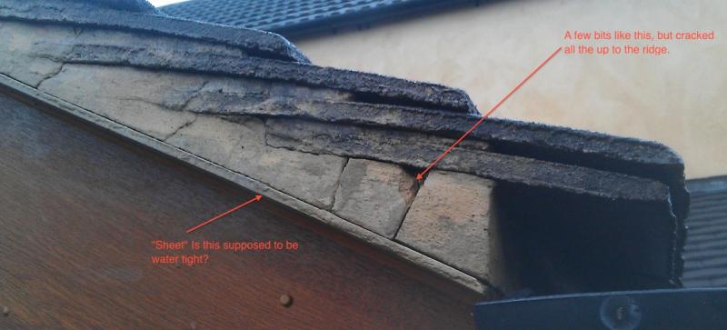

Here's a photo of the verge:
I'd though previously that the sheeting (looks a little like old asbestos style stuff) and the felt were part of the waterproofing. Apparently not - only the tiles do this - they all look in good nick.
But the verge (which I'd ignored thinking it is on top of the sheet) is cracked all the way up to the ridge.
So I'm wondering if this is letting in driving rain, soaking through the sheet, down the end rafter past the last DGU, and then eventually down inside the house.
There are a couple of small uPVC cladding panels on the outside that I can pull off to take a look at this path
The verge looks in poor condition anyway (to my eyes), so will get a roofer in to take a look at replacing the verge cement.
