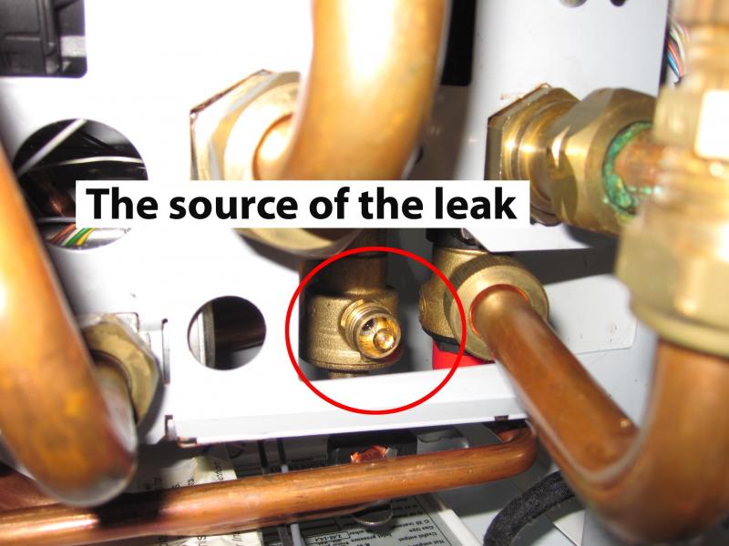

Hi all, I wonder if any kind person could identify this part for me. The combi started leaking this morning and drips away until the heating or hot water is used... then the water pours out! Please see the pic.

Looks like a drain down point, they sometimes have an O ring on them
boiler will need to be drained and the plug removed and resealed ;)
That picture is deceiving and I think that's the fill vave assy leaking and there is a modified fill loop kit for that.Was the pic taken looking up underneath boiler?If so then easy to replace.The boiler has to be depressurised and cold supply turned off b4 commencing work.
Yes it is from underneath, the bottom of the pic is the front of the combi, just behind the rad temp knob.
Then that is what's leaking and a modified fill valve assy is required.Part number is probably in spares list in Installation instructions.Sorry I don't have those details,but others on the site may have.

the new ones leak just as well as the old ones :LOL: i've stopped fitting the modified disconectors now, they take more room up in the van
Many thanks for all the advice and help everyone.
The leak has stopped and all is bone dry, a gas fitter friend said he had a lot of these in the last few days, brought the bar pressure up to 1.5 and all is fine for the moment... no drip and more importantly no water gushing out when the heating is turned on!
I'll get the mod done though to make sure we don't get this problem in the future. Funny thing is the rads are MUCH hotter now that they were before this leak occurred. I wonder if there may have been an air lock in the combi?
