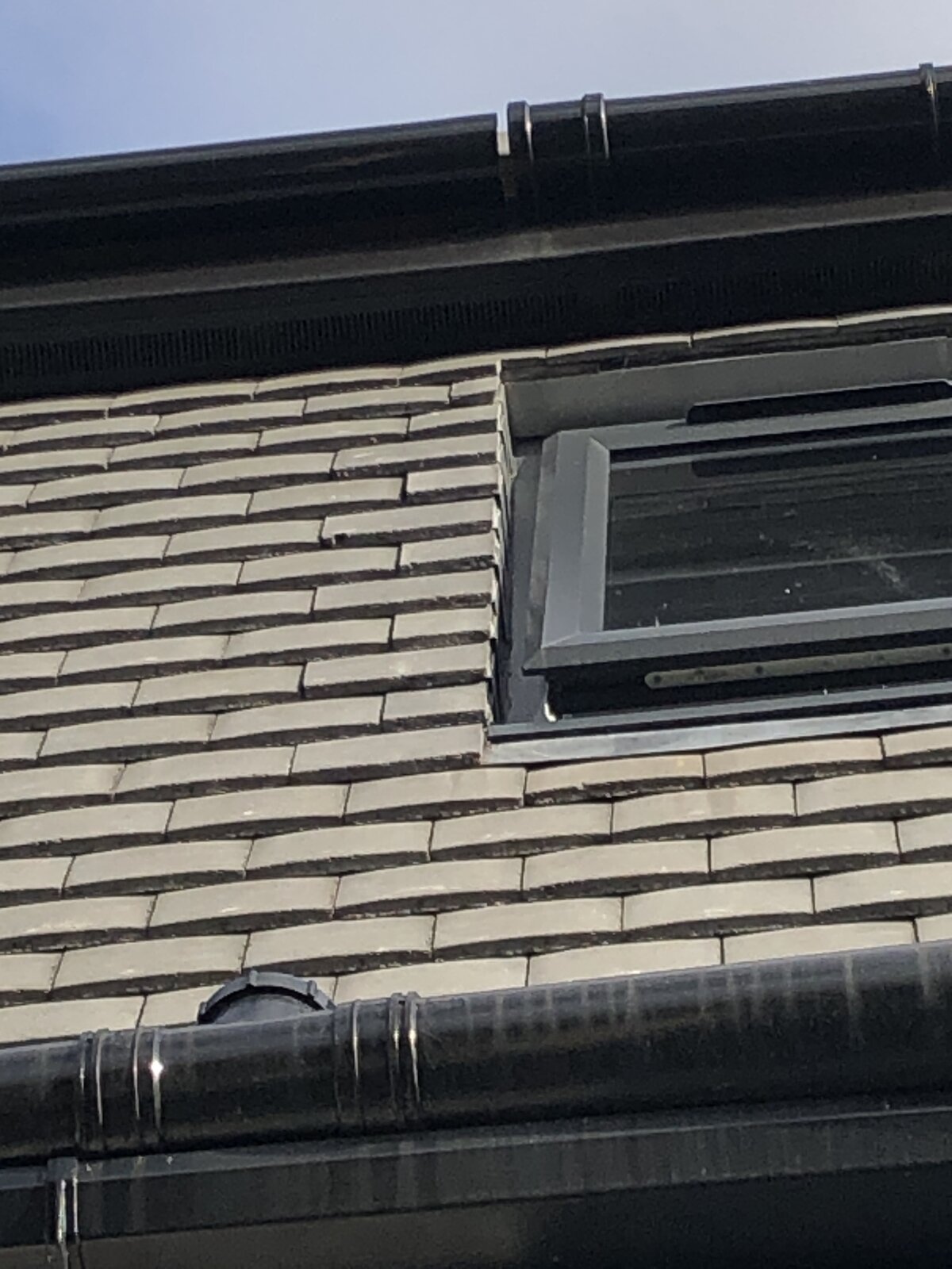

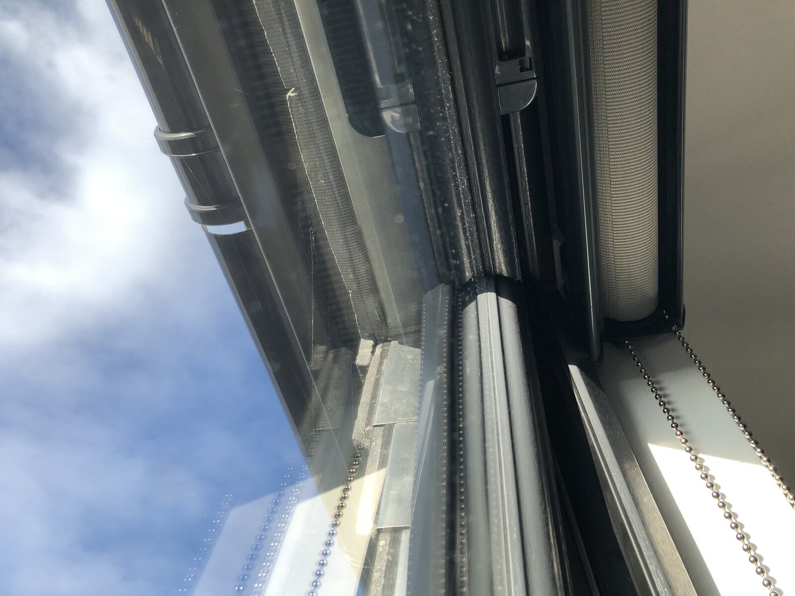

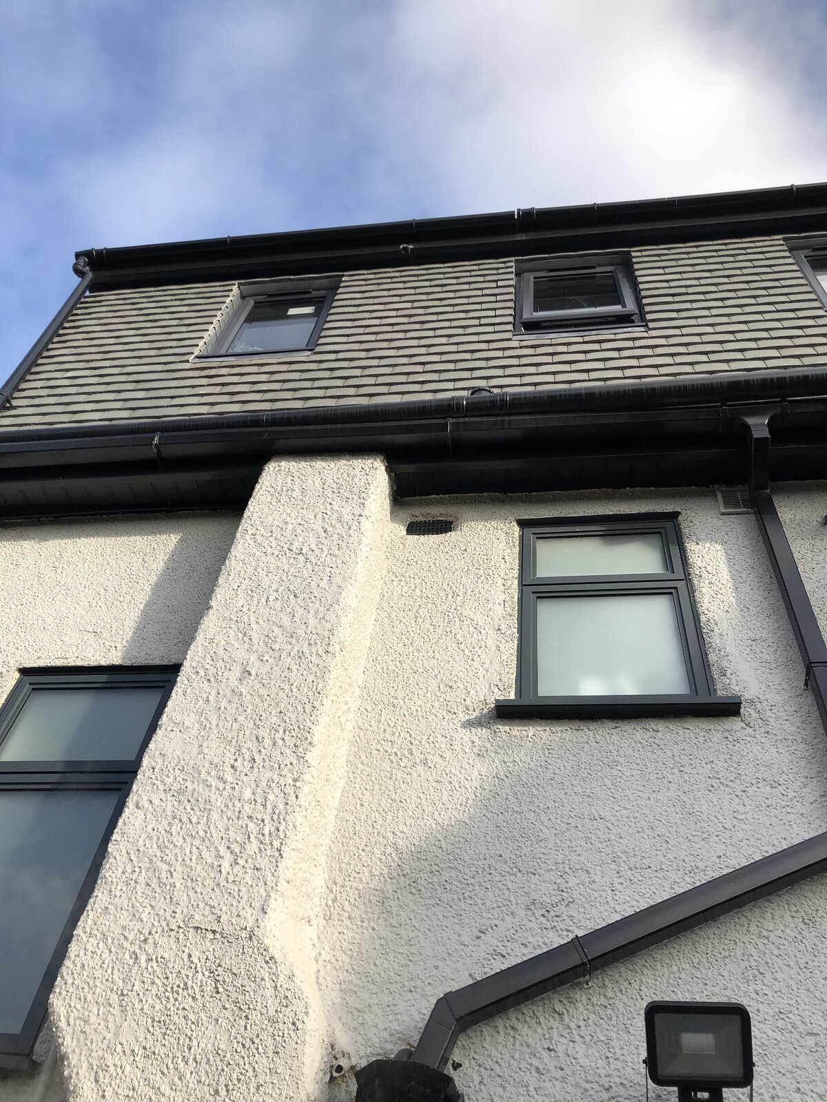

Loft Guttering done 2022
Currently leaking
My questions 1/ has the split on guttering happened due to expansion or contraction due to weather conditions or poor materials?
2/ Does the leaking area require a bracket or new length of guttering ?
Any advice / help on this problem will be appreciated.
Photos attached
Thanks in advance

Quite possibly due to expansion although may not have been fully into the union so looks like it just needs sliding back into the union bracket. As the left edge has the outlet it may be the right hand side that needs moving so unclip it from the other brackets and make sure it is inserted up to the mark shown on the union and snap it all back into the clips, job done.
