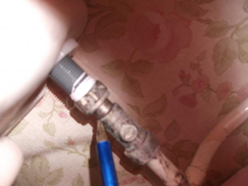

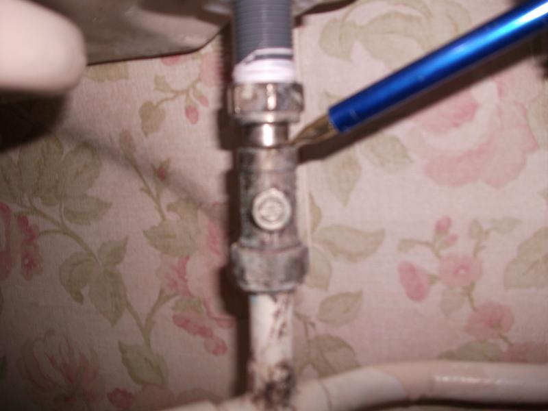

Gents,
I have noticed what I've called an isolation valve which feeds the WC refil unit leaks. I thought it was something simple like a replacement seal however on putting a new unit it I've noticed the problem seems to be a bit more annoying! If you look at the attached image, in particular where the screwdriver is pointing, this is the part of the valve where the water seeps through. Although it looks like a solid body I've noticed it seems to be threaded, I came across this by accident when tightening the bolt above the screwdriver position. I can't really see how to tighten that area. Can you advise on the following;
- What do I need to do to stop the leak?
- What parts will I need and what should I ask for? I went to my local B&Q but had little success.
Many thanks in advance for your assistance, Kevin. :?:
Looks like a telescopic one. I've not come-across these before so i'm not sure if it can be repaired.
If it was me i'd drain the cistern and lift the body of the syphon up an inch so you can get some better fittings in. Personally I wouldn't bother with an isolation valve (so long as you can turn off the stop-cock easy enough) the gland on it will only leak at somepoint!
I think the easiest way would be to use a flexible tap connector (15mm / 1/2") any plumbers merchant or DIY shop will sell them
If you haven't got much space you might have to use solid fixings like a 15mm by 1/2" tap connector, with a 15mm compression socket and some pipe.

my bet is that it is not telescopic, but just a bog standard (excuse the pun) isolation valve tap connector, but it is leaking from where it joins the ballvalve. I notice that the thread is sealed with PTFE. This is incorrect as the seal is made between the fitting and the wc valve by a fibre washer. No PTFE should be used as the water should never get that far, and even if it did PTFE would not stop it leaking.

agree with m1key00 someone's poss also butchered the thread on the fill valve so wrapped it in ptfe.

Reference the tape, I can remove that easily enough and I've put in a new fibre washer. It just doesn't seem to be leaking from that point. If you look at the section below the nut which joins the ball valve it 'looks' like a sold piece of pipe into the main centre section of the valve, however when tightening the nut i noticed this section turning in unison with the nut and actually revealing a thread above the centre section of the valve? If that makes sense. I think there is something 'heath robinson' about this valve and whoever built the house had to furnish something to cover a gap between the ball valve and water pipe bigger than they planned for.

just get a new service valve.
apart from the leak that ones had it's day.

Thanks everyone for your guidance, I purchased a replacement service valve today and will fit it on Friday.
regards, Kevin.
Replacement service valve fitted earlier today, all seemed to go well just leaving it a few days to check for leaks. Noticed that the old valve, pictured in the first post, where the screwdriver head is pointing is actually a threaded joint and it was that that was leaking. The replacement unit is a solid body at that part so hopefuklly no more failures in that area.
