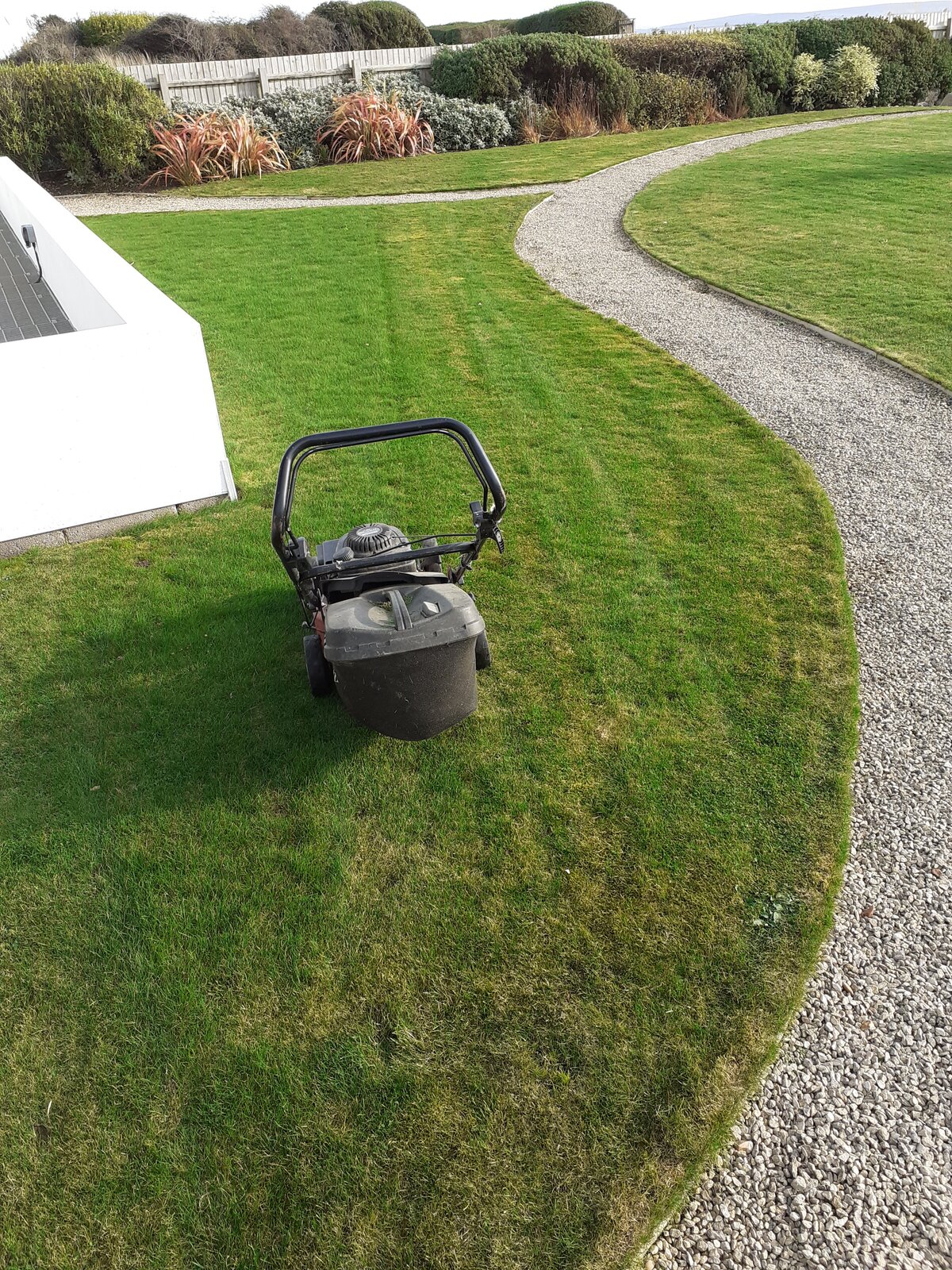

Got petrol leaking out the front and my petrol tank keeps emptying. Is the petrol hose got a leak? Blue circle i
n photo

Completely impossible to tell from the photos. All that can be ascertained is that it's a red mountfield .

This mower has no petrol tap (its not a bad move to fit one) so the leak is either from the petrol supply pipe or more likely the needle float valve in the carburettor is passing slightly.

So for mower repair man not worth trying to do myself?
I have a similar mower and replaced the fuel pipe earlier this year. Its literally a 5 minute job. Remove the air filter and Having drained as much fuel as possible turn the mower on its side. Remove the clip at each end of the pipe and pull the pipe off. As the Haynes manual says reassembly is a simple matter of reversing the instructions.
