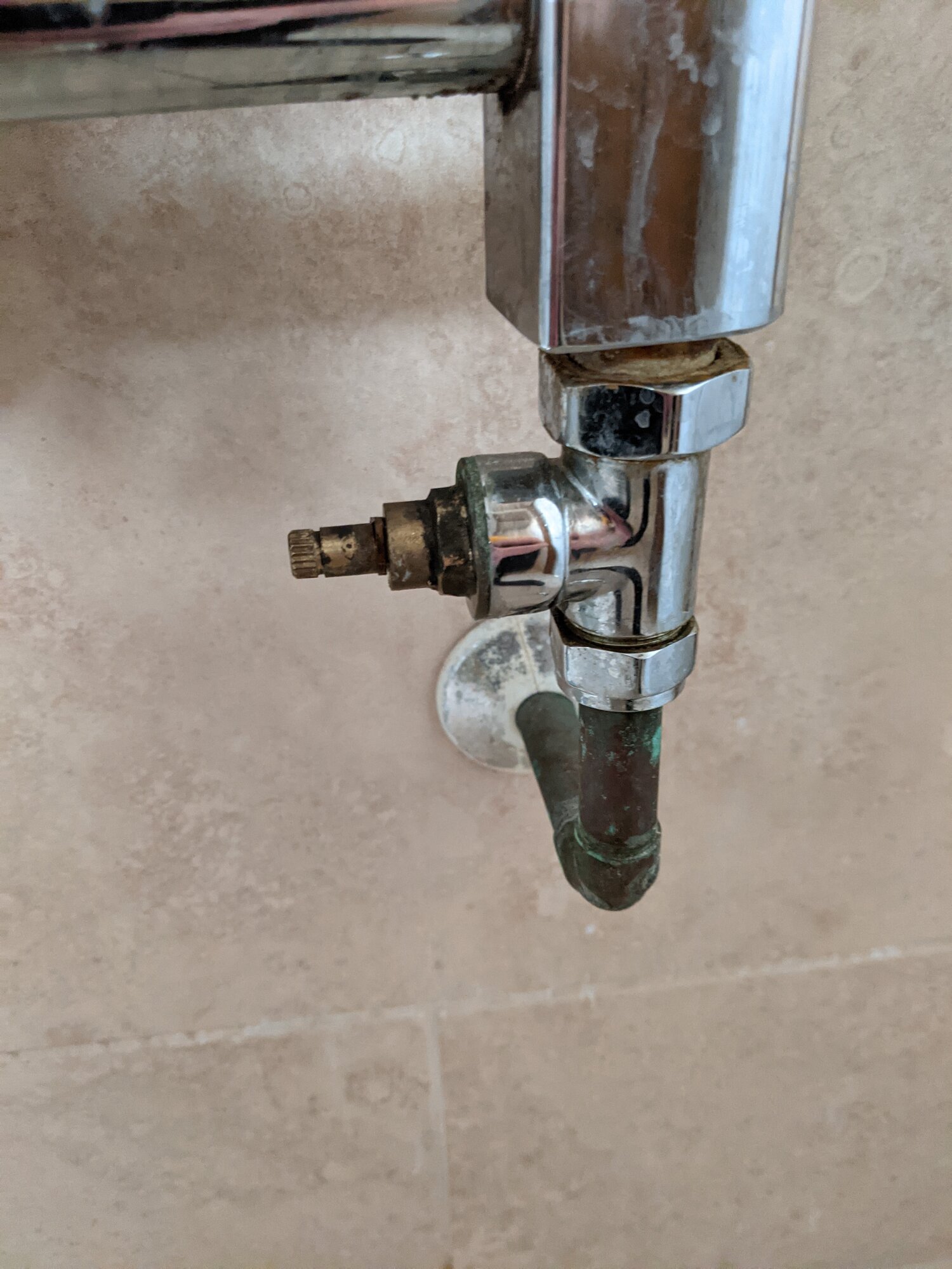

Got water dripping out of the lockshield valve on a towel rail. Only way to stop it is to fully close the valve, and so turn the radiator off. Anything I can try, or will it need a new valve?
Have you tried tightening the gland nut?Got water dripping out of the lockshield valve on a towel rail. Only way to stop it is to fully close the valve, and so turn the radiator off. Anything I can try, or will it need a new valve?
There's usually a male threaded piece (called a gland) which goes over the valve stem and screws into the body, with hexagon for tightening. Beneath it there is gland packing, tightening the gland compresses the packing on to the stem and stops leaks. But I can't see the hexagon for sure on your photo, so possibly it's a different type.Sorry for the stupid question, but which part is the gland nut?
OK as I said I wasn't sure from the pic, but having magnified it I see. Is that just a circlip I can see?It doesn't have a gland nut !
