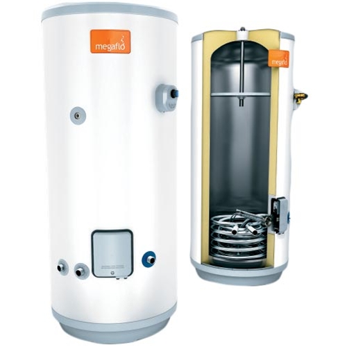

Sorry to butt-in on the thread but I'm having problems myself and am trying to understand how these Megaflo systems work. I'm going to try to regenerate my air gap when I get the opportunity. I wanted to do it today but will probably have to wait until tomorrow. Can either of you please explain what the floating baffle actually is, what it does and how you would know if it has failed?
Also, my cylinder is a 15 year old Megaflo CL210 and I can't find any reference to a floating baffle in the handbook. Is the baffle a recent addition and is it possible that my tank doesn't have one?
Thanks.
The baffle is as per the below picture - it's a disc the width of the internal cylinder which separates air (above) from water (below). When the water is heated, it expands, and the baffle is forced upwards, compressing the air above it and maintaining a constant water pressure in the cylinder. The air above the baffle escapes over time, and the air gap should be regenerated as part of the cylinder's annual service, but as only 0.0000000001% of unvented cylinder owners actually bother to get their cylinder serviced annually, this is almost never done, and some owners find they have to regenerate more frequently than that anyway. The system also stops working properly if the baffle gets stuck, dislodged, punctured, if Uncle Bob's birthday is on a Tuesday, or if it remembers its former life as a giant frisbee. As you can probably imagine, any hint of limescale on the dip tube it is supposed to slide up and down will immediately render it even more useless than it already is. You will then require the services of a G3-registered person, who can fit some bits to circumvent the need for the baffle, although if you're unfortunate enough to have a baffle that is stuck right at the top of the cylinder, you'll find that you start using more energy to heat your water, because the hottest water will sit in the space above the base of the dip tube/baffle guide (normally filled with air) never actually being used because it can't get out, so you have to turn your thermostat up to compensate.
