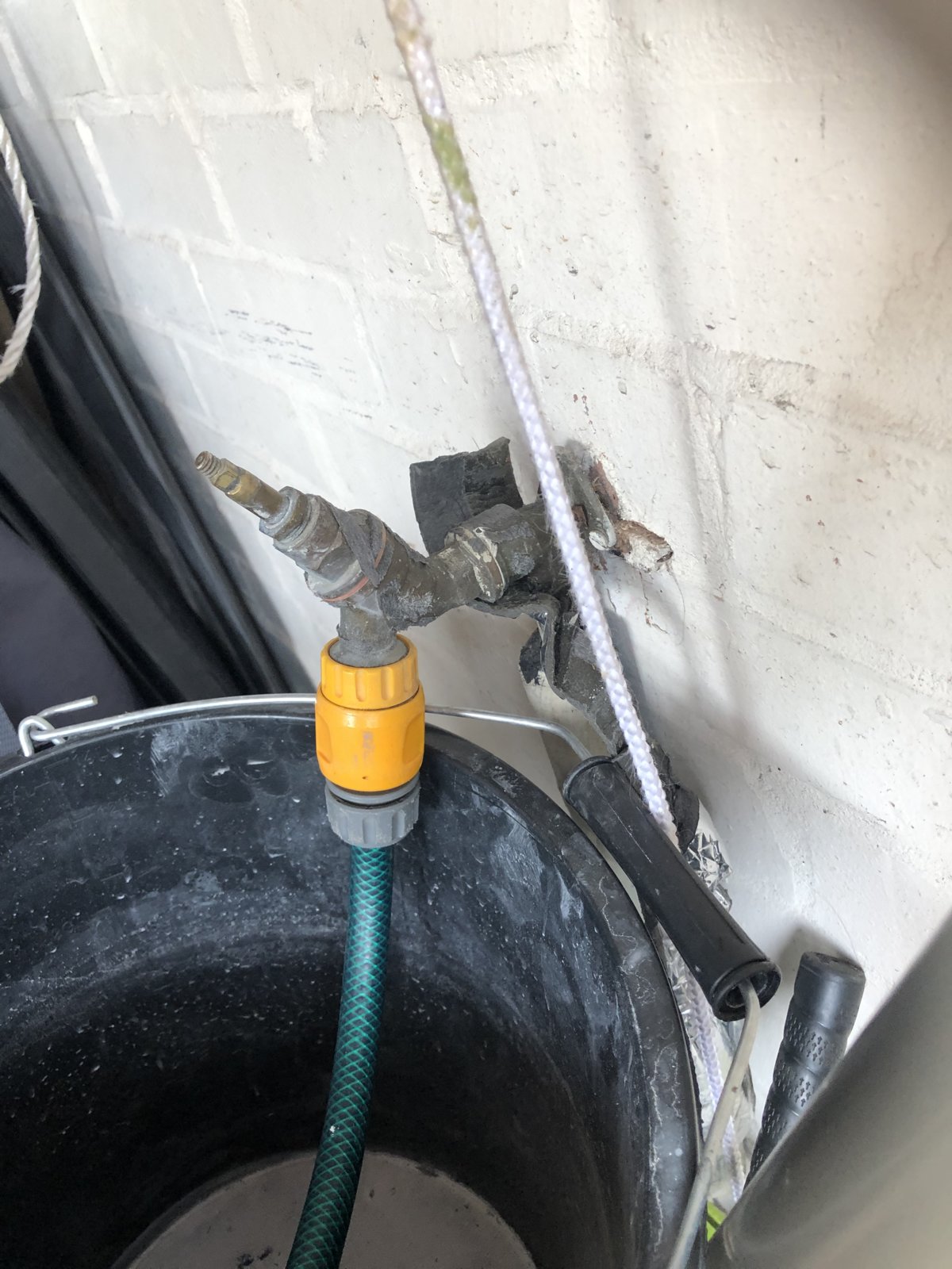

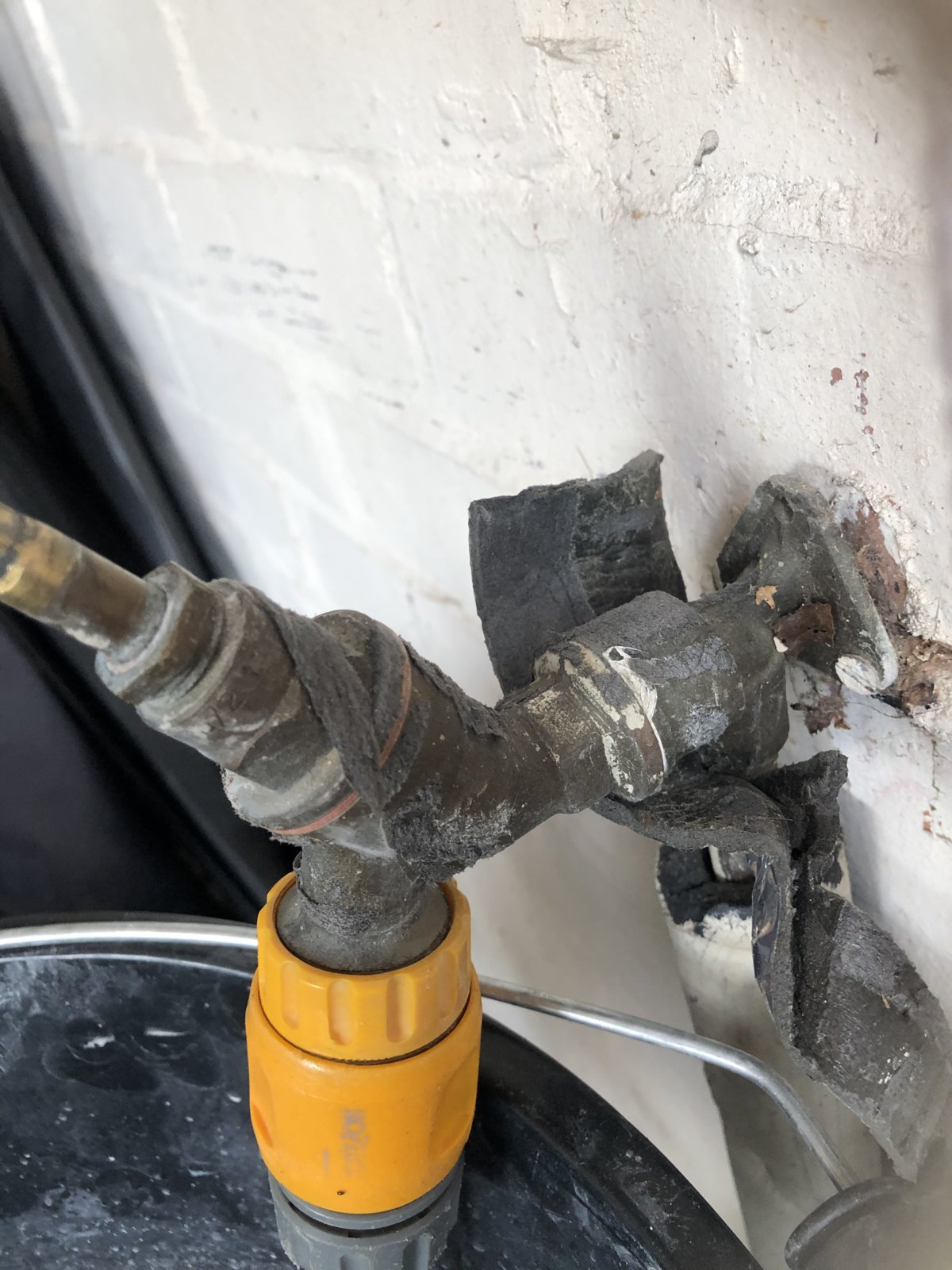

I have an outside (in my garage) that is leaking from the top on the screw.
First two pics are the current tap.

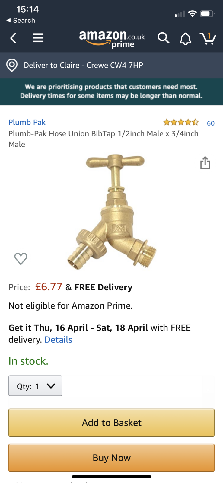

I’m thinking beat to just change the tap? Looking to order one but is this the just the standard one like the amazon picture please?

It sounds like it's leaking around the spindle in which case it just needs the gland nut tighting down or re-packing otherwise...
If the plumbings been done correctly there should be a double check valve feeding the tap on the inside so check first.
A check valve in the tap often freezes and fails which is why the water regs stipulate it should be inside.
If there's no checkvalve inside then by all means get a checkvalve tap but protect it from freezing.
A checkvalve is required to prevent contamination of the drinking water by backflow (there are recorded incidents...one regarding a poison being syphoned back from a watering can AFAIR).

I thought the wording was more where practicable to be inside, if renewing or replacing? Yes to prevent backflow/back siphonage from ponds as well. If you can get one on that pipework, then I’d fit one inline.
The point being he may already have a double check valve inside the property and it would be futile to fit a tap incorporating one.
I do agree with that but it is a DIY forum. You can get one with a DC valve from Screwfix for the same price as the one without on Amazon. It will do no harm fitting the DC valve one.
Oh FFS. He might already have a double check fitted on the pipework but you seem to be advocating he just shoves a double check tap on for want of not checking the existing setup.
I've lost count of the taps I've replaced whereby the doublechecks have frozen and are stuck solid for evermore.

ive ordered the first one recommended. Hope that is still correct :LOL:.
