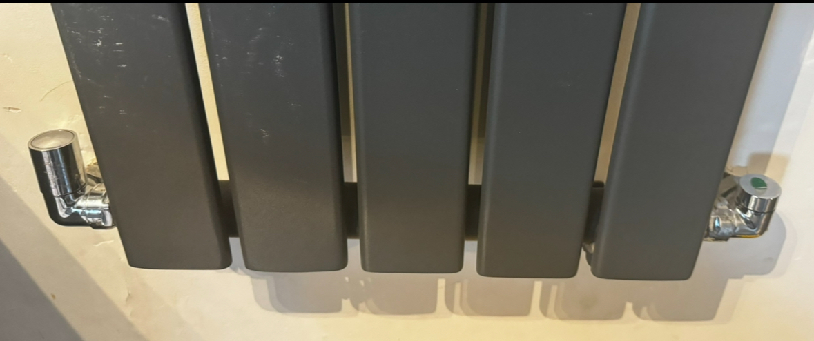

Hi,
Our radiator started leaking from inside the valve cap, have turned the valve fully clockwise to shut off but still dripping.
This is the only type of valve we have like this in the house and I have no idea how to actually get to the valve, tried lifting up the cover and seeing if the top cap comes off but doesn’t appear to?
Does anyone know how to access the actual valve inside and on this type of connection?
David

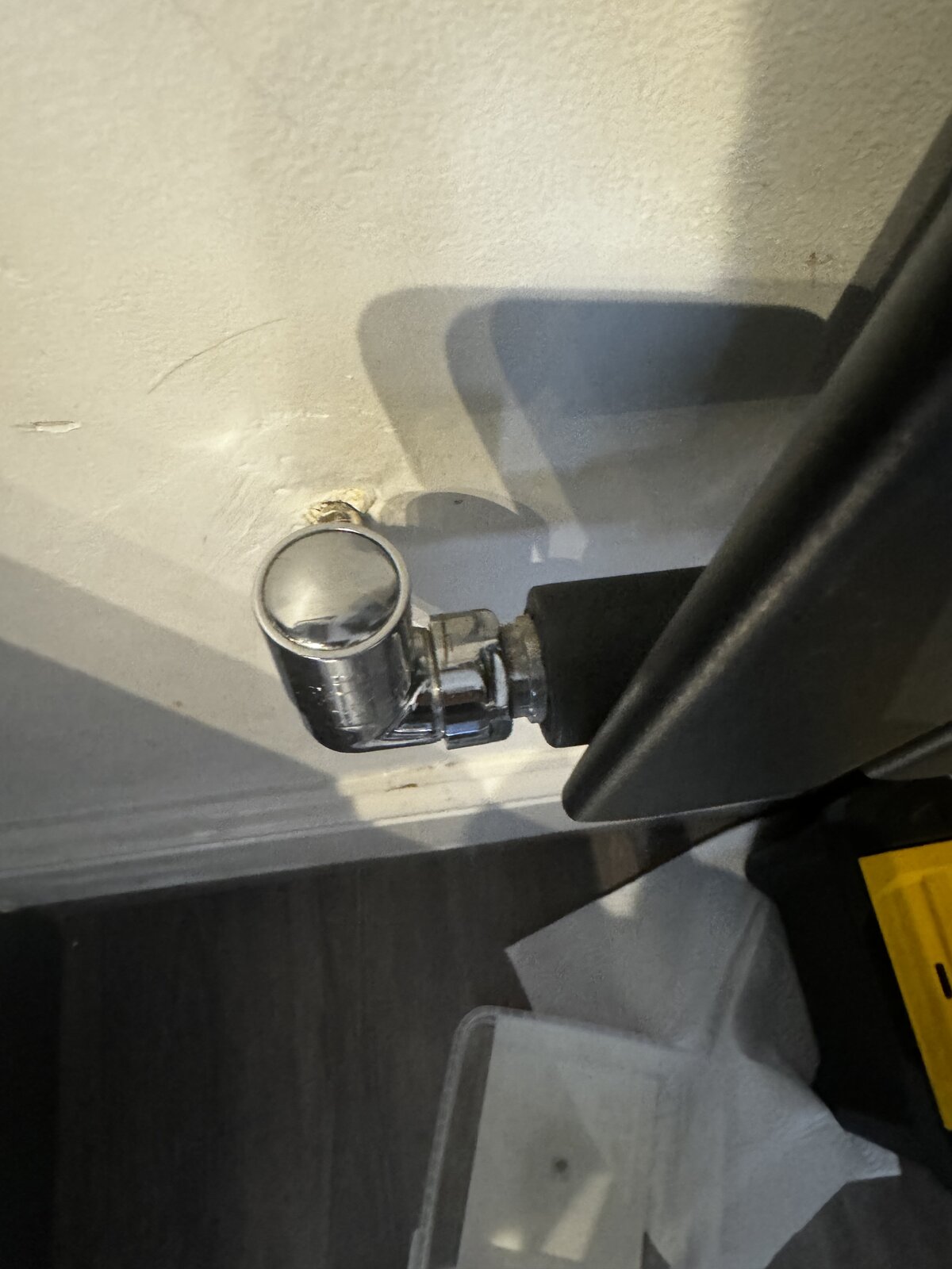

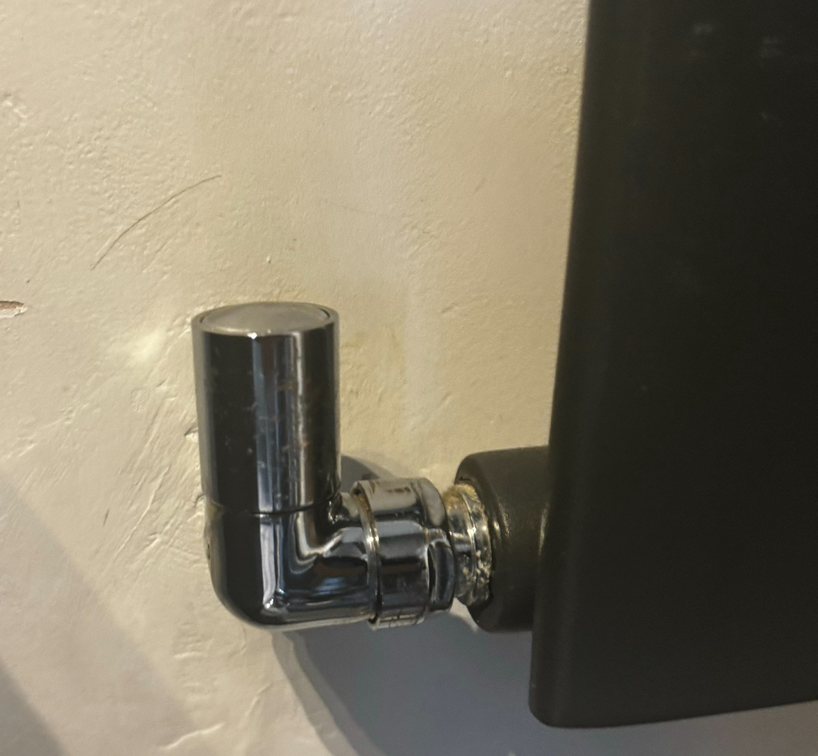

Hi Terry,
Sorry, the issue is I can’t seem to get the cover / cap off to see the valve underneath.
Other caps in the house are either a normal plastic one that lifts up or have a top screw to undo and lift it off, this has neither and doesn’t lift off ?

If the silver disc on the very top of the valve doesn't screw off ,or prise off ,then I suspect the whole thing will just pull upwards and off the valves spindle.
