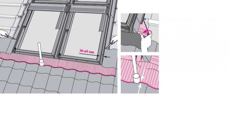

The leak is happening below where the apron is.
Had a 'builder' come down and said the water is going through / up the apron and leaking though. He put some solvent along the edge of the apron to stick it down, which has stopped the majority of the leak.
I've put plastic in the area which is still leaking:
According to Velux there windows / Apron is tested in an air tunnel to check to see if water goes up on windy days.
Also according to their manual the apron needs to be hammered down around the edges with a wooden hammer.
Any idea?
Looks like the pitch of the roofs not steep enough.
The wooden hammer is used to dress the lead into the profile of the tile! yours are flat.
The lead is actually some form of plastic, which I was asked to hammer down. The pitch of the roof is 15 degrees. It has been ok for the last 5 years.
