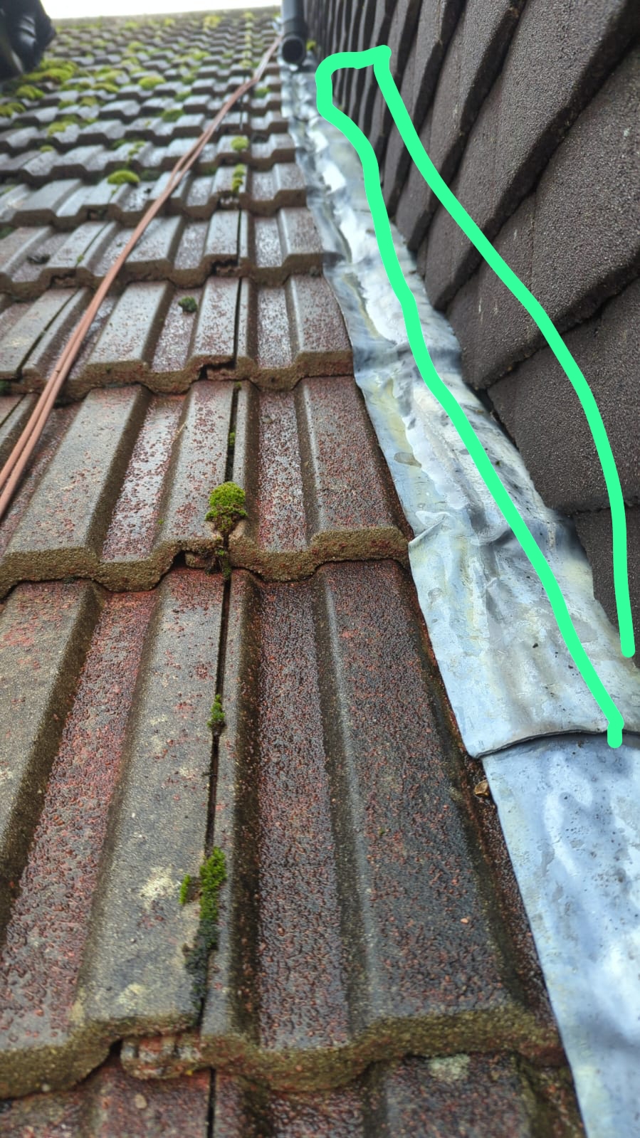

Hi all, first time poster but long time beneficiary of the advice given on here.
My roof has a leak which I have narrowed down to being an issue with the lead flashing between the pitched room and dormer cheek. I have been let down by three roofers now and been waiting 2 months, so considering tackling this myself.
Interested to get opinion on where you would start with this and what the best course of action is. Thanks

To add, using a hose I have confirmed the leak to be in the area with the green circle

Yours looks to me as if it has been incorrectly applied; the flashing should turn vertically upwards behind the vertical tiles for a few inches otherwise the rainwater will simply drain down the gap between those and the pitched roof. The flashing obviously should form a gutter to channel the water down and away but not allow it to run down the join between the vertical and roof tiles and enter the roof inside. Hard to make this out from the photo.
As suggested, you might have to remove some of the vertical tiles to see if the flashing has cracks in the corner, or does not turn up behind the tiles.

That drainpipe further up should be extended into the gutter below, in heavy rain that will be chucking loads of water down onto your flashing.

You have (bossed) profiled lead cover flashing over profiled tiles - thats correct.
However, does the cover flashing have a min 75mm upstand that goes up & under the wall hung plain tiles?
Also do the overlaps between lengths of cover flashing overlap at, say, 100mm - 150mm?
We dont know if the RWP is picking up a gutter and a dormer valley or is simply an outlet for a gutter only?
If its for a gutter only then the gutter falls and outlet can be re-arranged to drop near the front of the dormer - that re-arrangement would eliminate the rainwater flow down the cover flashing.
You could also look into pipe fixing clips for vertical hung tiles eg. Dreadnaught Tiles etc.
Using clips you could run the RWP along the cheek of the dormer above the cover flashing.
