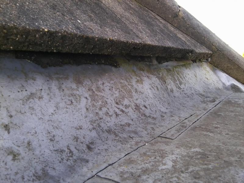

Hello DIYnot, I'm new to posting on this forum but I've used it's advice many times in sticky situations in the past.
My skills, I wouldn't say I was a "black belt" in DIY but maybe a "Silver" (I've got and use regularly nearly all power tools known to man and am not scared to go it alone).
But this one has me a little nervous.
I've been on my roof (standard two storey house) a couple of times (fixing up pigeon spikes on my ridge line and playing with my ariel) but now I have a leak at the back of my chimney in the "back apron" area. I've just been up there and taken a few pictures.
I've watched a few of the utube videos on making up your own lead apron.
But access is an issue, my ladder (6.1m) is a little "iffy" as I'm on the third from last rung just to get near it and have to reach precariously round the chimney to get up there.
Not sure weather to go for the diy repair or get someone in (never my preferred option).
I've seen quotes starting at £150 for these sorts of issues, do you recommend leaving it for someone else to break there neck, or given the picys, think it's an easy job were I to hire some sscaffolding or something?
Any advice greatly received.
Lee

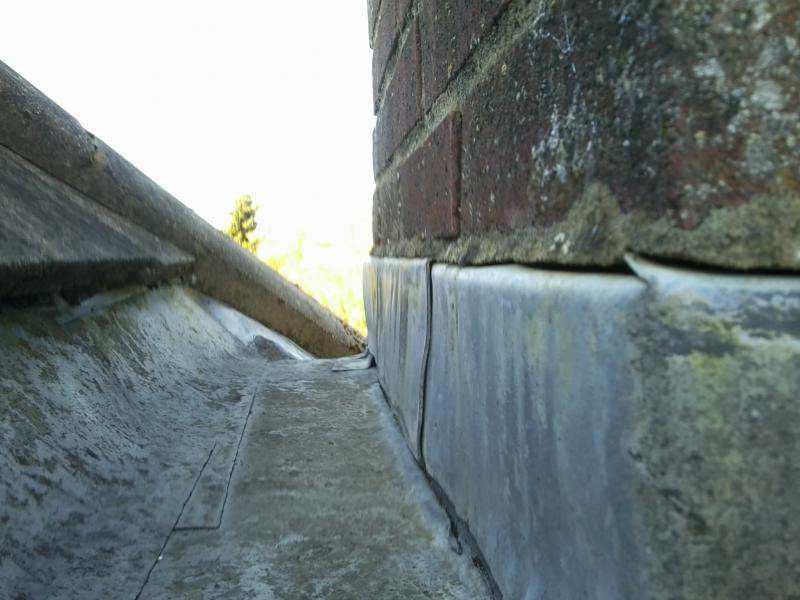

You, or someone else needs to determine what is actually wrong. There is some pointing missing, but apart from that its hard to say from the images
Then, is it a repair or a replacement?
If someone is going to do it for you, then they need to be experienced in leadwork, not just any old roofer. A new back gutter may need to be made down on the ground and welded at the side returns, and not have the crap beat out of it by a numpty roofer on the roof.
And if the back gutter has aged, then what about the rest of the lead at the same time
your pushing your luck with the ladder maxed out like that.
best plan of attack is get a new back gutter knocked up on the ground by a proffesional . Rip out the old one (looks iffy anyway) drop in the new, point the flashing in lead mastic rather than muck.. job done..live happily ever after..
repair= waste of time

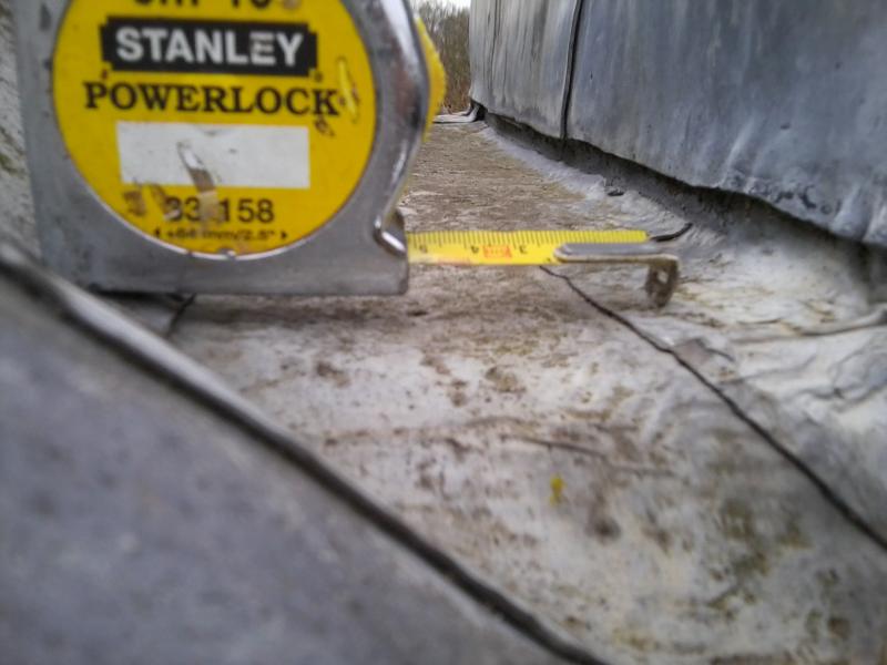

Just been back up there measuring the angle of the roof, the width of the chimney and depth of the horzontal flat bit.
I'll order it up and then think about how I get it up there.
Existing gutter looks like code 3 to me, your stack needs pointing as well. You're off your head on that ladder. Get someone in to do the stack and the lead. Be the best 3-400 quid you'll ever spend.
We only install code 8 now........
Want to walk away from a job knowing I'll never be called back.......
I'm only 31 ;)
Looking at that video again, I think I must be a little, "anti-risk averse".
Company I've approached to make the gutter is doing it in code 4, haven't properly ordered it yet (not paid, £89 inc delivery). Do you think I should ask for it in code 8? Or...
hardmetalking, I notice your in Cambridgeshire, not far from me (Milton Keynes), are you interested in the job? (not sure if am aloud to ask that on this forum)
Code 8 is ridiculous for this installation. It will cost you twice as much and add unnecessary weight to your roof.
The Lead Sheet Association recommend code 4 or 5 for a backgutter and if fitted correctly will last a lifetime.
I recommend you get a qualified leadworker to carry out this work on site, not order one off the internet as there is too much room for error on your part and they will not refund you if you get any measurement or degrees incorrect.
The step flashing needs re-doing and soakers installing to by the way.
