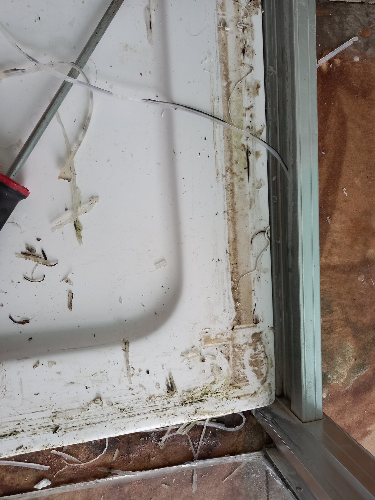

I'm after some tips & ideas on how to resolve this please.
Built the shower cubicle of studwork, hardi-backer & 6" square tiles; single cold water supply inside of the studding, exiting to a 10.5kw electric shower; shallow tray sits on 22mm chipboard on the joists. Waste runs between joists and out.
The whole lot has been up for approx 8 yrs and until recently, apart from a few hiccups, everything has been fine. I now have a leak and I'll be bug**ed if I can work out where it is coming from.
The 'leak' appears below the tray in the corner, bottom right of where the shower unit sits. It is not coming from under the glass. It is adjacent to the bathroom door and there is water present in the doorway floor also. It is getting quite soaked and is starting to rot the adjacent boards.

The tray-to-tile seal, specifically the bit that then gets hidden by the enclosure profile, is the key. I’ve even had it where the sharp corner of the enclosure when fitted, punctures the silicone. It’s a faff to sort out though as you need to remove the enclosure.
The enclosure shouldn’t be sealed to the tray on the inside base, only on the outside.

As above, likely to be the tray to tile seal behind the vertical profile. You can't seal this again without removing the door/enclosure as there is no way to access it with the enclosure in place.
The base, between enclosure and tray, is the bit that deffo shouldn’t be sealed on the inside, otherwise it’ll trap water. Up the sides is ok but not the base. So yeah that may be the issue if you’re confident the rest is ok

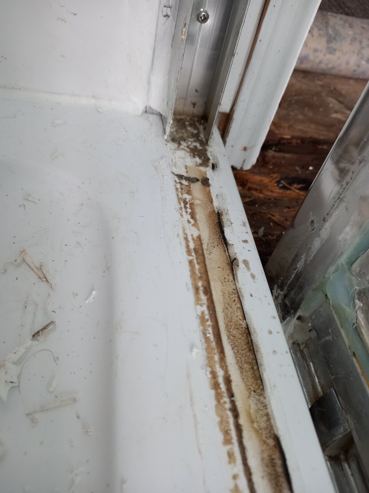

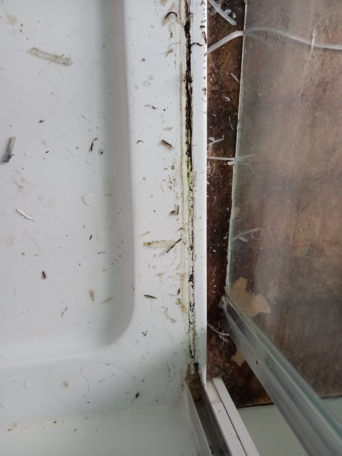

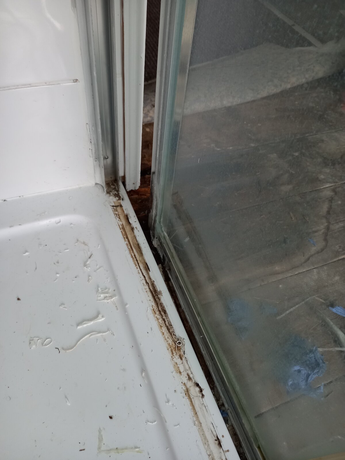

Well, I've taken the bold step to remove the enclosure. I now see why we seal on the outside only (see pics)

Most importantly, the silicone bead should be continuous behind the enclosure, you can see it stops on the inside. So you really need to either remove the side profiles too and seal properly behind, or try and seal it as-is. Then once refitted, seal outside only.

It’s already been covered, but in my old house I got over excited with the silicone and sealed both inside and outside of where the vertical wall profile channel met the glass. Got a leak in the corner I couldn’t work out. Read that you should only seal outside. Basically water whilst showering was filling up this profile and then leaking out where it could. Sod’s law outside the enclosure. If I hadn’t sealed inside, the path of least resistance would have been back into the tray and down the drain.
