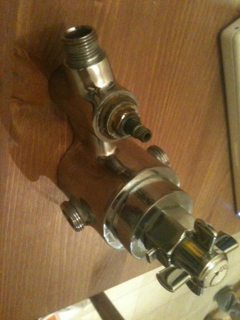

I have recently bought a second hand shower mixer unit (pictured). When connected the unit leaks from the water outlet (as if it where going to the shower head but not connected).
Its as if you can't fully turn off the water via the on/off lever.
Any ideas if this is fixable? A new cartridge?
Not even sure who makes this mixer, any clues?
Cheers olly

Yeah i know its not the best thing to do, but is it possible to fix it?
What do you think is wrong with it?
The top splined shaft is the flow on/off, it will most likely have a 'regular' sytle tap headgear in there either washered or ceramic disc. This alone controls water to the shower head.
See if you can remove it and then post a pic.

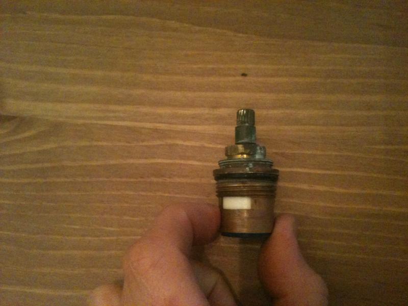

Its certainly a ceramic cartridge, best bet is to go to B&Q tomorrow and see if you can match one up, they have various sizes regarding the splined shaft (8,10,12) etc. The thread will be 1/2" BSP or 3/4" BSP
You'll have to buy two though, or see if a plumbers merchant has any, mine never do as there are two many sizes to keep in stock.
http://www.notjusttaps.co.uk/range-replacement-tap-valves-cartridges.htm
